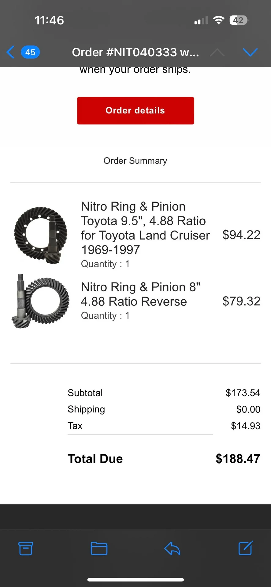

You get what you pay for with Nitro 🤷‍♂️
Not worth it to cut corners on something as critical as diff gear !
JMHO
JMHO
My 80 axles came in the last unit and were loaded with Nitro 4.88 gears. You know that I broke the fronts but that was my fault. The front now has Sierra Gears. The rear Nitro’s have put up with me and are still good to go.
My problem with Nitro equipment is the lack of customer service. I called JustDifferentials several times and emailed when I broke the front diff last fall and got zero response. I think they can kiss my business goodbye.
Nitro started out as a good company and had quality stuff
Then they were sold and they went to s***.
Steve your gear sets may have be the old stuff but I know you had issues with your axles as I did
It’s well documented the issues with their gears.
Yes, the 4140 moly shafts. I toasted a couple. I forgot about that.
