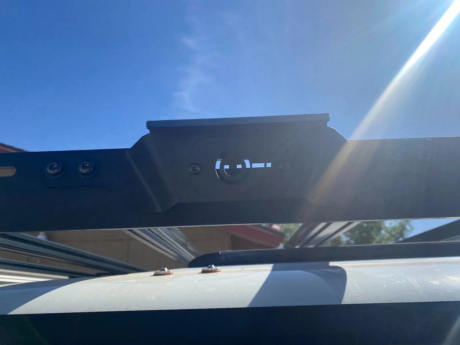

Did you ever discover the rib thread size depth question? I may have missed it. I’m loving your build. Especially the home fab tools and technique. 👍
Can confirm that the threads for the ribs are identical to the roof rack mounts (M5 x .8). The 12mm long, ultrawide head, bolt should work just fine there.
Part to order from McMaster P/N: 95608A123. I have a bunch of extra washers from the pack I ordered if you want a set, shoot me a PM with your address I can mail them to you. I wish they were a bit stiffer, but as long as you used some RTV + don't over torque and smash them, they seem to be working great.

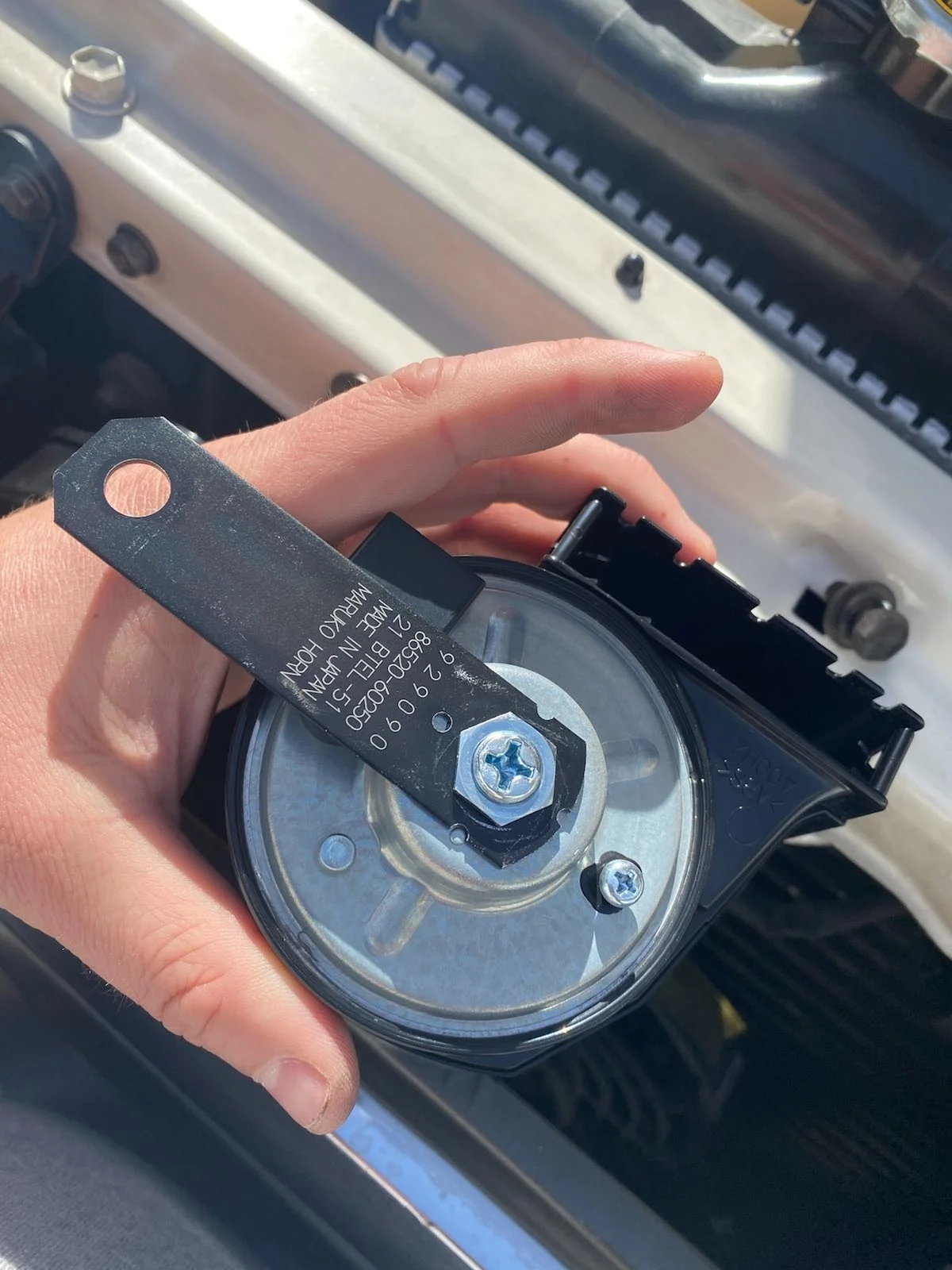

New horns are installed. No more sounding like a 90's camry. These are the high and low out of a 4runner (I forget the year) but they bolt right in, no modifications needed to electrical.
You'll need one of each of these (two horns total) one is high pitch, one is low pitch (i don't recall which P/N is which)
P/N: 86510-60300 QTY 1
P/N: 86520-60250 QTY 1

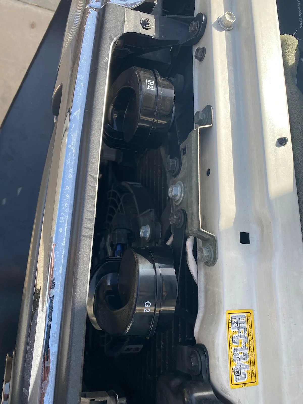

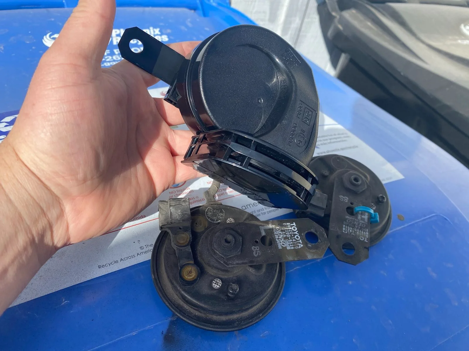

You will need to loosen the 14mm jam nut on the back of each horn, rotate one mounting bracket 90 degrees clockwise and rotate the mounting bracket on the other horn 90 degrees counter clockwise. 12mm socket to remove the two horns, pull the plugs, plug in the new horns, bolts them in.
Horn and mounting bracket, pretty neat that it has a notch at 90 degrees and boss to capture the bracket while tightening:
Old little horns vs new big horns:
All mounted up:
All mounted up:
Such an inexpensive but majorly worthwhile mod.

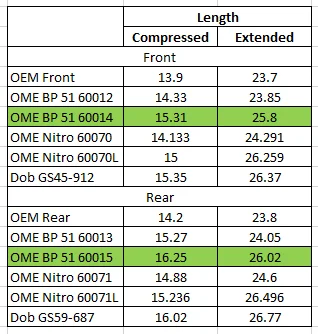

I need to decide on rubber and shocks:
- Planning on the OME BP-51's. I hear they last a ton longer between rebuilds than Radflo's and they are a true bypass shock, 2 way adjustable. Specifically, the longer variants to go with the flexi springs:
-This is the major point I am debating...BFG KM3's, just not sure if I should go 35x12.5... or 37x12.5 and drop my bump stops further

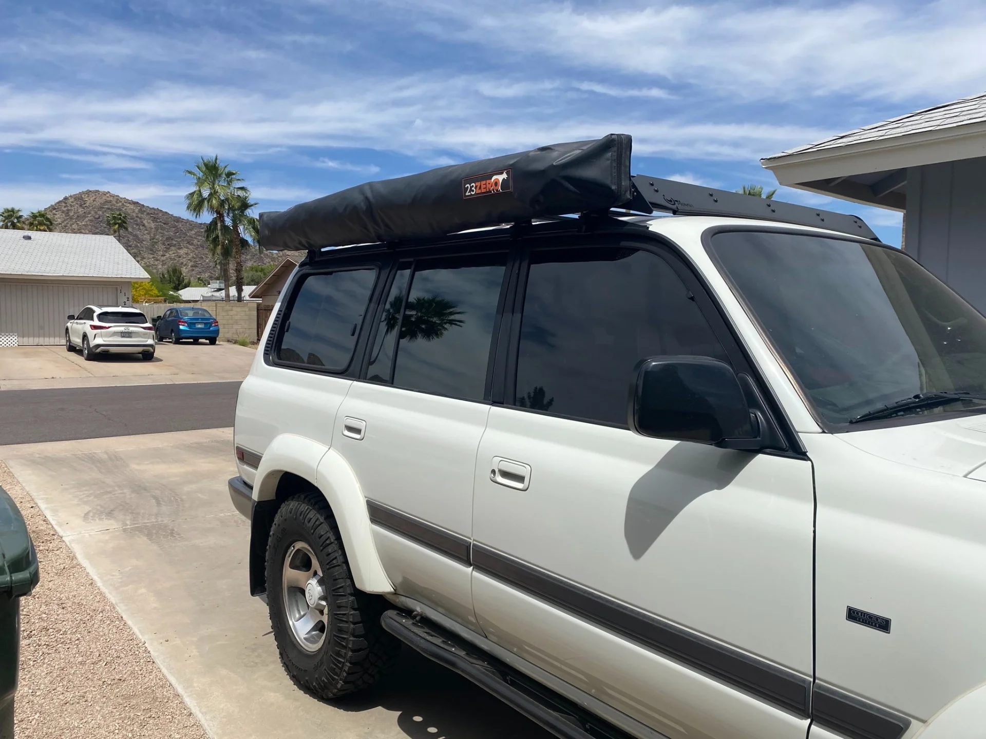

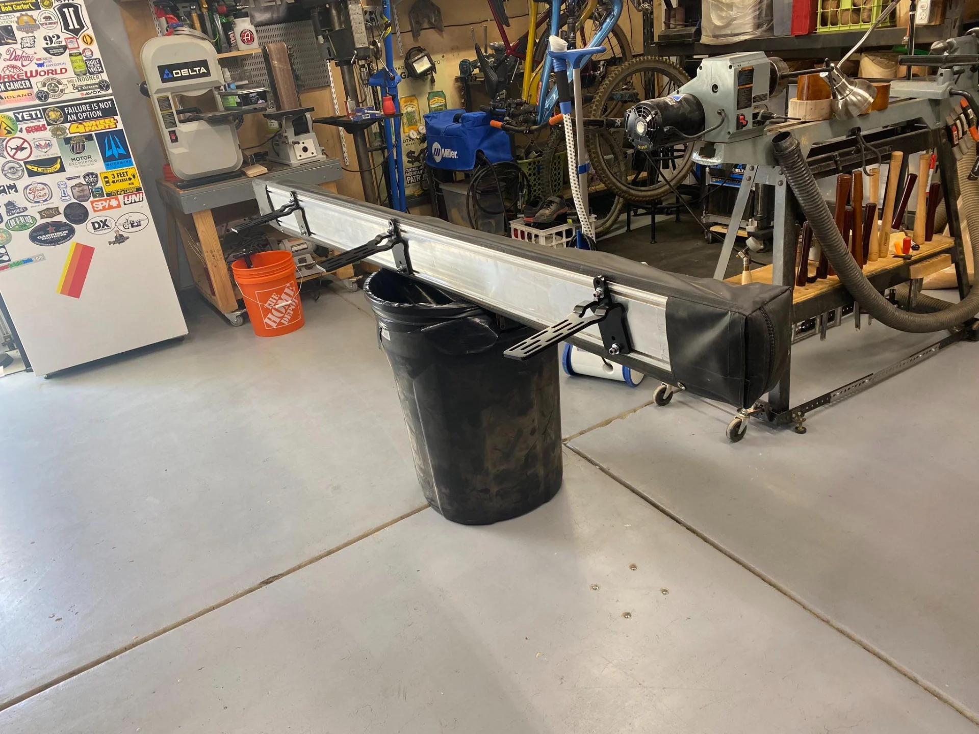

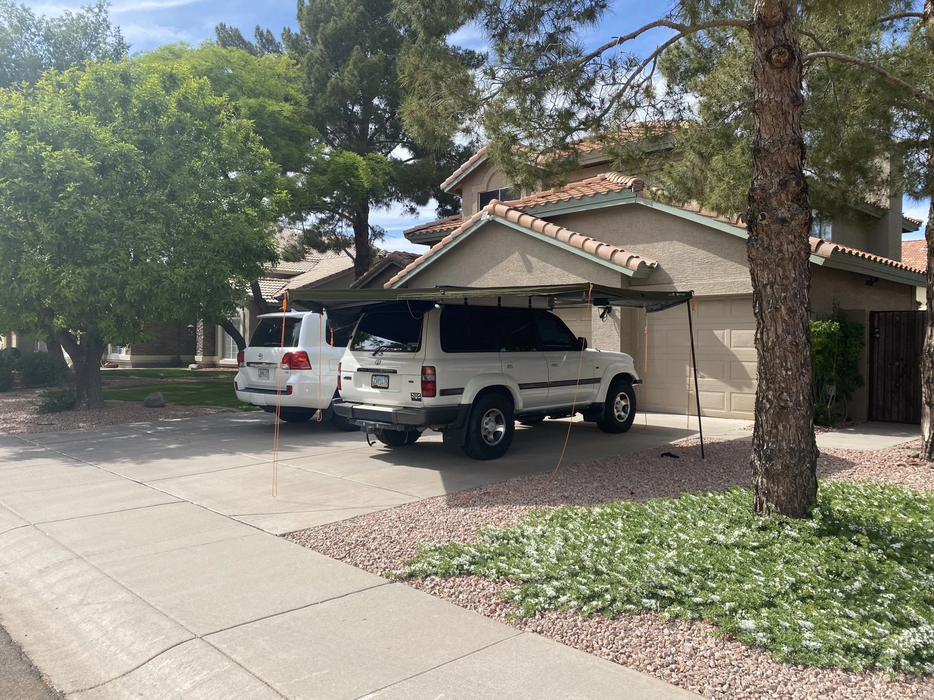

23zero Peregrine installed today:

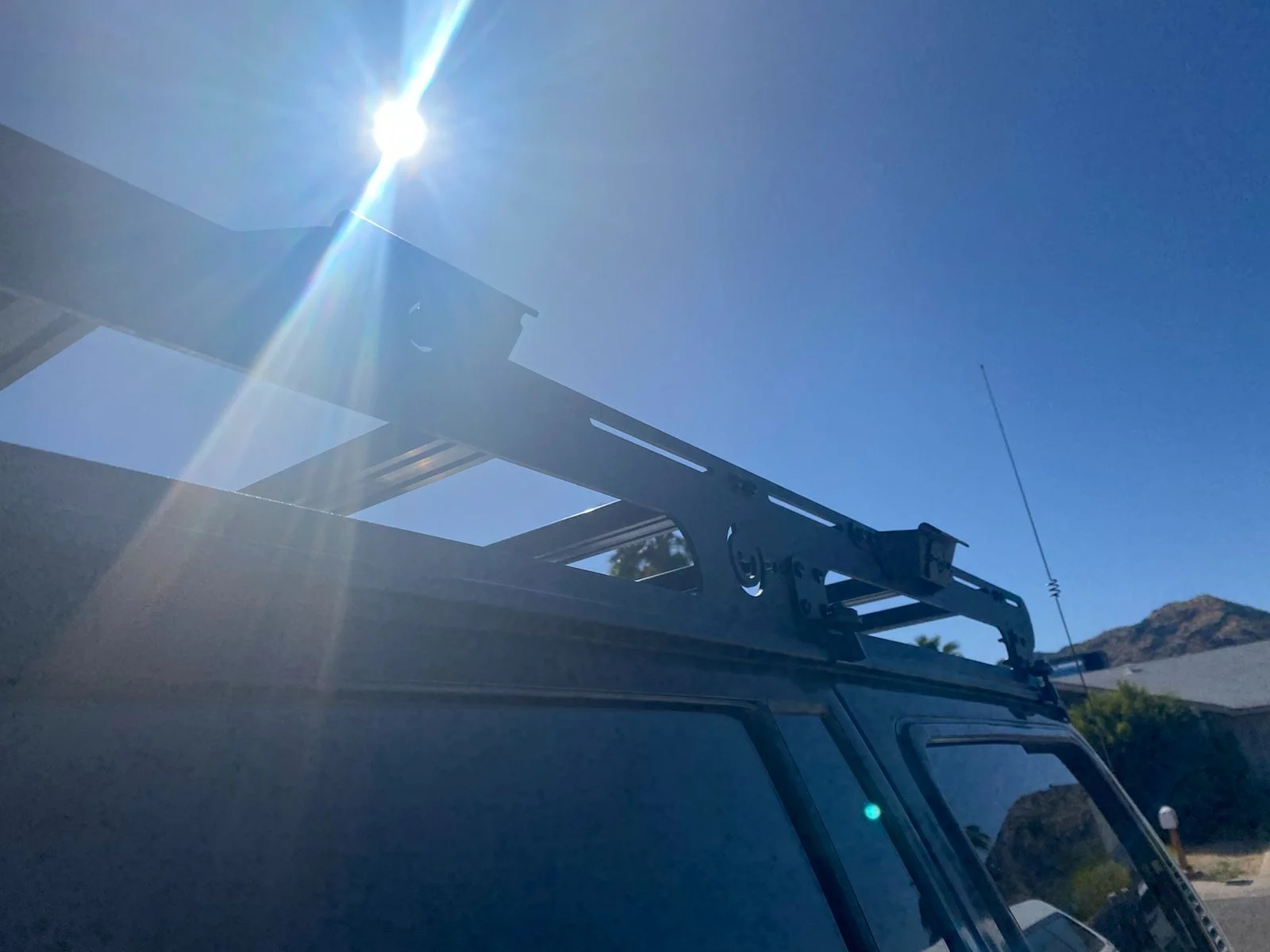

The prinsu mounting brackets will not work with a 270 awning. These are the 23Zero brackets, installed them with qty(6) 1/4-20x1" stainless carriage bolts (2 per bracket). Should do the trick. Not an easy thing to install solo. Likely need to push it back a bit, but we will see.
Summit Raptors also showed up, I think FedEx and UPS are starting to hate me. I got 5 total, these are the 17x9-12 (4.5" back spacing):

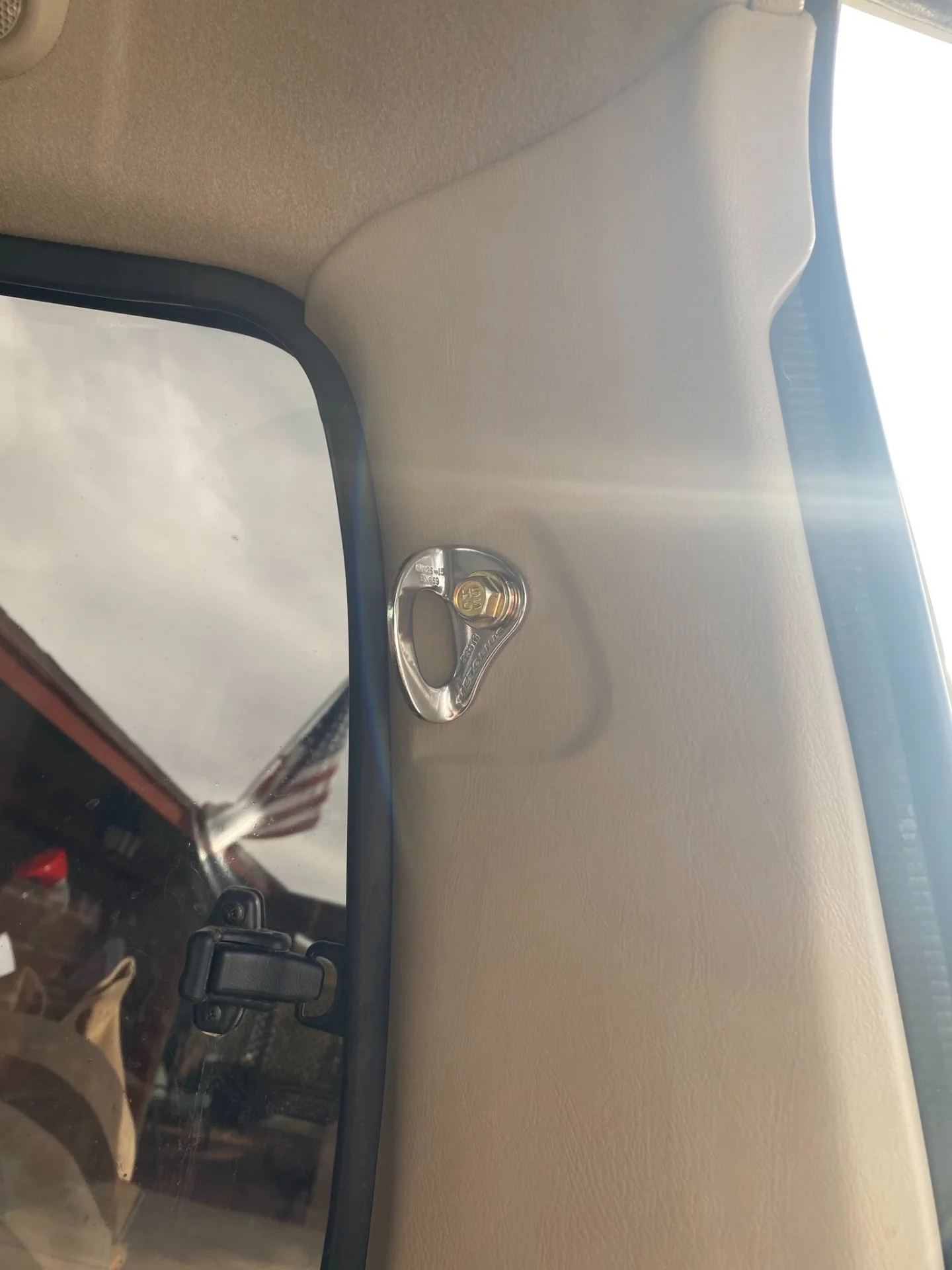

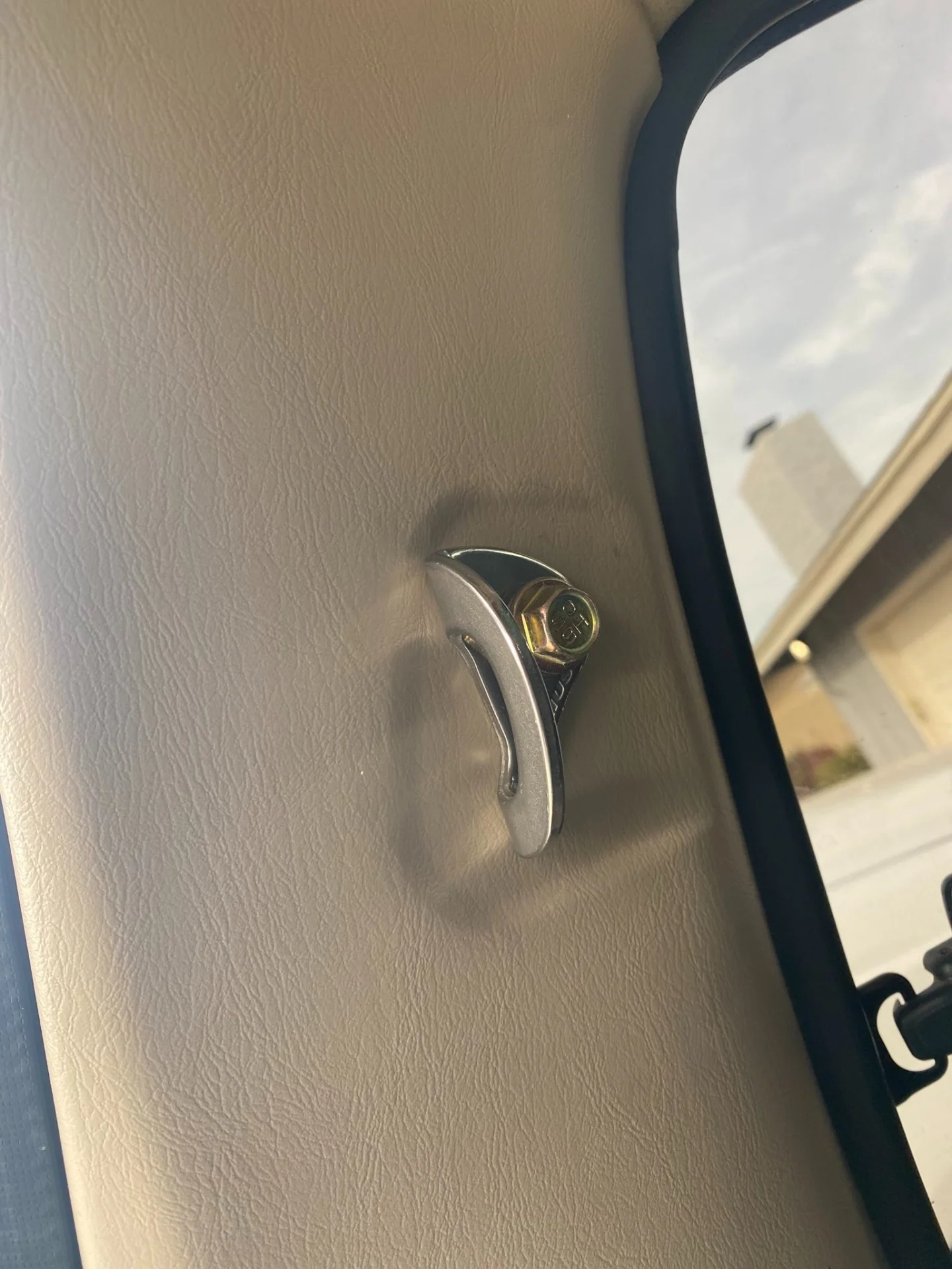

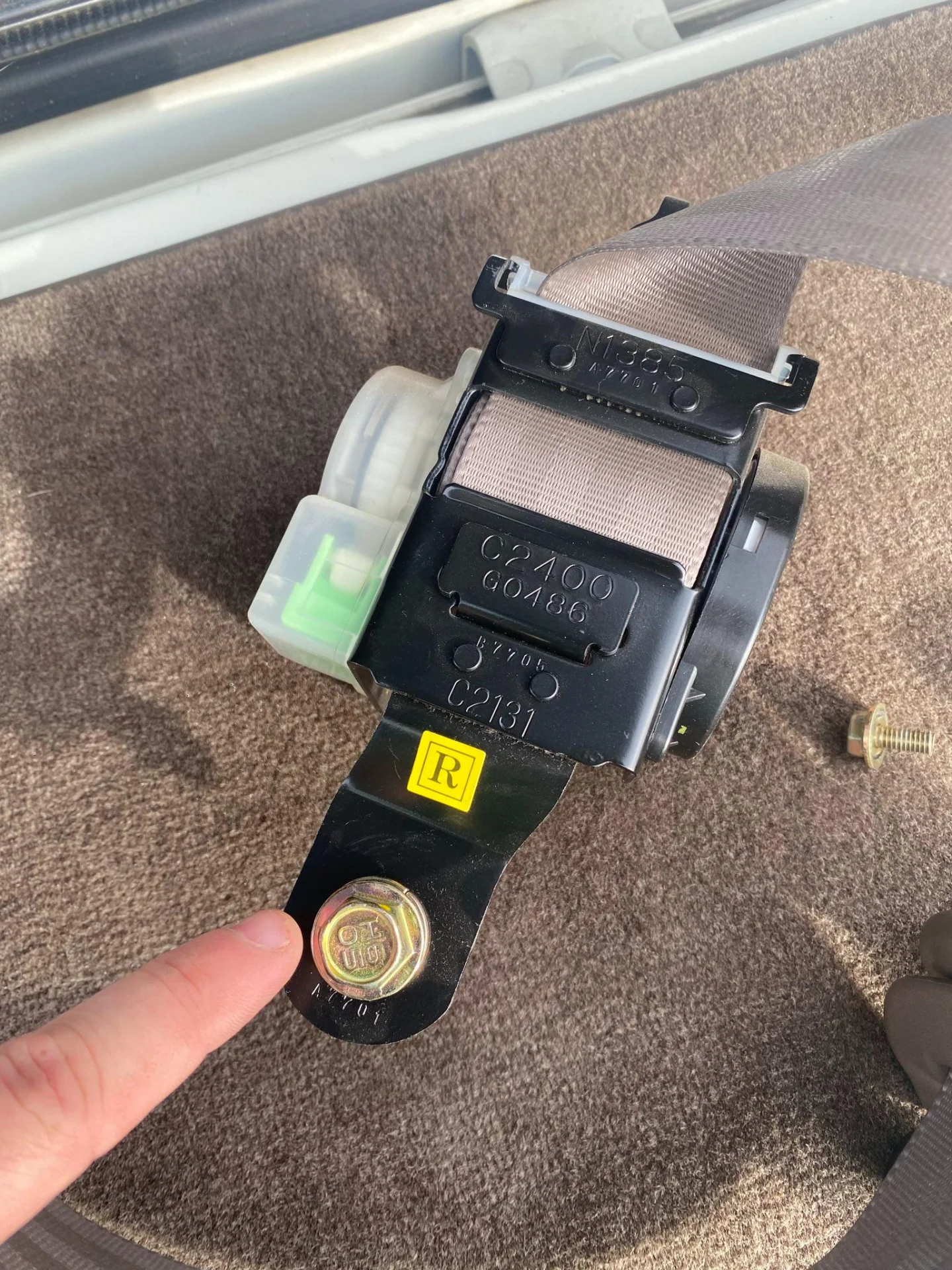

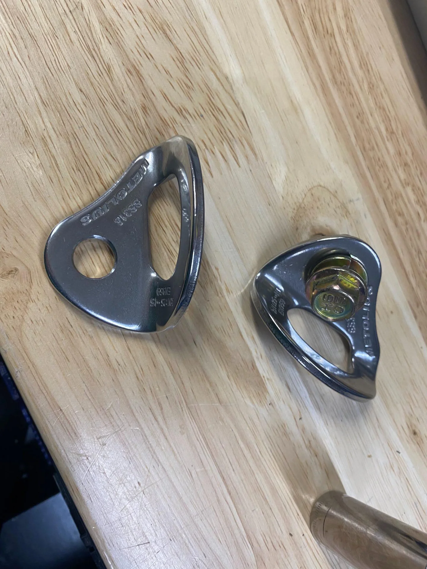

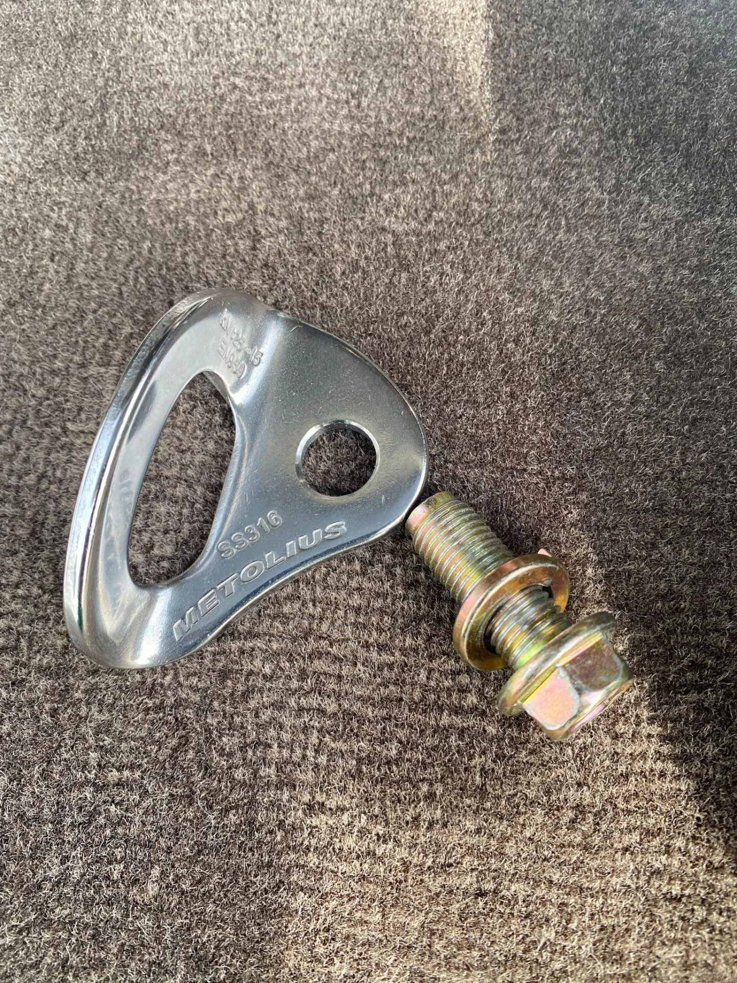

Since my 3rd row seat belts are out, thought it would be cool to fill the pulley hole with something useful. Grabbed two Metolious bolt hangers (these are for climbing anchors) and opened up the mounting hole to accept the bolt from the seat belt retractor. I'm not sure what I'll use them for, but I think it's kind of neat, especially if you are a climber :)
1. Order anchor of your choice... tons of options out there, go cheap. I tacked these onto a back country order and they were a few bucks each
2. Open op the hole to 15/32's (this is tough stuff, use some coolant like wd40), then chamfer the sharp edges.
3. Remove your rear seat belt, retain the retractor mechanism bolt and lock washer.
4. Bolt the hanger to the top hole with that bolt :)
It’s obviously for hanging the little tree air freshener. :flipoff2:
