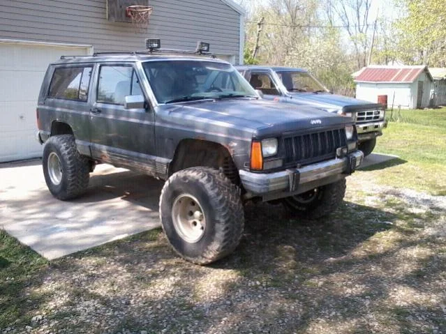

I looked everywhere for a yota for her but found a jeep see the thing was she cant drive a stick so had to be auto not a bad rig got 33 6inch lift lights runs good I dont know that much about jeeps whats first things I shoud check besides motor I got that
I would check the unibody for stress cracks. If there are a few, buy some unibody stiffeners and weld them on.
