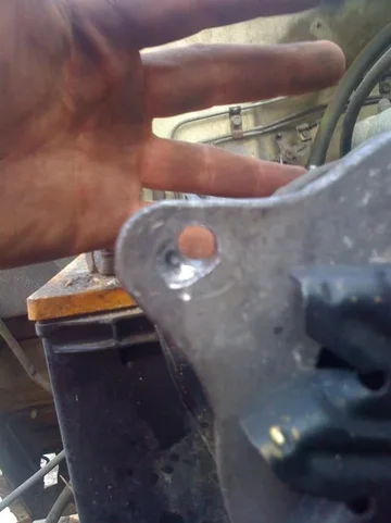

Trying to get my broken bolt And broken easy out. I went through a full set of bits to make a new hole and ran a nice stage 8 nut and bolt. This probably took two hours because of the easyout. Lesson learned prior to reading all of the info on MUd about not using these.

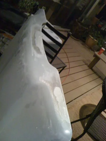

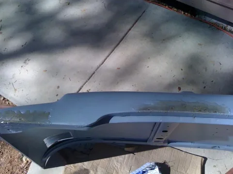

Hood was in good shape but had some pinholes on the front, all smaller than 1cm. I decided to fiberglass this.
Now read for primer.

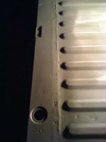

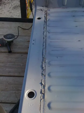

Next was the rear of the bed. The floor was peeling up something nasty. I gently cut away the bad metal, welded everything up and sealed it. I wilm come back and pretty things up before paint. The welds were pretty nasty because the MIG had the wrong size guide for the wire feed and it kept jumping out. :meh:
