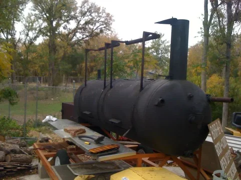

Here are some non cruiser pics from my dads celebration of life. He was an award winning brisket cooker. I hope I did him proud with the 60 pounds of meat I smoked for his shindig. This is how we do it in Texas. Meat so good you don't need sauce. Also his smoker; another thing that will never be sold. :cheers:
