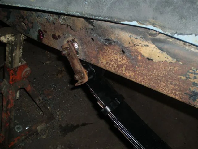

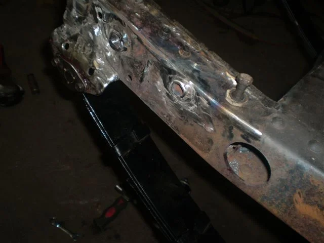

1 st pic is showing the SO finished and the cleaned and painted springs hung, note the shackle sunk into the rear of the frame

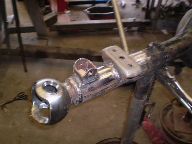

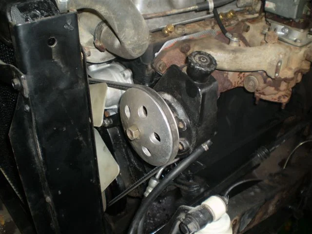

2nd pic shows the Saginaw steering box mount, this is 3/8'' steel,

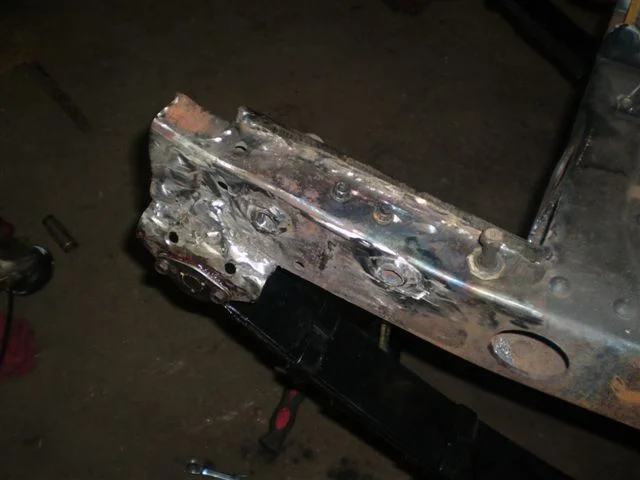

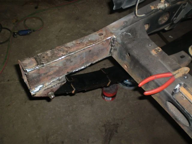

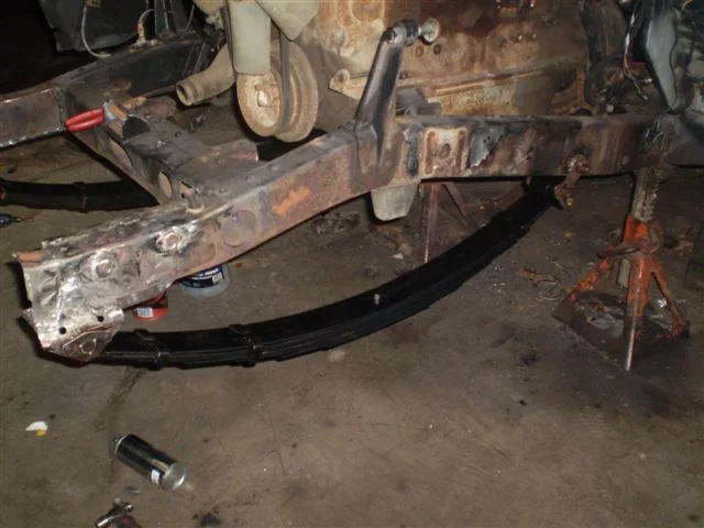

3rd pic is showing the passenger side, SOP is plating the inside of this frame rail also...

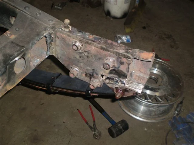

1 Close view of the rear shackle
2 and 3 View of the outside of the frame on the gearbox side, the two bolts that go thru the frame are sleeved to prevent the frame from collapsing .

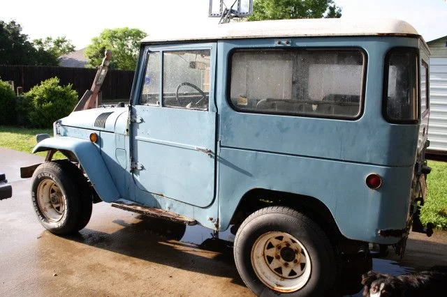

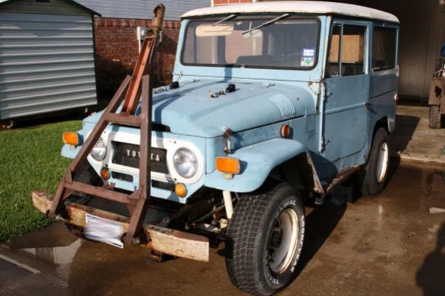

Here are shots before it went to Butch.

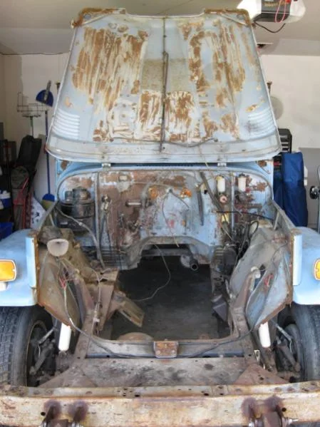

As I bought it.

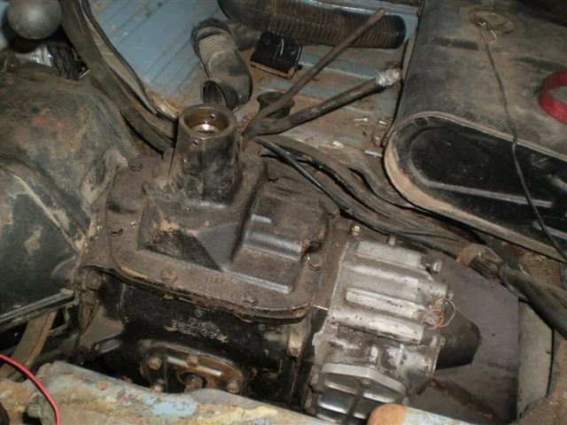

After I pulled the 1F.

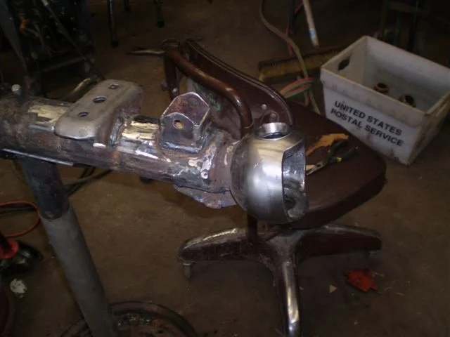

GOt the axle cut and turned, shock mounts on and lower ball braces in place, got to make some steering stops and the upper ball brace, then finish assembly,

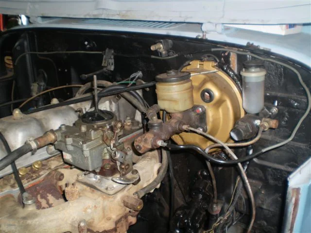

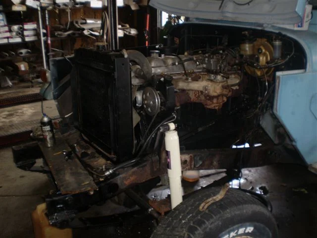

Progress report, got it setting on the SO, engine wired and running, PS finished, Power brake booster on, etc.....
:D:D:D:D
First pic shows the lower end of the FJ55 column, it comes with a u joint and lower bearing......
Second pic, this Rochester carb came with the truck, it was here and it works great.....
Third pic shows the poer brake booster, this truck di not come with 'em
Pertronix ignition system from Mark the hippy foolproof............
SM420 with twin sticks.

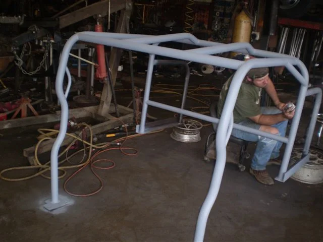

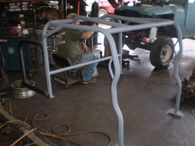

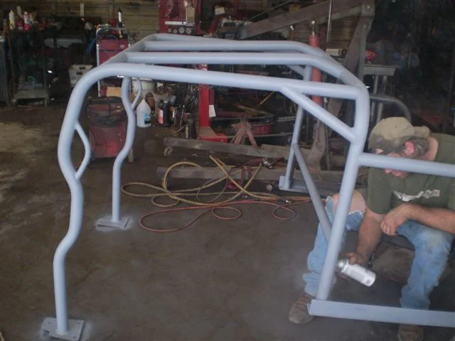

Josh came in a worked his magic........it's primed, shoot black in the morning
That is a work of art. Can't wait to see it mounted up.

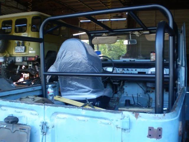

cage question
Butch,
Would that roll cage (I assume Metal Tech??) fit in a FJ40 with the hard top on without modifying the hardtop or its mounting?
And, its sounding like you are getting closer to completion... then you would have some room to work on my Toy...
Hard top fits fine with that cage. I've got the same cage.

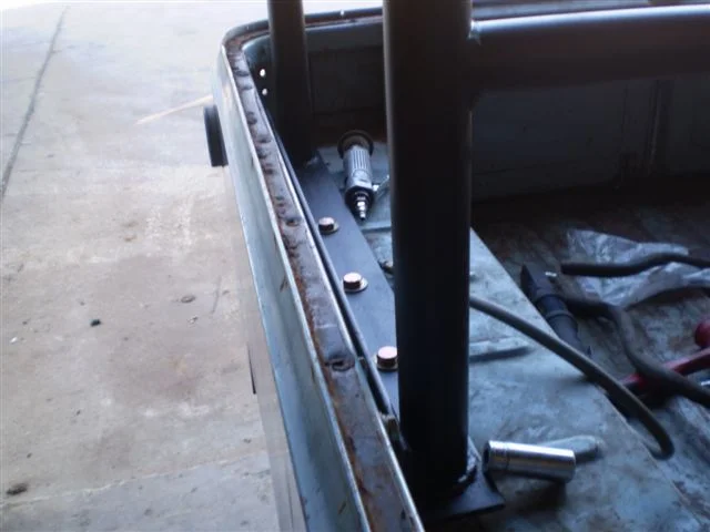

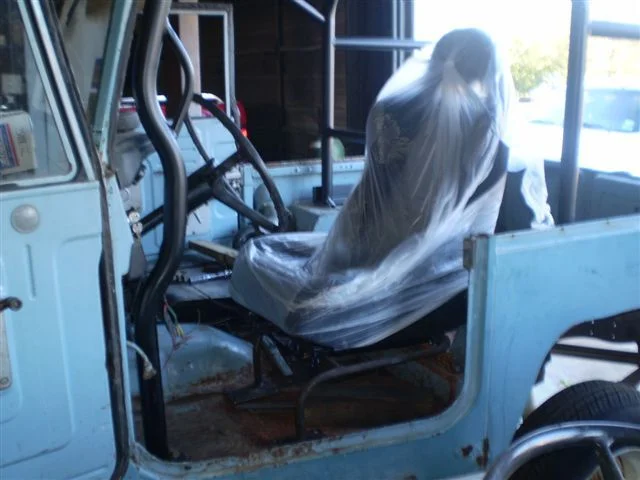

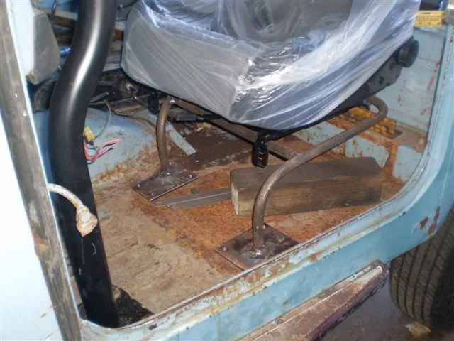

Josh got a lot done today............cage painted and installed, drivers side seat almost mounted........
