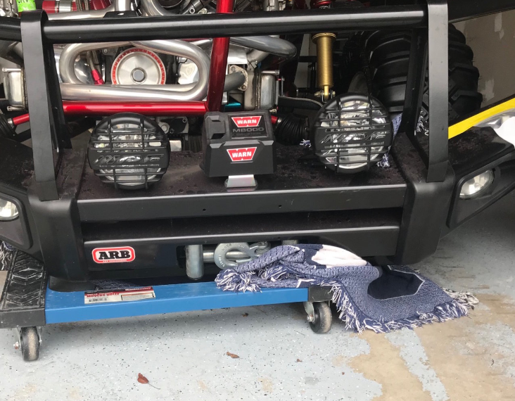

My guess is the tab (for lights?) on the ARB bumper is the reason for relocating. Appears to be plenty of cable length.
Curious on the tower. Sounds like I may need one.

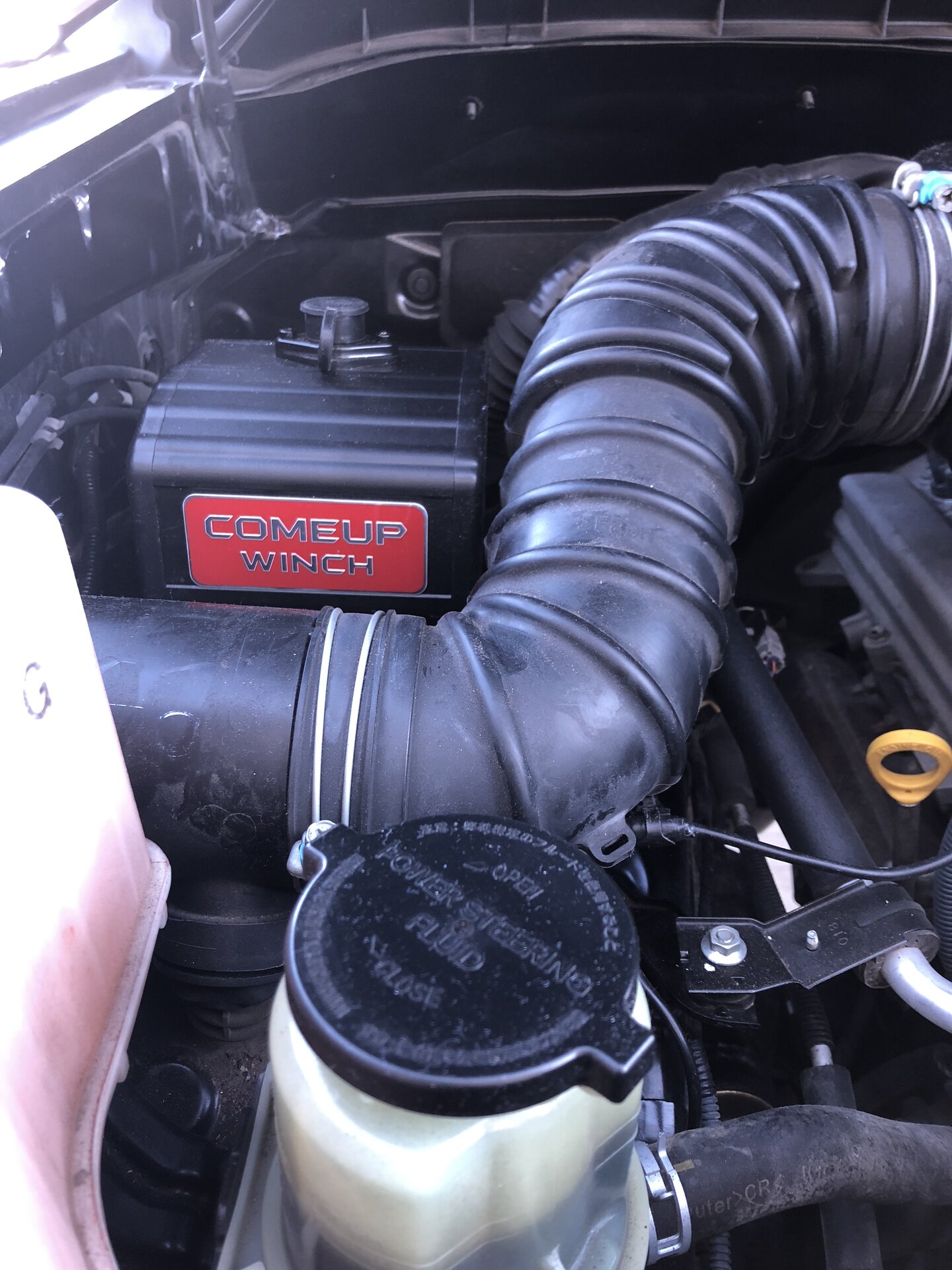

We have this U-Type bracket for our control box
Wonder if this u-bracket from @COMEUP could be modified (via the handy cutoff wheel and spray paint, of course!) to bolt in between the battery and core support like others have done. You'd have to chop off the portion at the 45deg angle leaving only the 90deg option, but using one of the two holes across the top, catching the bolt hole on the rad support, and then using the 4 mounting holes on the bracket for the control box landing it down between the battery and core support might be a good solution. 🤔
Also wondering if additional length is needed on the factory control box wiring or if it'll reach...some of the manufacturers offer 'relocation' kits which are simply pre-assembled kits with longer leads providing flexibility in the box mounting location....albeit they're a little pricey, but plug-and-play. I haven't gone to the efforts of pulling it off and mocking it up just yet, so not sure if factory leads will work or not.
Pics below stolen from @I Lean and @LC4LIFE 's thread.
That seems like a awful spot to mount that unless you get the adapter to run a remote . I would hate to have to open my hood to use my winch

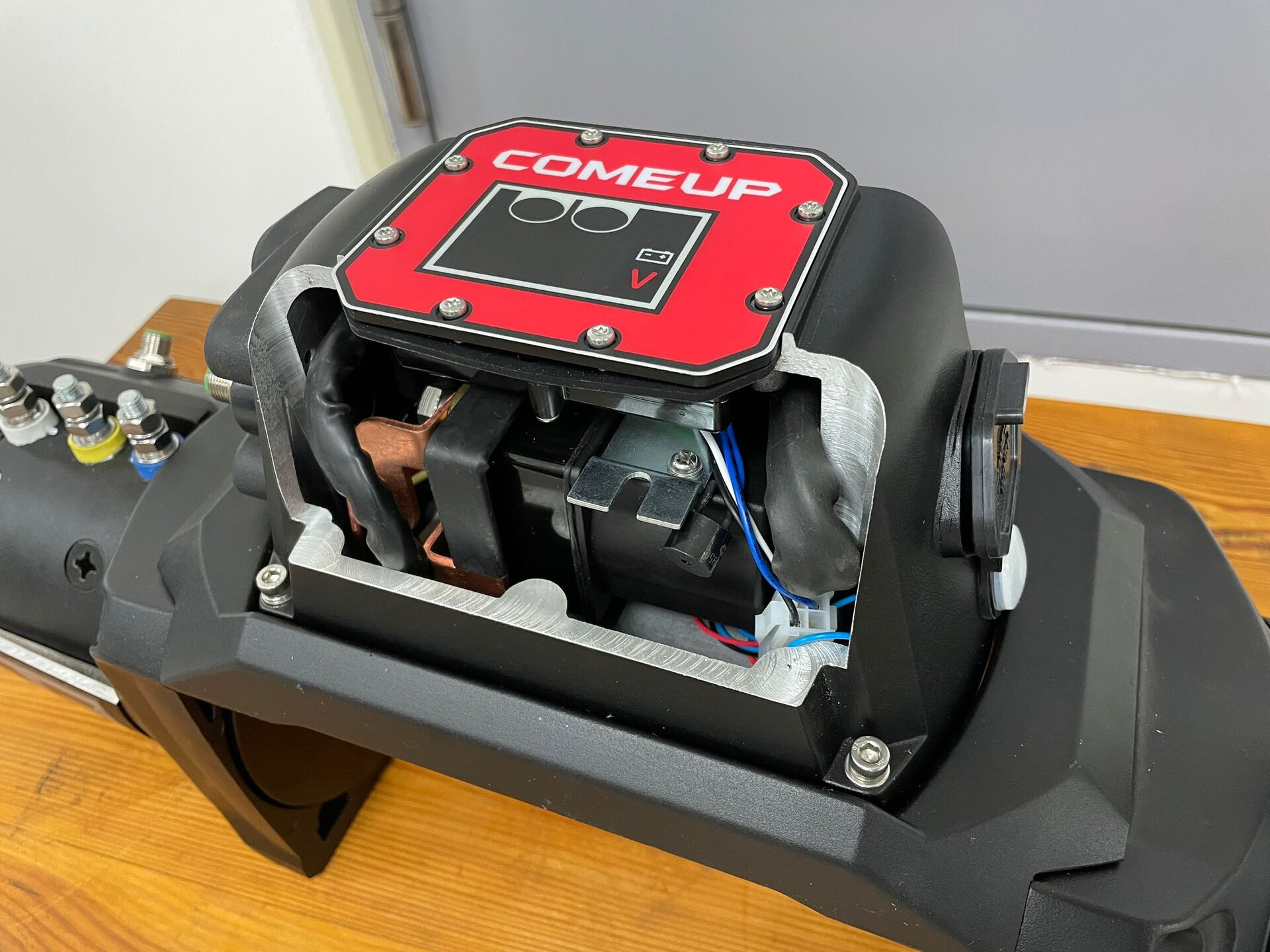

Hey everyone. I just wanted to post up and introduce myself. I am the Sales Manager for Comeup Winch here in the US for the recreational side of the business. This year we released our new SOLO winch, and I just wanted to post up some pics, and answer any questions you might have. This is our new integrated winch that comes in a 9.5 or 12.5 capacity, and as you can see from the photos we have designed the winch to be very efficient at keeping as cool as possible while winching. The thick aluminum housings on the motor, the control box, and the clutch/brake assembly help dissipate the heat. The winches come with both a wireless and cord remote to suit your preference. There is a digital display on top that will give you the voltage of your charging system, a thermal warning system if the winch gets too hot, and if there are any errors in the in the electrical system.
We offer two relocation kits for those of you running an ARB bar, or similar style bumper where the integrated control box will not fit. Both the clutch, and motor are clockable to ensure a painless install.
Comeup is a family-owned business that has been making winches and hoists since 1975.

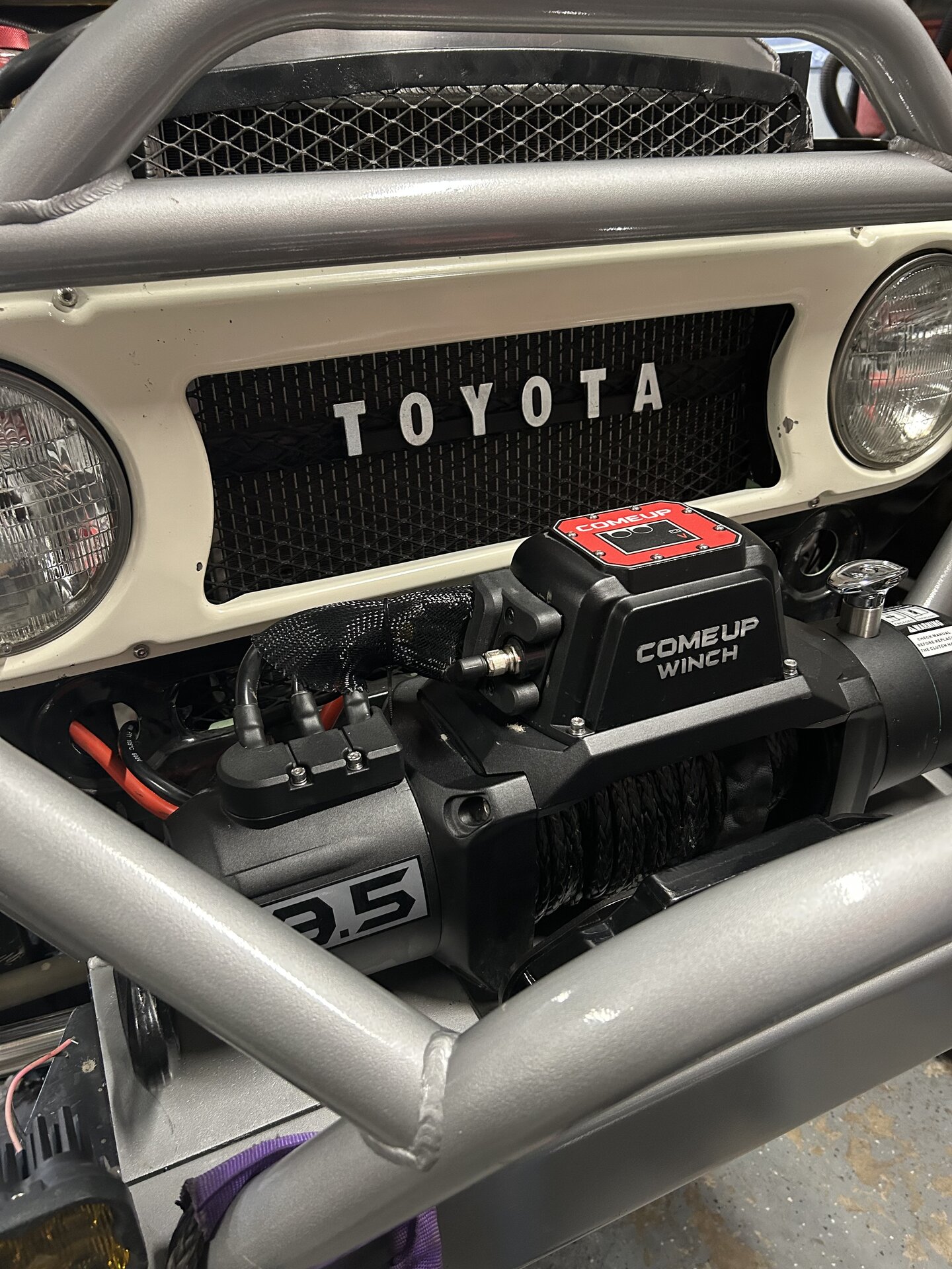

Here are a few of mine . The 3rd pic you can see that I mounted the control box on my fender well .
