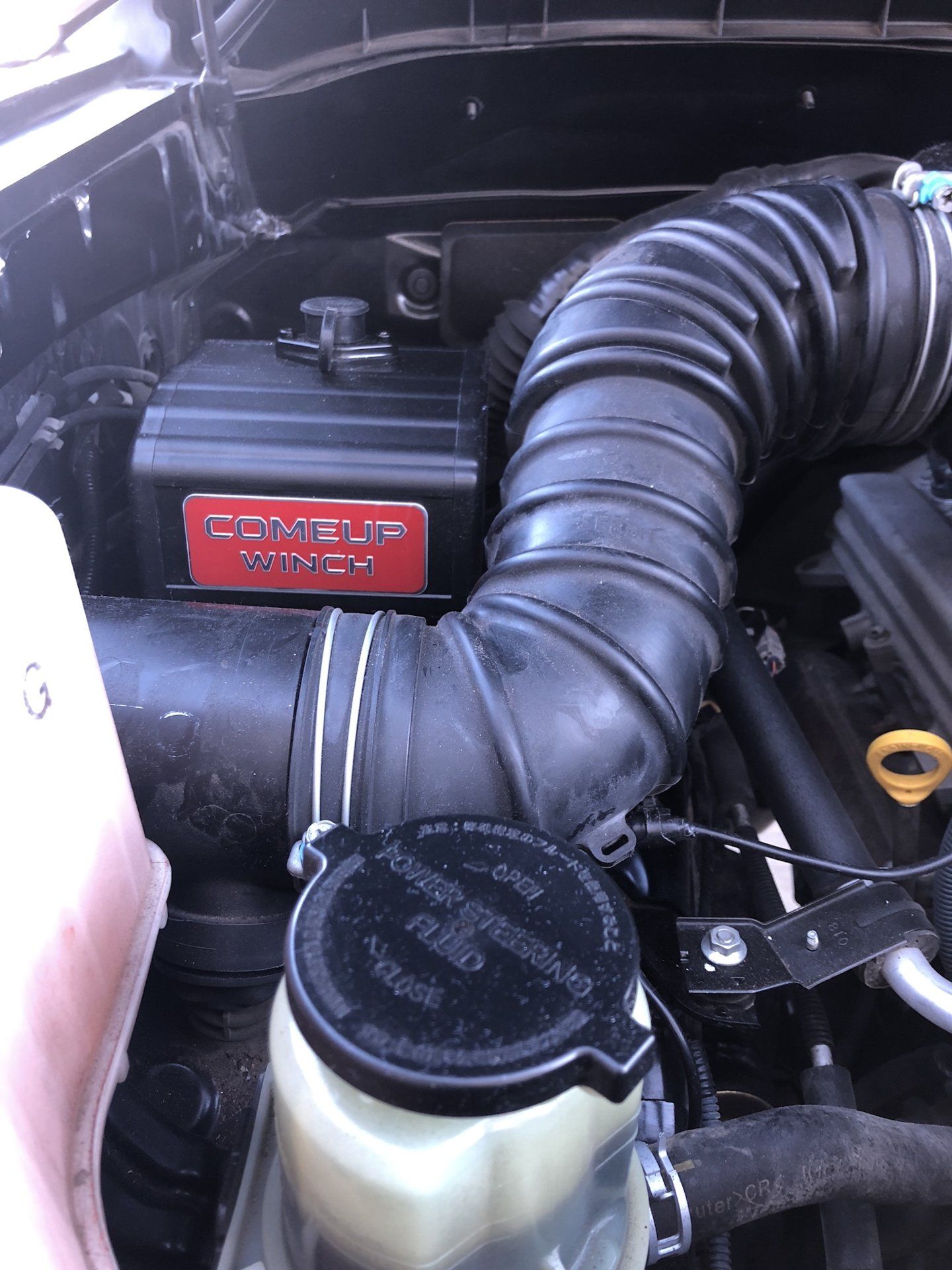

Do comeup make a solenoid relocation kit ?
I'd prefer to mount the box under the hood if possible.
I'm not aware of a "kit" offered by ComeUp. But the bracket that comes with the solenoid box could pretty easily be bolted under the hood if you have room for it.

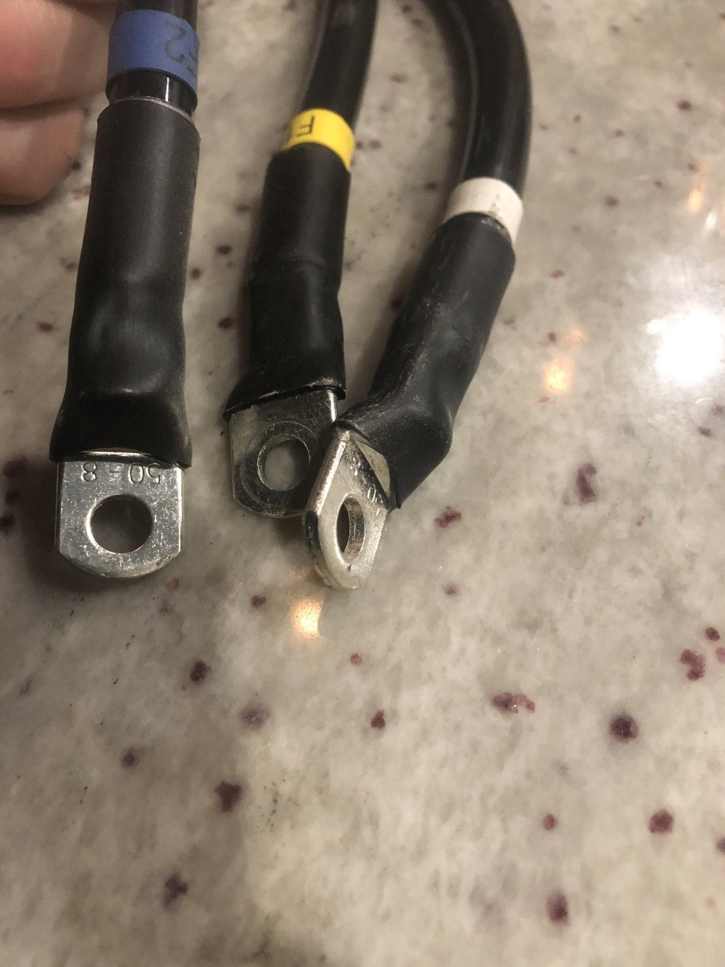

Some bumper manufactures offer a solenoid relocation kit to accommodate their particular solenoid location design but in the event you're moving under the hood, it's really going to be custom length cables that are matched to your exact application (bumper, routing and solenoid location). Pretty easy to do for anyone with cable tools (we offer this with winch sales for example).
Have cable tools, can crimp - are the end connectors standard lugs ?
Just trying to figure out what needs done.
When I had the 9.5 rs I had to put the solenoid under the hood . The stock cables did not reach were I wanted to mount . I just made longer cables . Here is a pic of the stock lugs . I have since switched to the 9.5 rsi. Excellent products .

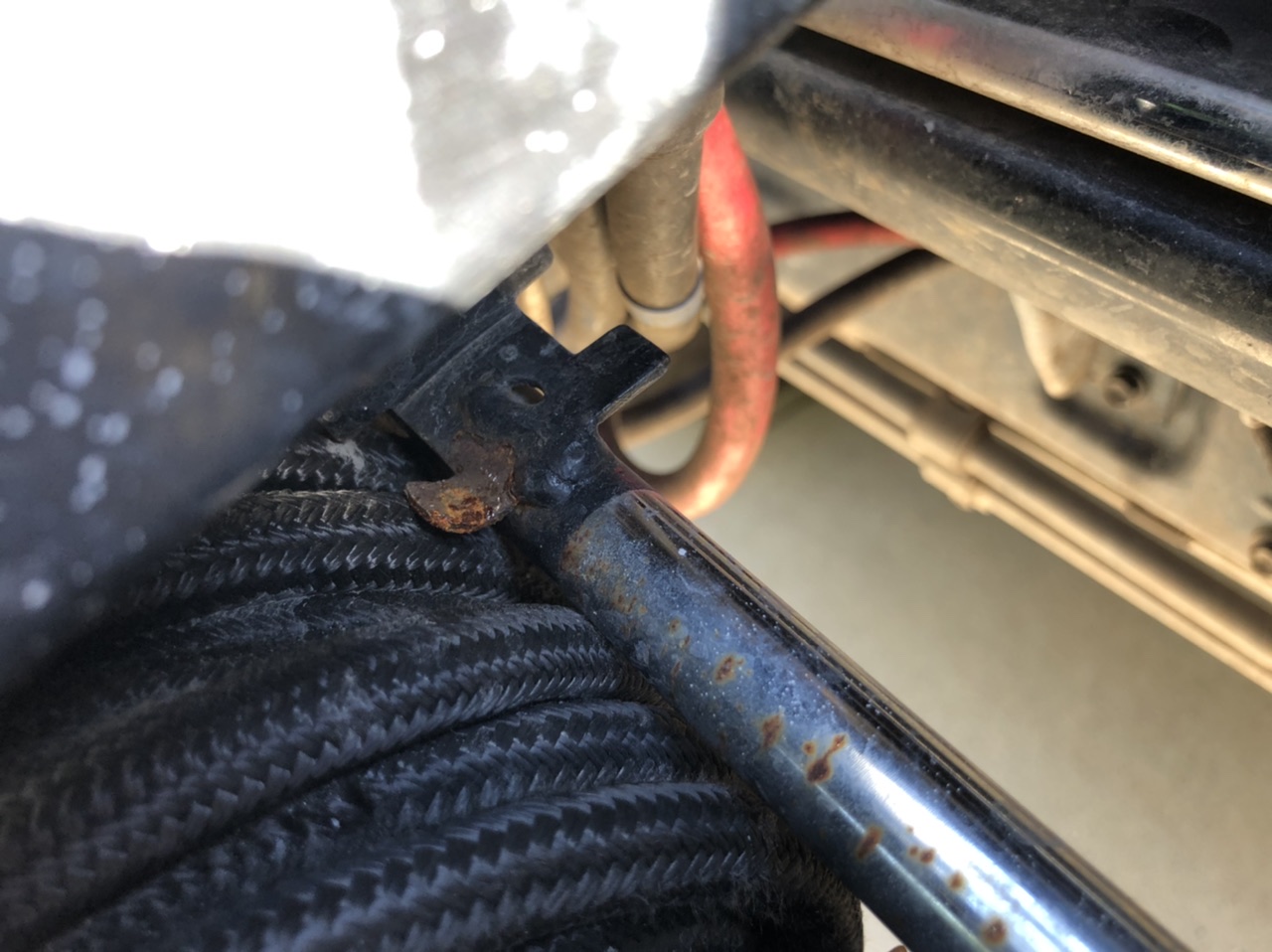

My guess is the tab (for lights?) on the ARB bumper is the reason for relocating. Appears to be plenty of cable length.
Clamps are still in place.
But these tabs are spot welded in place. They grabbed the rope on a pull and are now frayed - hence my push to get this relocated. I pulled them up to where they are now, but not ideal.
Curious on the tower. Sounds like I may need one.
That piece that is spot welded to the winch is the tower I was talking about. If you can grind off those welds you’ve got everything you need. Just use the hose clamps around the feet of that bracket that is spot welded.
you will need to remove the light tabs. I had to do the same on my old ARB bumper.
