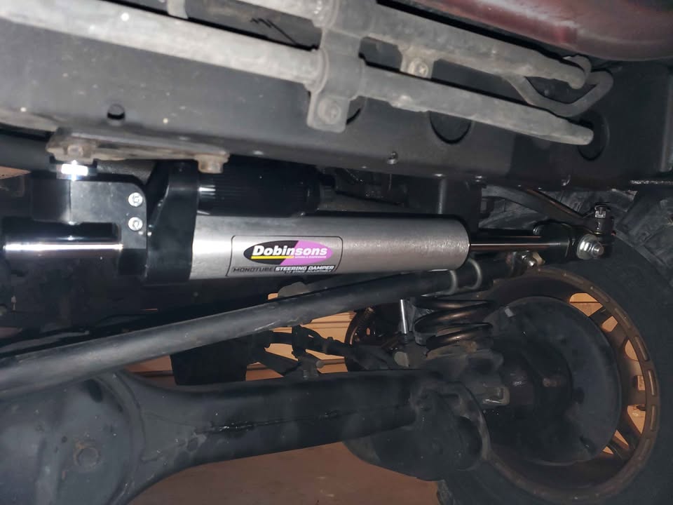

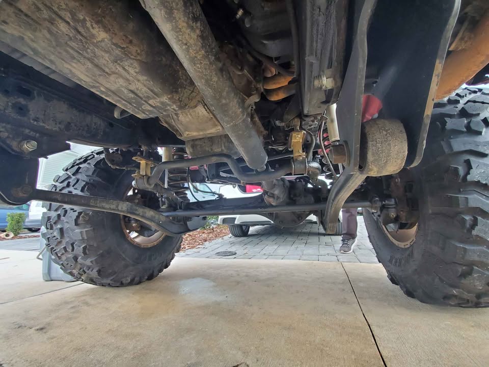

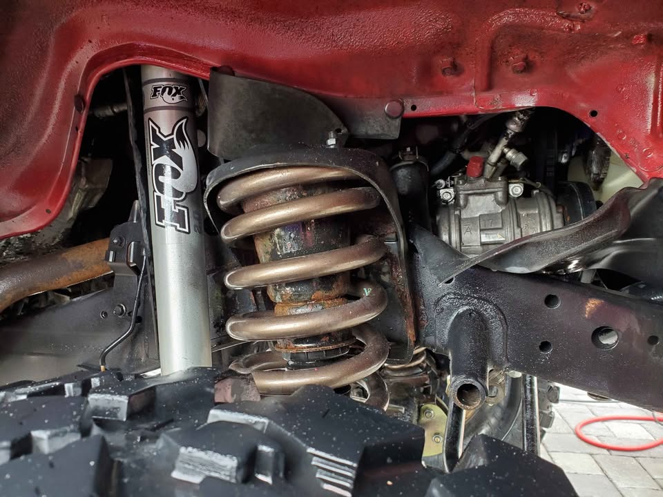

Also wondered about the 6" lift, since every 1/2 and 3/4 ton truck I've driven with a big lift was terrible everywhere except offroad (mainly mud)View attachment 3892930View attachment 3892931View attachment 3892932View attachment 3892933View attachment 3892934
Weird, I'm seeing two methods of caster correction. Both drop brackets and correction plates, which explains why the front 3rd member is contacting the tie rod in pic #2. Also see the extreme angle of the spring perch in the last pic.
Glad you pointed that out, completely missed it, but honestly didn't look super close since I was planning on thoroughly checking it out in person. Now I see the curve in the spring.
He also just messaged me saying that "it would only be $3000 parts and labor to fix it" so yeah he realized the whole he's in and trying to dump it on someone that doesn't know enough to at least get some advice and/or quotes.

$3,000 to fix what? These days a head gasket job and all the do while you're got it apart is going to be double that amount. That vehicle has been beat on hard. It could be the angle of the photo, but The passenger side control arm looks to have a significant bend. I would guess this truck was modified several times without a clear objective how to do it right. Your observation of high lift vehicles certainly applies to this one. I sure it drives like crap on the road.

I noticed that control arm as well but it looks like a fish eye shot, so could also be that.
~$10k for a quality rebuild installed by a shop (Fj80Oregon rebuild plus shop labor), plus a couple $K to sort out that mess of a lift. Might be worth starting with one in better condition. I wouldn't pay more than ~$4k for one like the one you posted.
