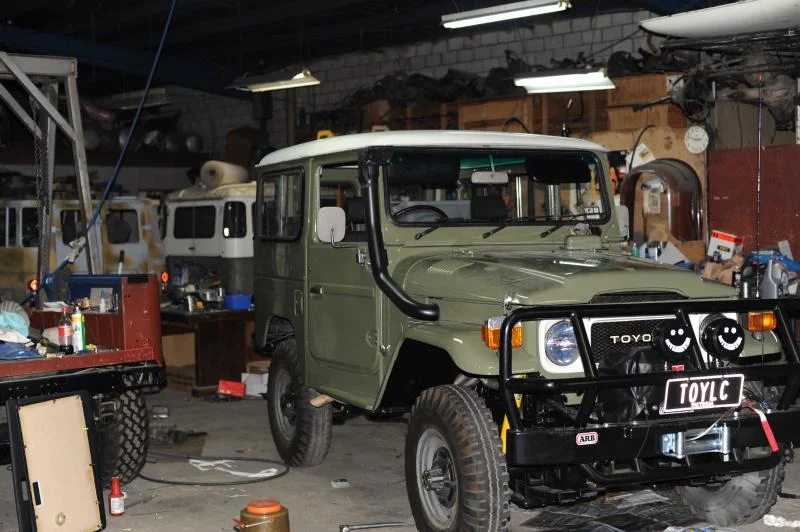

What is the deal with your snorkle? You may have mentioned it in an earlier post, but that's 266 posts long. Is it a homemade job or bought as a package? I would like to make something like yours. If you get time, can you post info about it?
Sorry I only saw your questions now. Some info in post 232 IH8MUD.com - View Single Post - Intro: Ugly Betty(so far)
I got the snorkle with the truck and the head was one of those ugly but very effective Donaldson precleaner types, which I did not like. I finally gave up trying to buy just a Safari head only,from the local Safari agent as they just refused point blank and insisted that I have to buy the complete snorkle kit. I then went back to the Donaldson agent and found the head in those pics, that looks just like(close enough to) the Safari one.I then also found out that those rubber bends and elbows are also Donaldson products that are freely available. Air Filtration I will probably never bother to buy another expensive Safari snorkle again ...

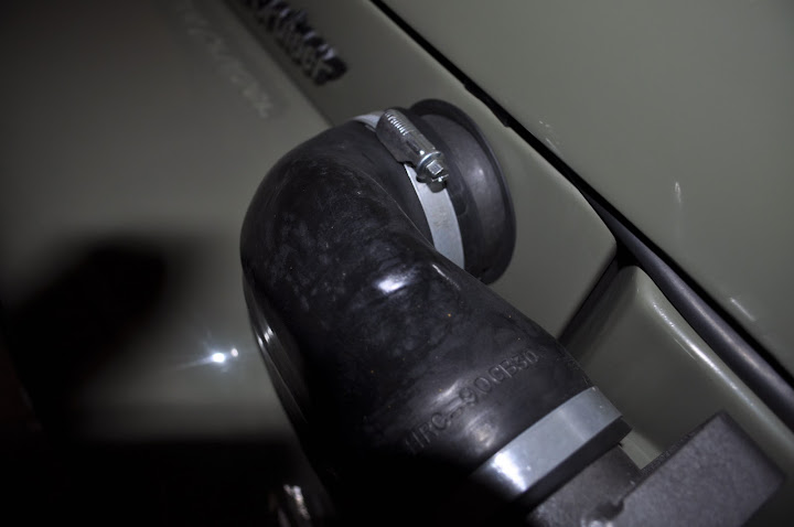

That link worked. What do you call the one that comes out of the side bonnet? Is it an elbow? It is the first rubber part towards the engine attached to the short section of tube in the picture.
The part numbers would be great. IF you have them for all the pieces, I think I might give it a try.
Do you mind snapping a few picks of the engine compartment (how the snorkle is attached to the air filter)
Here ya go
The part no is HRC-90CB30
She has been playing in the dirt a little, so the purdy is slowly going away ;)
The 2nd 90 deg elbow
Part no P10-5532
I couldn't find a part no for the head but IIRC there were only 3 different ID sizes
I didn't X reference those numbers with the ones on that link but even if they have been changed I think the pics should help you to get what you need. If you need more pics just say so :cheers:
