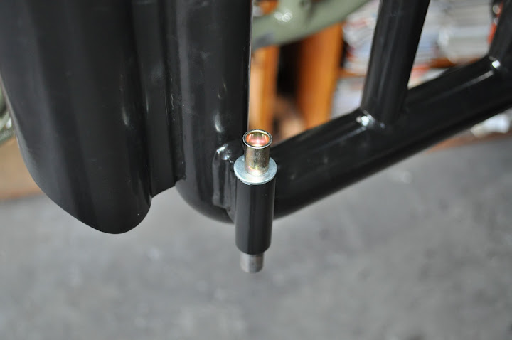

On tha passenger side gate we will use what we call a " bakkie(ldv) latch" which is spring loaded
and welded to the inside of the gate, in order to lock it into position behind the bracket that is bolted to the OEM "door stopper" holes in the pic. (the pic is somewhat confusing as the gate sits behind the bracket as opposed to in front of it, as it will be when bolted to the hinges)
That way the pax side gate is locked stationary and the driver side gate can be closed against it. Unfortunately the use of single hinges highlighted the need to replace the OEM hinge bushes & pins which meant a delay today. Hopefully I will have them back from the Eng shop tomorrow and when done I will shoot you all the pics you need.

I got my hinges back from Andre Engelbrecht Eng and once again he came through with flying colours
The new SS pins and bushes not only look great but they are easily removable and made a huge difference when it comes to lining up the gates.
Now that the doors line up properly we can finish the latching system and then it is off to the powder coaters.

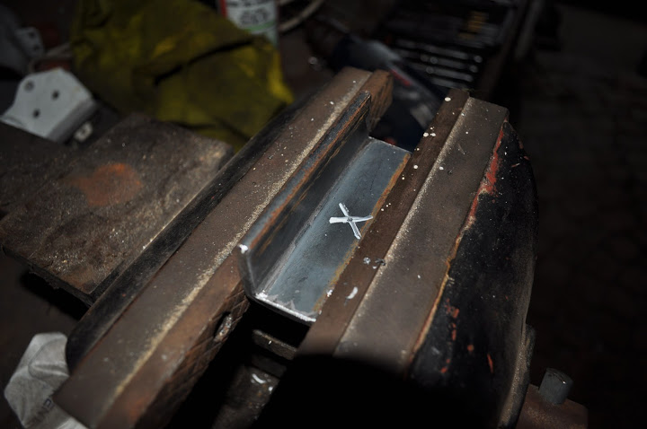

Anyhow I also needed some kind of packing system. The fridge was sorted with a African Outback slide that I mounted on a piece of plywood that was bolted to the tub using the multitude of OEM captive nuts intended for the rear seats of the LX model. That left me with quite a bit of space on the pax side. With the trip being 17 days away now , there is not enough time to build a drawer system and to be honest I need some more time to decide how I want my eventual drawers to be- no need to rush into something now. I decided to go with a simple solution for 4 ammo boxes ,largely because I happened to have some old angle-iron lying around ...
I had to switch the removable cross brace around in order to fit the stacked ammo boxes ..
A bit :hillbilly: it may be but it will work fine untill I figure out exactly what I want.
