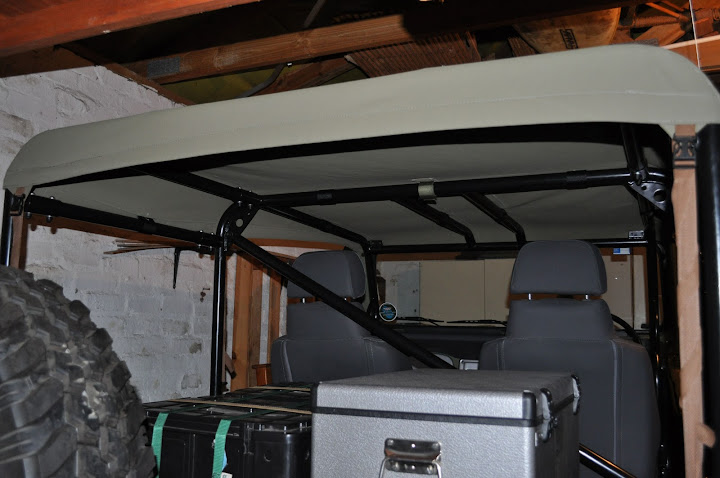

When I told some friends that I was planning a Rollbar/cage cum bikini top type setup I was immediatelly ragged for building an overweight scaffolding piece of junk. Well most of you have seen the result of the cage and now that I have my G-string top, those sourcrouts can just kiss my "parson's nose" sitting pretty ontop of the predicted scaffolding.... :flipoff2:
I also fitted the FM noise reducer
Almost ready .... :bounce:

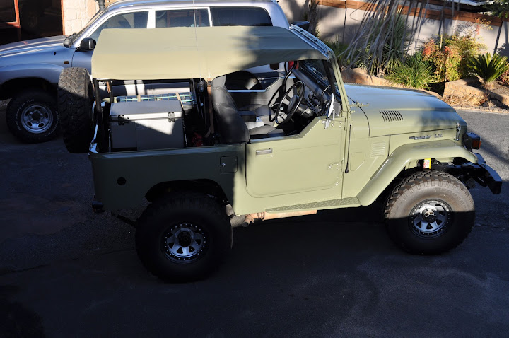

More info on the bikini top~ Who made it? Deminisions? Fabric used? How is attached in the front? It looks like it is not attached to the top of the windshield.
:lol:
It is DR 250 ripstop canvas. It was made by a company about 5 mins from me(Canvas World) using my truck as a template and it cost me just less than $100. It is attached via a piece of aluminium "ropemould" that was bolted to the Windshield using only the existing OEM captive nuts.
I wanted the mould the "wrong way" around, in order to create tension the correct way around ;) From there it is just the 4 strings with quick-release clips as planned for, during the cage building. These guys didn"t even see the cage etc before the time

The top is great ---would you consider having some made for others for a bit over the price?
Your rig looks better than new:cool:
Thanks guys, much appreciated !
..The top is great ---would you consider having some made for others for a bit over the price?
No need to inflate the price. The only problem would be dimensions. AFAIK there are no OEM softop bows in this country so ... :confused:

I have always believed that the drive in a topless 40 is better than with a hard top on and therefore I was in no particular rush to fix my roof’s gutter. I also always thought that a 40 without a decent roll cage was a serious danger in a rollover situation. When the upcoming J4 series "Legends" trip suddenly hit me I saw it as an opportunity to "kill 2 birds with one stone" - I could get a roll cage for safety and fit a bikini top so I could still make the most of the last bit of our summer, on the looming trip .
We considered importing Metaltech cages from the US but they were just too bulky, resulting in exorbitant import costs, so I had to go custom and local. The additional problem was finding someone who actually knew what they were doing when it came to cage building. Enter Cris Ingram from R&D Off-Road. I rang him up and from the onset I could sense how keen he was to do this. He had many years of experience in building and racing Challenge type vehicles(including building cages) which was an obvious plus factor. The problem was that we had nothing to use as a template and therefore had to basically start from scratch altogether. I had a few requirements e.g. no drilling or welding to the chassis etc and I wanted it to be removable even though it must still work with the hard top back on. Armed with some “stolen pics" from Metaltech et al, we started the long process. The pics tell the story ….
I am totally stoked with the the way it turned out ! Cris and his guys really came through on this one :cheers:
