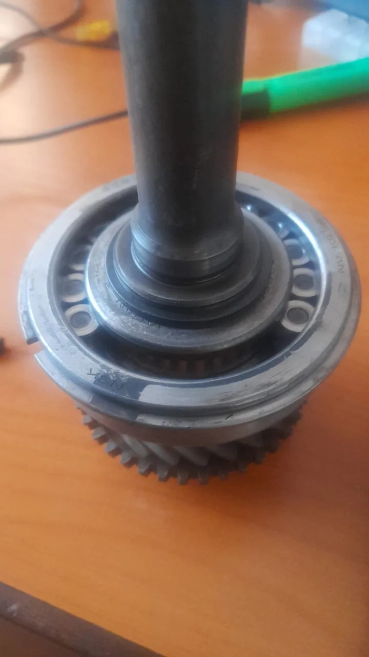

New flywheel bolts , rear main oil seal, pilot bearing, clutch fork with rubber boot, gearlever cushion, bush and rubber boot, Heavy Duty Terrain Tamer clutch assembly, release bearing, rebuilt gearbox with new bearings and seals and rebuilt the prop-shafts. Also replaced the gearbox x-member rubber mounting/cushion .
She has never been so quiet and smooth in her life ! :steer:
