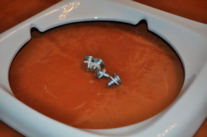

Yug, who wants old flaky and dirty knobs.
all done and ready for install ...
To go with the other freshly painted & rebuilt bits

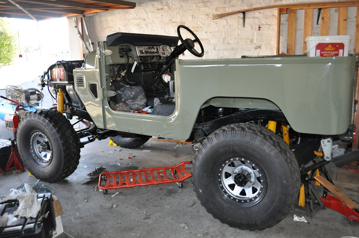

Man I love the tall and skinny look :cheers:
just read through your whole thread and only now noticed that you put your steering wheel on the wrong side! Eeek... Hope that doesn't cause too many problems!
Aside from that though, she looks awesome! Keep the posts coming.

With the Fuel Control Relay woes over I could move forward again ...
Tonight I started alignment of the panels which is proving to be difficult if attempted without help ! :doh:

.. on ur running boards there is just one small square cushion on underside correct?
R
There used to be - Due to the new custom tubmounts, I gained an unintentional 10-15 mm of "body lift" :rolleyes:. So I made an additional pad for each side, to get the boards level again, cos it looked too much like a bird with broken wings :whoops:
LOL, thats why I asked, it seems mine probably are the same so I wanted to be sure, so I will have to make additional spacers as well. I bought new poly mounts but it wasnt a body lift?
