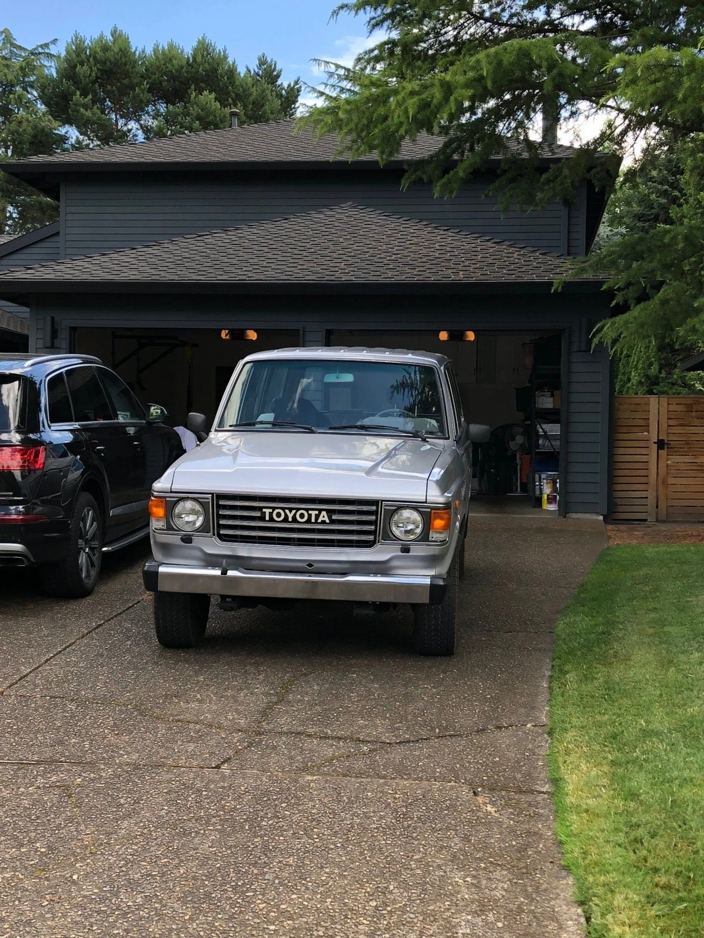

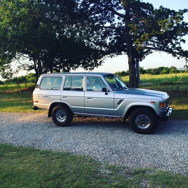

Here's my girl....I love driving this thing. It's like being in time machine! ;-)
