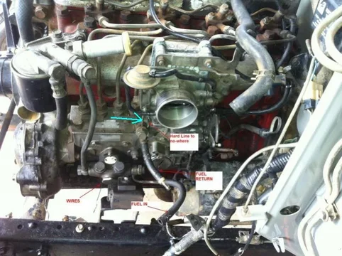

Below is a photo of my toyota 13b Diesel engine (out of a daihatsu delta), which I am putting in my bj40.
I have two questions:
1) I have labelled the photo with "hard line to no-where". This line is not connected to anything - what is its purpose?
2) I have labelled where I have two wires coming out of the pump. I have attached a second photo of the item. What is this and do I need to hook these wires to anything?
Photo of wires
There are 4 plugs (each called PLUG, INJECTION PUMP FELT PLATE) on the bottom face of the main body of the IP. They lie directly below each of the 4 delivery valves (and below the 4 related lobes on the IP camshaft) and are needed to gain access for assembly/disassembly work.
And it looks like they have a "square-drive" hole for torquing/loosening as shown here:
Could it be that one of these plugs has been removed and replaced with that hex-head plug you have that has the wires coming out of it.
It sure looks like this is what has been done because I think I see one of those square-drive plugs directly beside the wired plug in your photo.
If so, perhaps it's some form of fuel heater? :hhmm:
Anyway, if it is sitting there instead of one of those plugs I'd say it is non-OEM and the work of a previous owner (and it would be easy enough to remove it and check whether it is a heater or not).
I can find no record of Toyota installing anything other than the standard square-drive plugs in those holes.

PS. As for your pipe-to-nowhere, I'm curious too as I mentioned in your other thread..
Yes - it certainly does sound like it could be a fuel heater or something similar.
The 13b did not have a glow screen - supposedly these were a cold climate optional extra on the daihatsu delta - so maybe a fuel heater was a PO solution?
If I take out the hex plug - what is behind it? Do you have an exploded diagram? Don't want a spring loaded something or other to come flying out with a shot of diesel thrown in the mix!

I began thinking of this immediately I woke this morning.
I now think it is far more likely to be a sensor for a tachometer (than any form of heater because heating the fuel WITHIN an IP is normally unadviseable).
As mentioned before, each of those plugs sits immediately below a cam lobe. This is the ideal location for a tacho sensor...
Some black oil will probably pour out when you remove any of those plugs but nothing else should. They are normally there solely for access purposes.
You now have the torque specs and if you have a good liquid sealer (and have the patience to get the threads cleaned properly prior to application of the sealer) then, unless you want to run a tacho from there, I'd remove it and replace it with a standard plug from your other IP.

Hard line to nowhere looks like it should go to the fuel return rail on the injectors?
That would be fine Drew except it's apparently blocked off internally (but this is just my assumption) and I think this line here alongside it (arrowed in aqua-blue) goes to the fuel return rail:
Am I right MS?
And I remember seeing these "lines to nowhere" on other diesel cruisers but in slightly different places (if I recall correctly).
Yes, line just on the left of line to nowhere is return from injectors.
I will need to pull off the banjo fitting to see if line to nowhere may be blocked off. This was the case on the vacuum fitting off the back of the alternator and the line acted as a stopper to prevent incorrect positioning of the fitting.
Ok - got home and took off the banjo fitting.
Solid tube - so used as a locating pin to prevent fitting being installed the wrong way or damaging injector return pipe by rotating fitting whilst tightening banjo!
Mystery solved! Thanks for the help and getting to the bottom of it!
