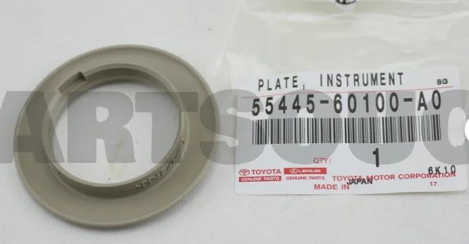

I've got a 2006 LX and just bought a new ignition bezel, 55445-60100-A0, based on Amayama's parts diagram.
I just tried to install it and the diameter is too small. Some sources say I should have gotten the 55445-60110-A0, but it's NLA.
Does anyone know if there's an available part for the 2006 ignition bezel?

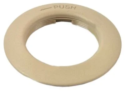

Image for clarity:
So.. I was staring at the non-fitting part and finally connected with the literal instructions printed on the face. It took more of a push than I expected, but 55445-60100 was indeed the right part. You need to shove it in good and hard and then it will latch as you twist.
