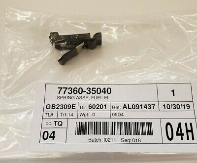

Yep. Happened to me about a week after I took possession of my 2013. The replacement plastic clip is <$5 and snaps into place in about 30 seconds, just pry the old one off with a screwdriver.

It should. Grossinger Toyota by me is known for terrible service. I can confirm. That said the part was literally under $5 with tax and I installed it in less than 2 minutes - 3/4 of which was determining how to pop the old one off (pro tip - just pry it off from the door side it'll be fine)

I just ordered a spare off eBay
$8.12 with shipping from Bell Lexus

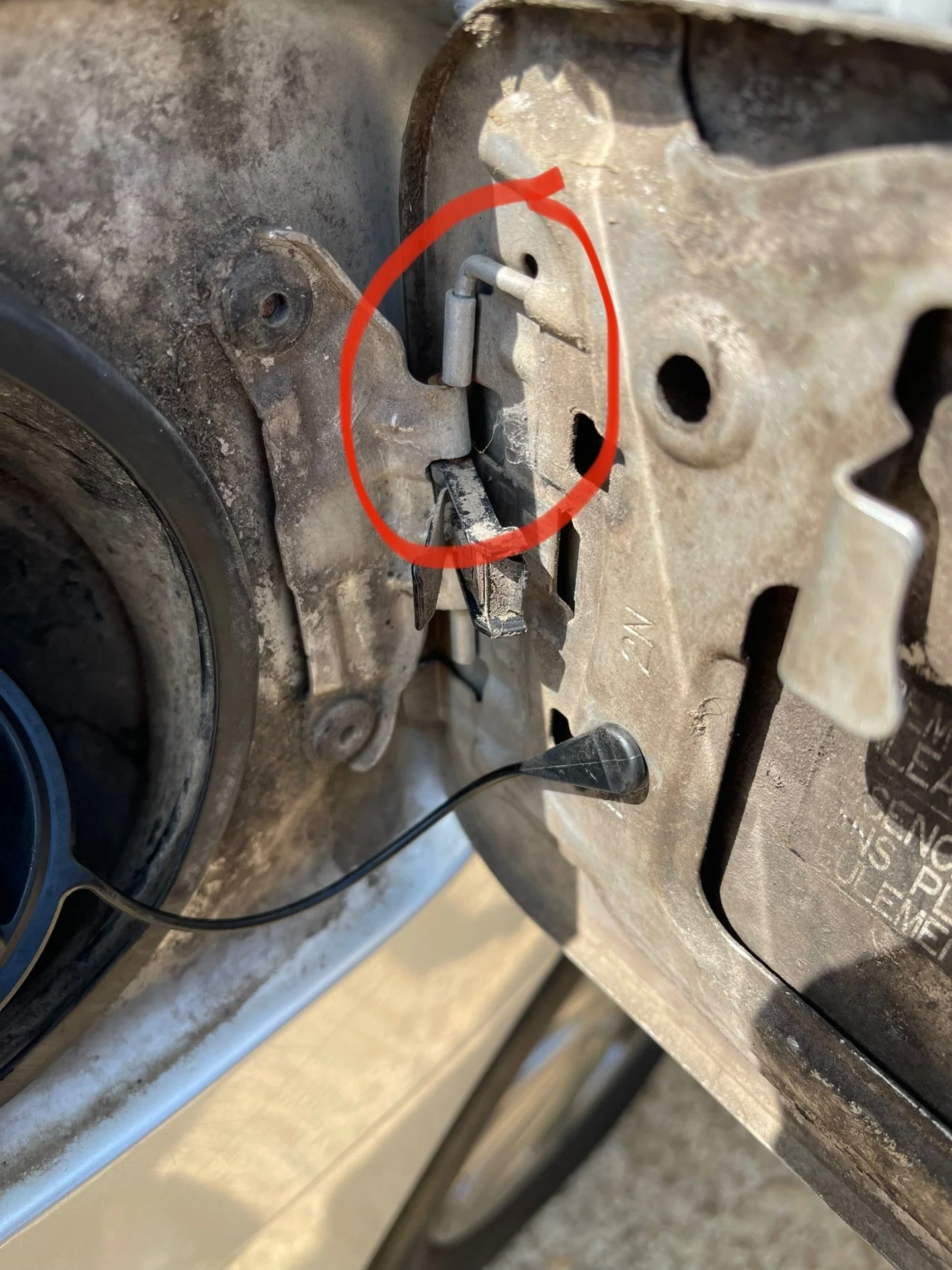

It appears that I've broken this same part, but also possibly the hinge? Does anyone have a part number for this? I know, it's dirty...
