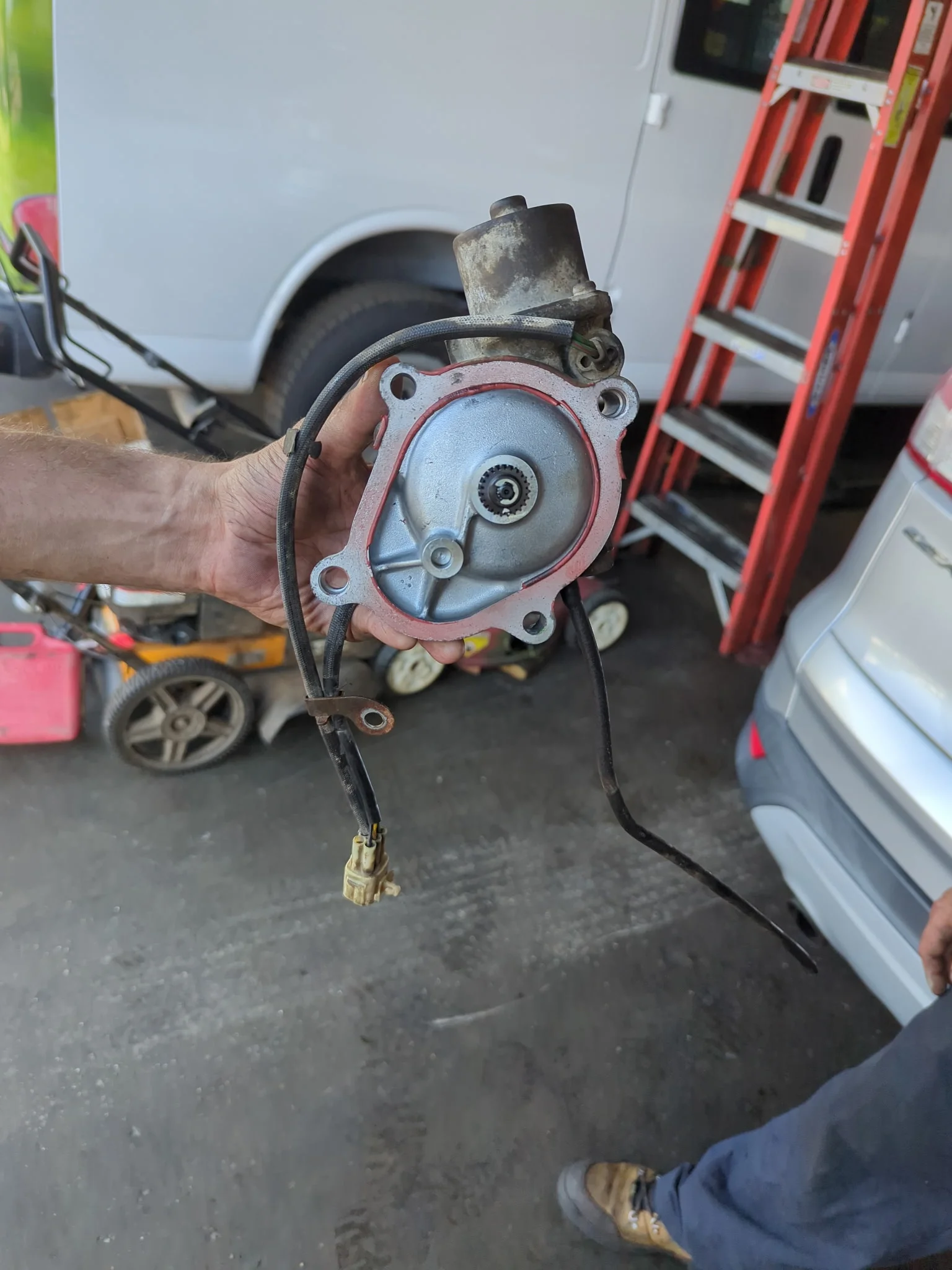

Does anyone have a 1991 FJ80 3FE CDL for sale ?
Part number : ELEC364108X
I’m in desperate need of one. My LC won’t move unless it’s in 4L.
I’m Located in Norfolk, VA. Will gladly travel l!
This is what my old one looks like.
This will get closed and moved to classifieds but…
I’d double check that part number. That’s not a Toyota number format
Have you verified it’s not the front drive flanges being stripped? Has same effect
Verified that actuator actually doesn’t work with 12v applied ? Fresh 9v battery may work as well.
In lieu of trying to make it home, I disconnected the from drive shaft and it’s still making the grinding noise while engaging 4H. I haven’t tried the voltage test. I will do that , and get back to you ! 🫡
