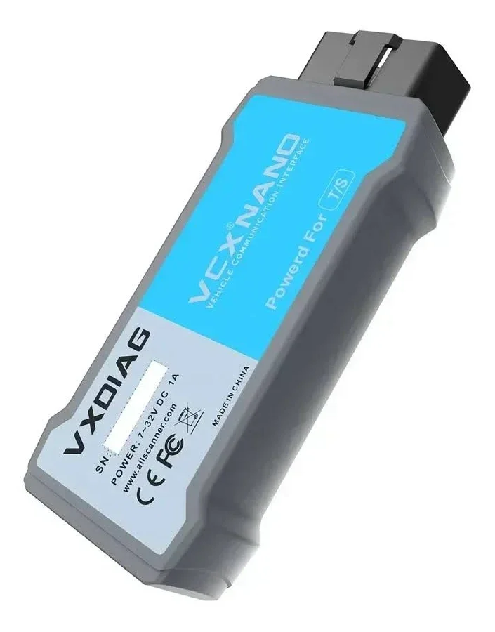

Have you tried the VXDIG NANO? It might work. For me the VIM selector in TechStream reports that VXDIAG supports all protocols while the Mini-VCI does not support some of them including the transmission one.

2.Regarding the VCI cables, I first tried one from AliExpress (v1.4.1 fw clone). It was able to read my 2021 RAV4, as well as view and clear DTCs, but when I attempted to program a new set of TPMS sensors, it failed with a “Lost connection” error. It might work fine for vehicles older than 2019, but in my case it couldn’t even read the VIN or automatically detect the model — I had to select it manually. After researching alternatives, I ordered a VCX Nano for TIS, and it worked flawlessly on the first try.
