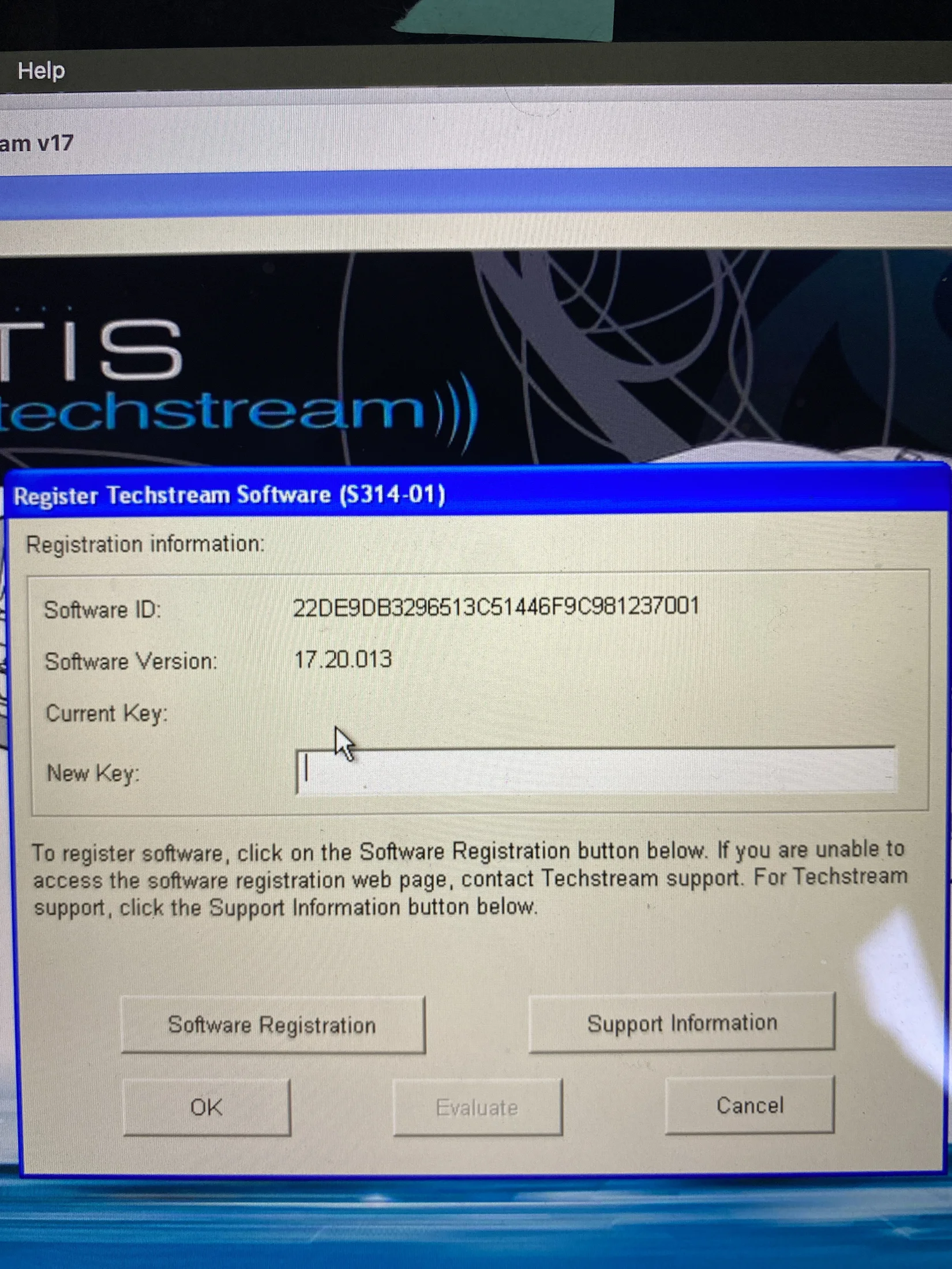

Hello,
I’m stuck at the product key. Anyone have any advice?
