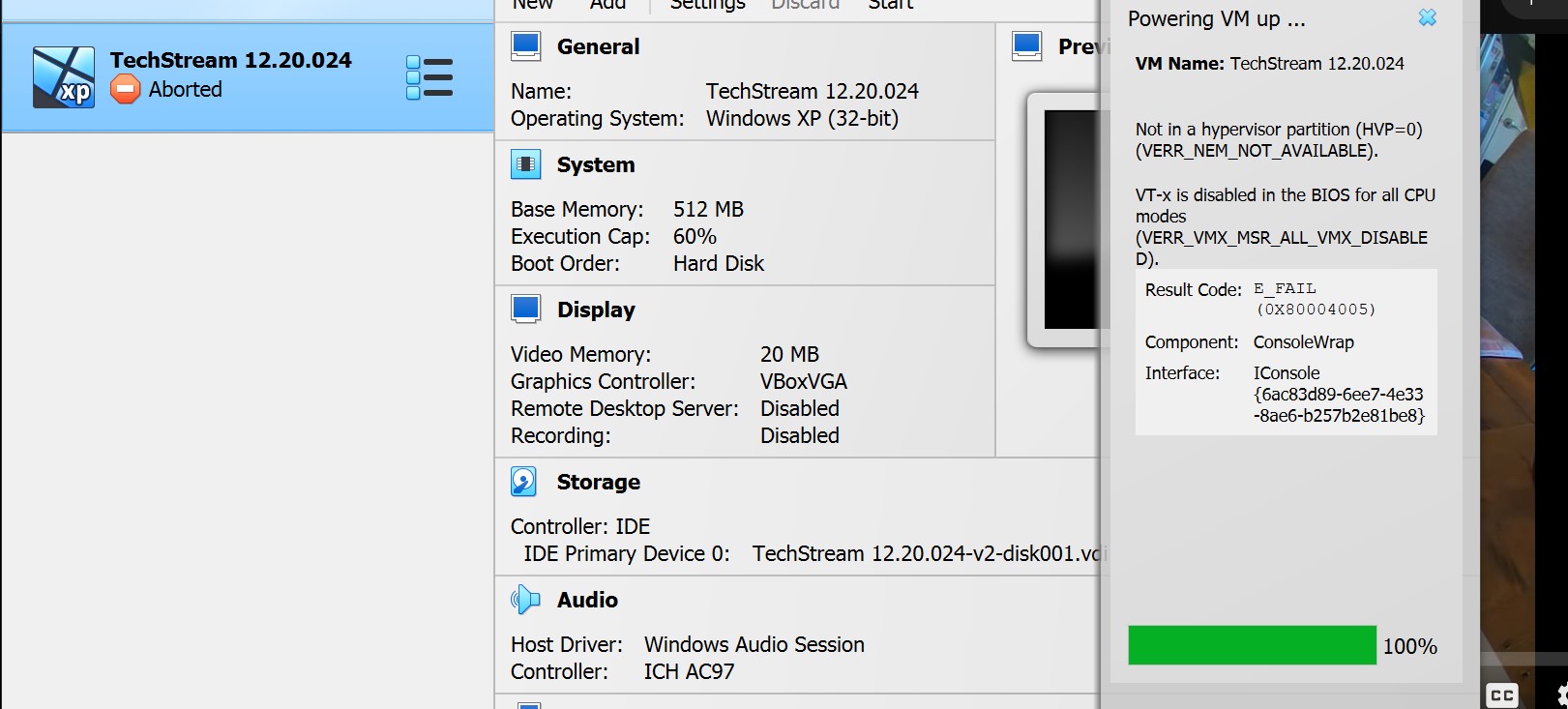

All day to only arrive this this point: I've downloaded VM and TS from page 1 on to my W10 laptop. When I hit start in the VM to open TS, I get the following error message on the right:
I've turned off audio settings in VM as I've seen mentioned here, but still haven't figured out the trick.
I've found this error mentioned a few times in the thread but haven't really seen an answer. I hate to just post up a blunt "what's the problem?" but I don't have the capacity to go through 70 pages of this beyond searches. So, anyone know what's my problem?

HA I ****ing did it!
So here's the instruction for the fix to the error mentioned in my post above.
I didn't use the wizard, just the instructions. On my Lenovo it's continuous F1 button pushing during start up (don't use the function key if your F keys normally require it). This brought me into Bios, where I was then able to locate and enable virtualization. Turn on, press F10 to save and exit, and reattempted to import TS.
It worked! @LJE WHO'S COMPUTER ADVERSE NOW???

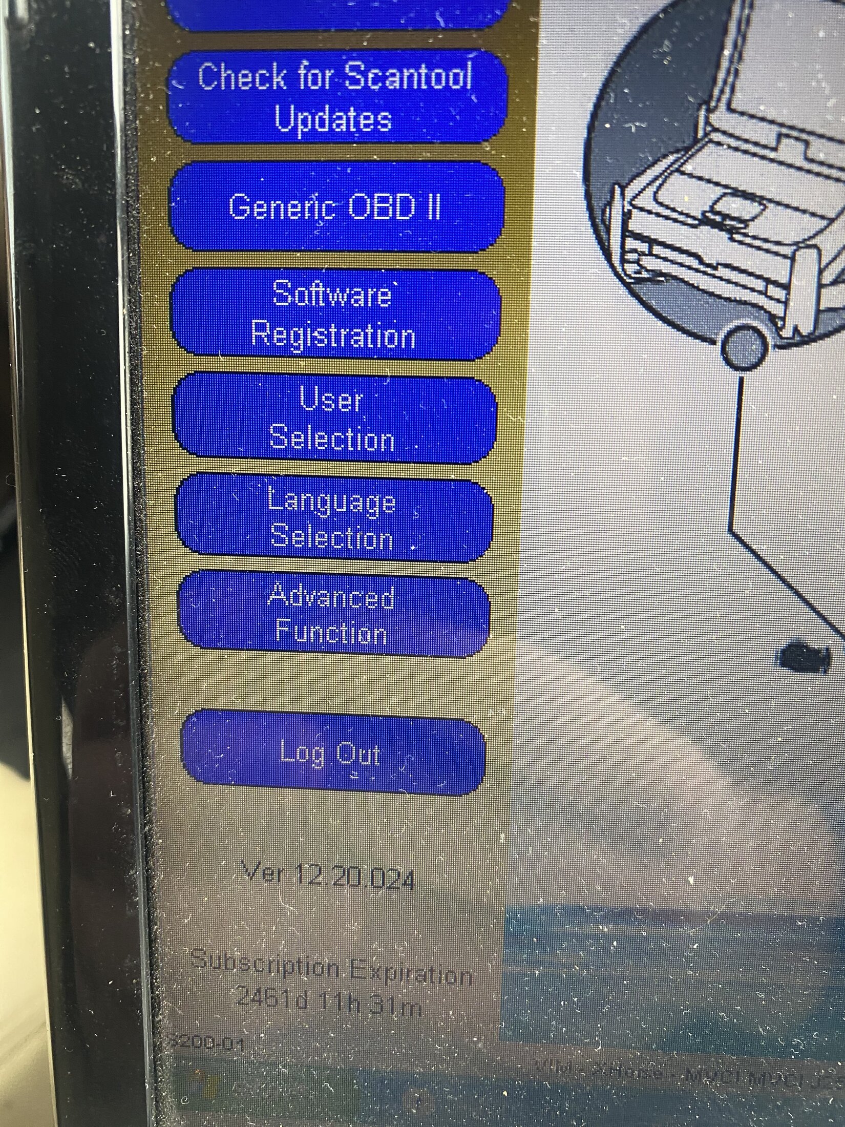

Hoping someone can help with this. Running version 12.20.024. Downloaded it a couple of years ago to check the pressures on my 01 lx470. That's all I really ever used it for. Right now I'm trying to reset the fuel trims on my wifes 12 sequoia flex fuel and I notice that the Utility button isn't appearing as an option on mine. Anyone ever seen this? Thanks

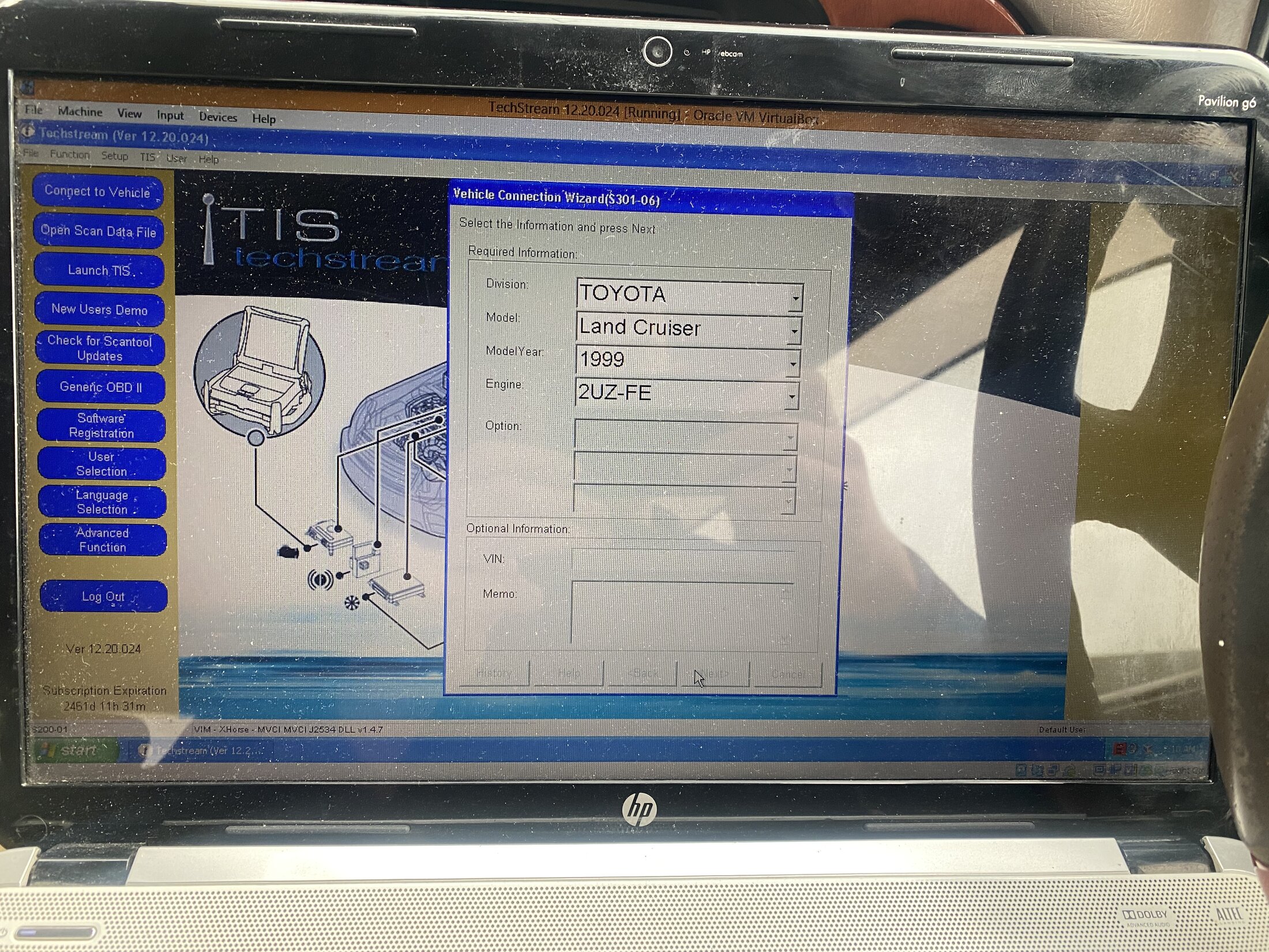

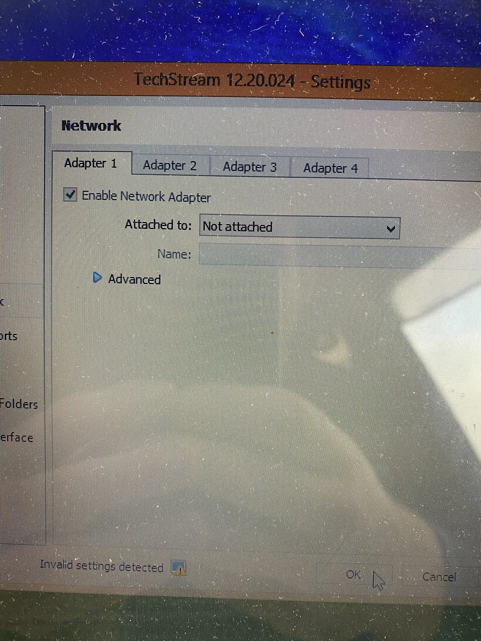

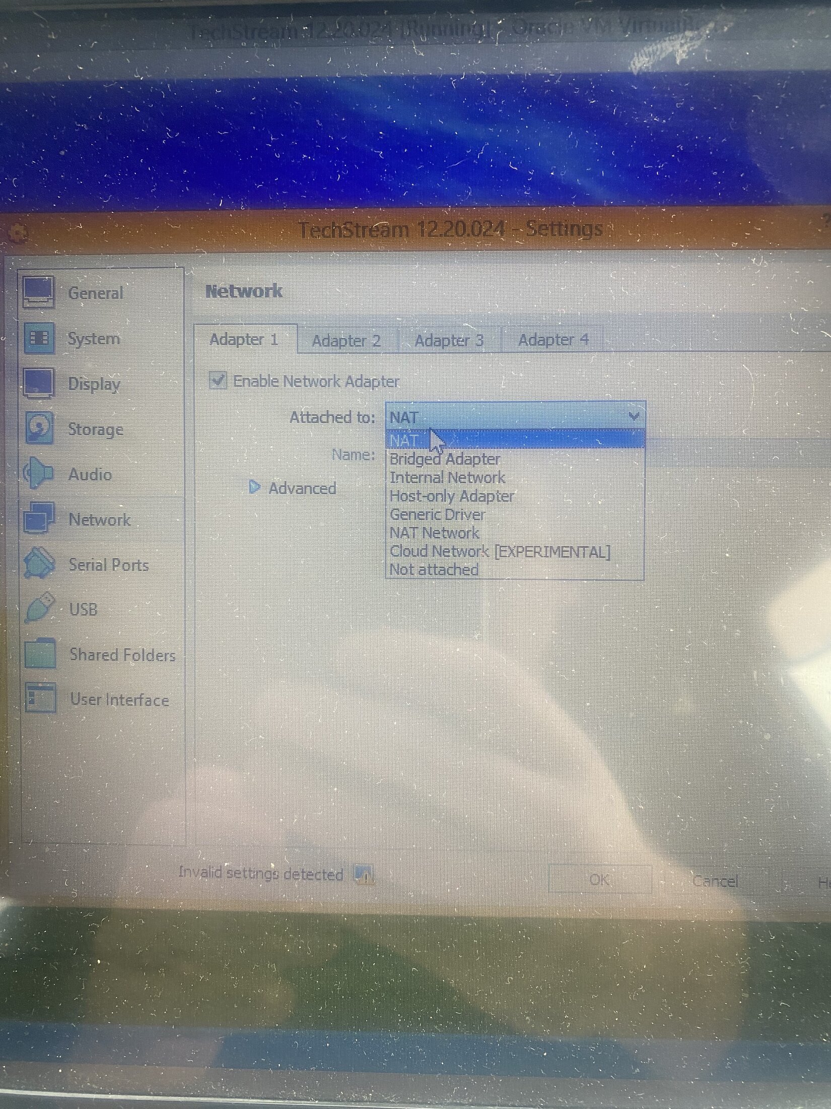

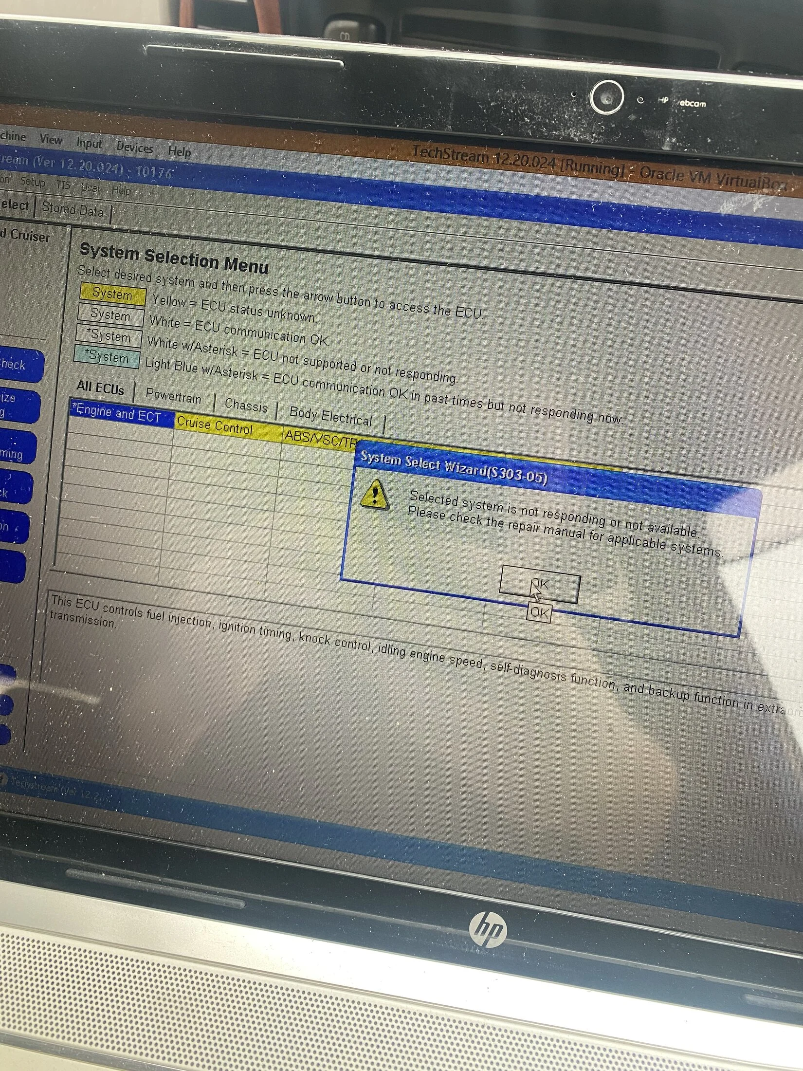

Managed to get everything set up to the point of accessing the ts. Using this threads vm and image. And the vci cable off ebay
Only issue is the software won’t recognise the engine ecu or let me do anything at all! Though it does recognise the cable is plugged in

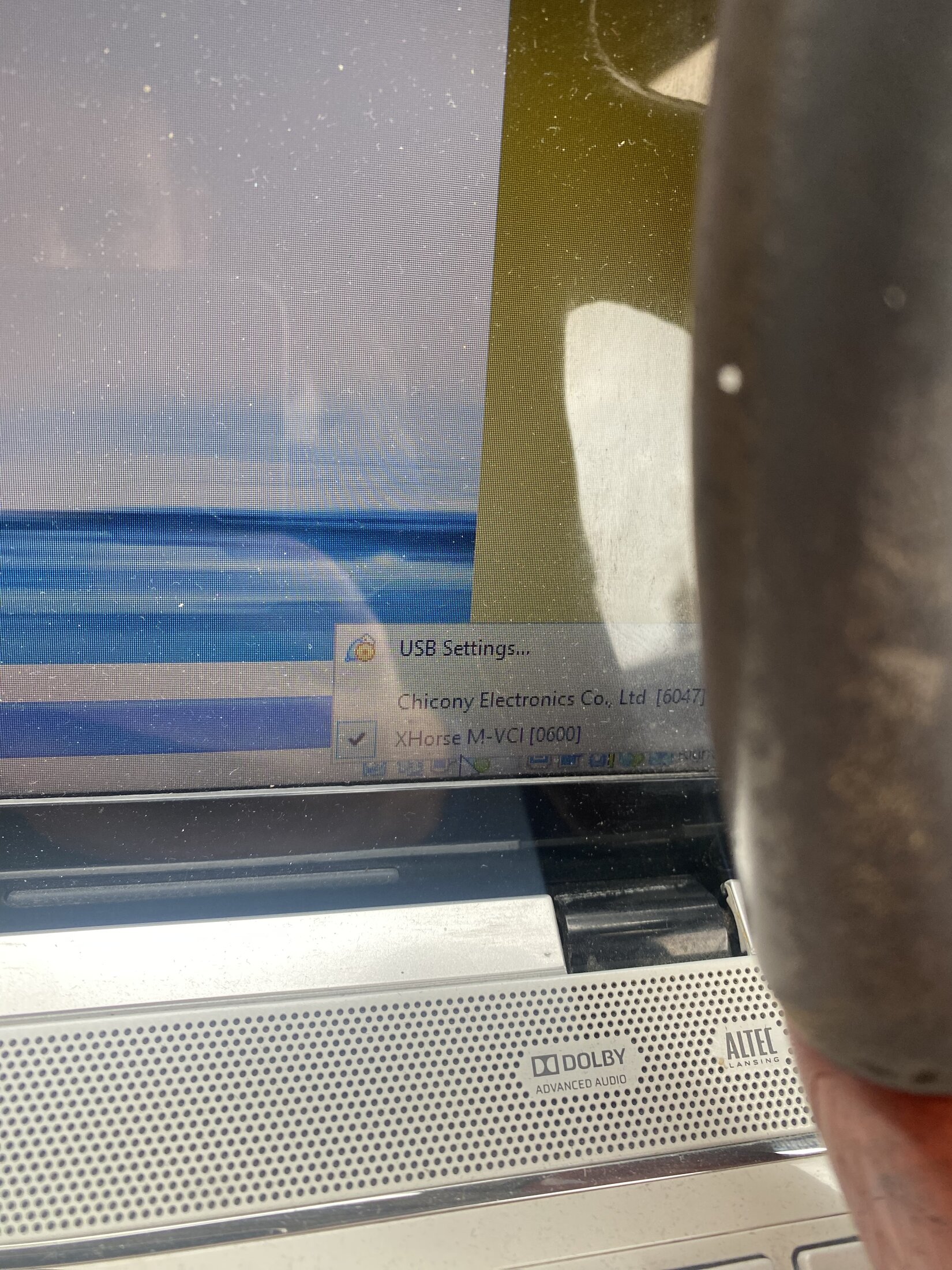

Did the bios vm recognition setting. Plugged the vci in after turning vm on. Set the settings as per this thread. Still nothing

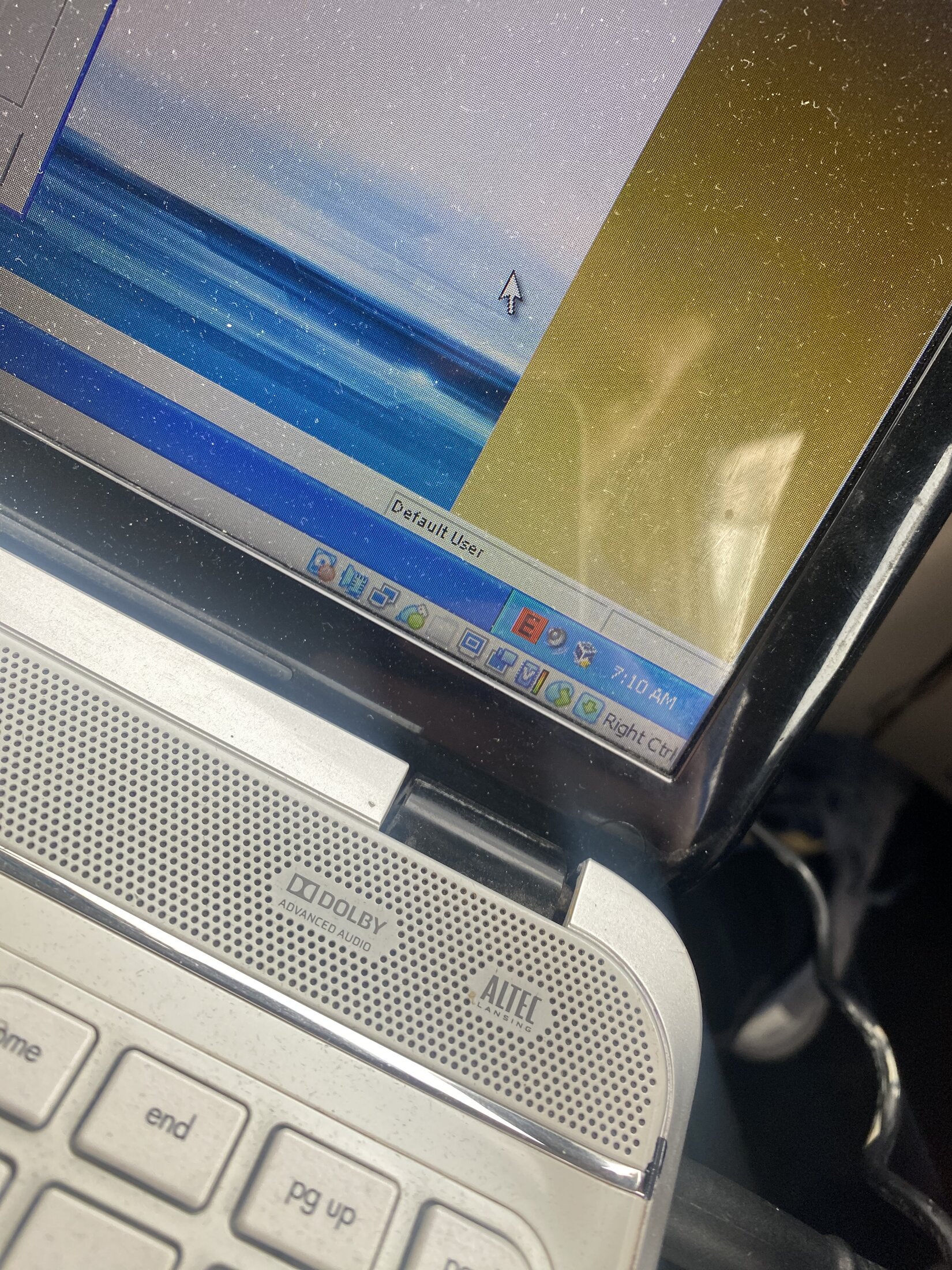

Now the xp network has turned off and won’t turn back on. And ts asks for a key every time now, however won’t accept the key provided on the desktop text file
Can someone please give me some ideas as I’m burned out mentally now and this whole thing is bonkers way harder than it needs to Be!

Your screenshots show it as the V8 petrol engine. Is that what you have? And are you still in North Wales? If so, you do need to change your location. Searcher SA gave me the instructions for that -> How-To: TechStream In 5 Minutes - https://forum.ih8mud.com/threads/how-to-techstream-in-5-minutes.1034923/post-15722055
I had the system up and running in a few minutes, correct engine and all!

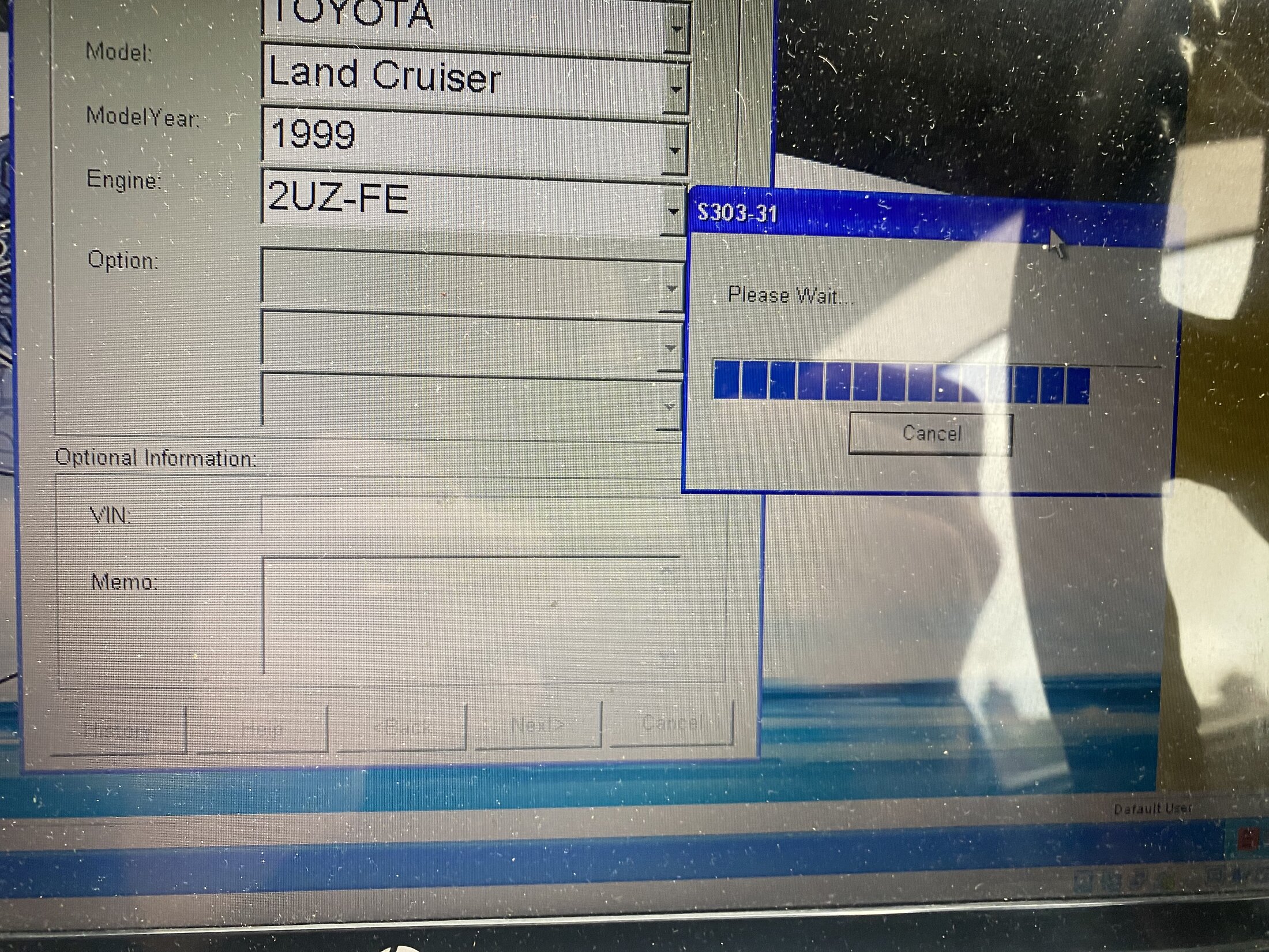

Hi yes I’m 4.7 Cygnus mode of LC (Jap import to the uk)

Did that setting process and it’s worked a treat!!! Thank you!

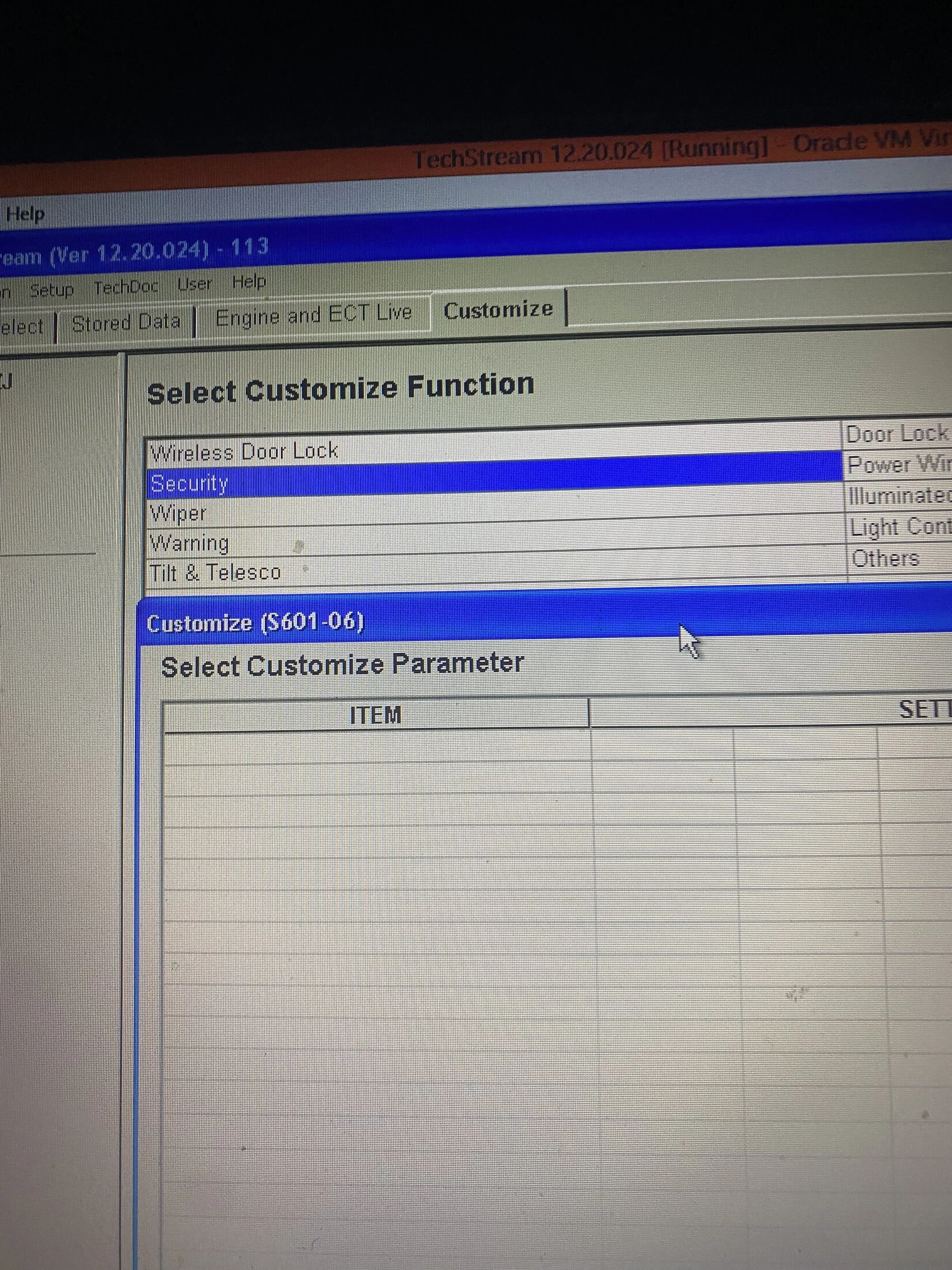

how do I access customisation settings please anyone? Mine open up but are all blank
After all this headache I’d like to play and set things to how I’d like them to be such as the AUTO air con button I’d like to do a specific sequence of settings
Thanks!
