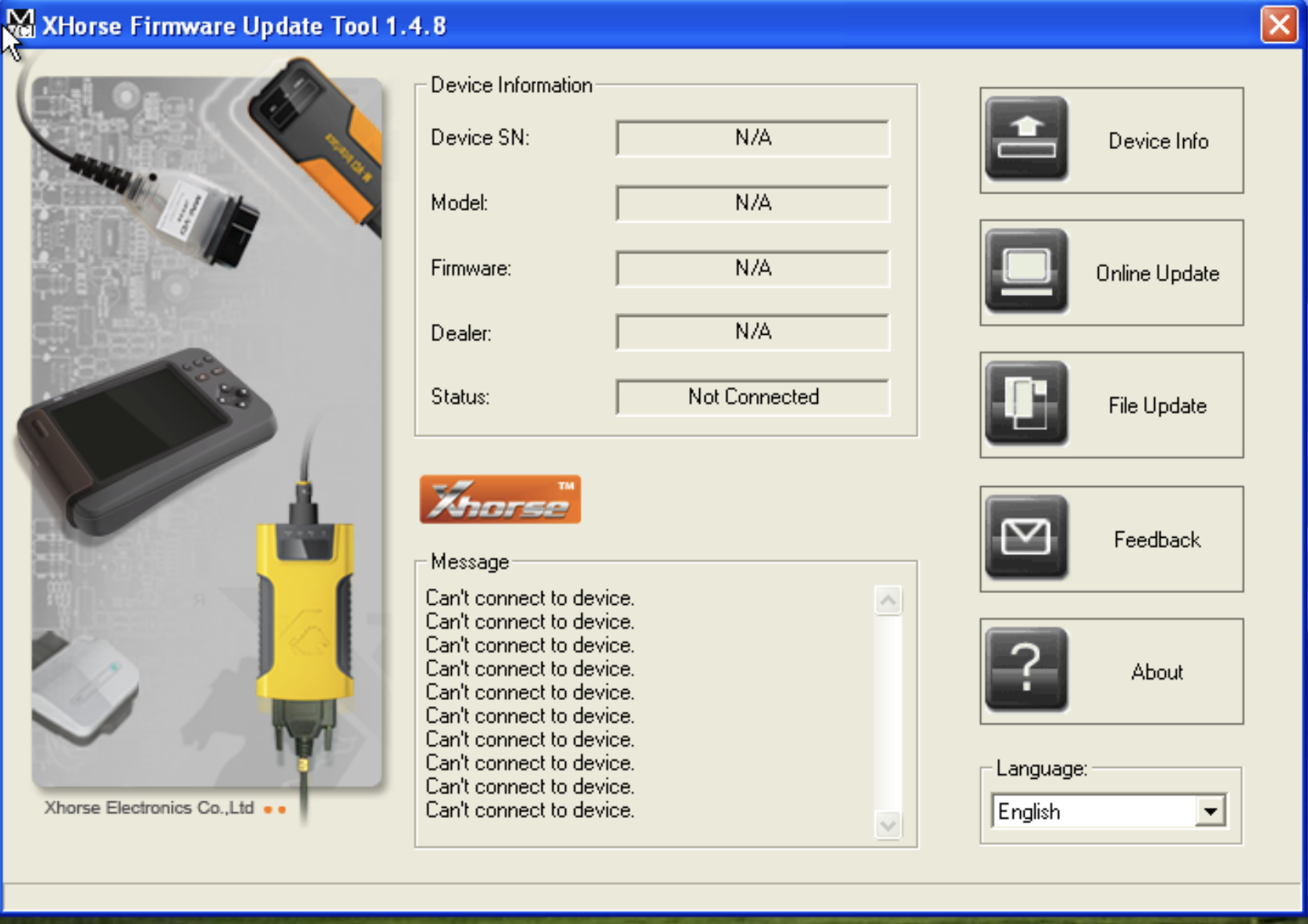

Installed the VM and XP image with TS given on first page, when the OS spun up, it worked right out of the box.
I have recent windows 11 Pro, on Yoga9, installed the Oracle VM, got warning to install python, ignored anyway and continued to spin up TS, but XP crashing as soon as that loading bar appeared. Then I updated VM and this time installed python and other dependencies (found how to guide by simply searching online), then I got that nostalgic boot up sound from my childhood, then I got connected USB sound, then I opened xhorse, clicked connect, it connected immediately.
Then I opened TS, it says VIM not connected. Then I changed the device to xhorse, then it's connected!
It's got my vehicle profile Rav4 hybrid until 2018, but I got 2024 variant. I don't think any option missing on this. I changed optional settings today. Probably explore other options later.

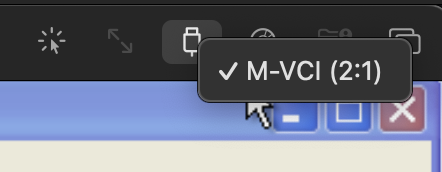

I'm on Apple sillicon. I downloaded the proper UTM from page 1, but my cable is not recognized by XHorse firmware update tool.
I am able to see the USB connection on the VM top right options, but cannot find it in the USB Manager menu. Any idea why?
Fixed it yesterday. Just deleted the VM on UTM and created a new one. This time, the cable was properly recognized.

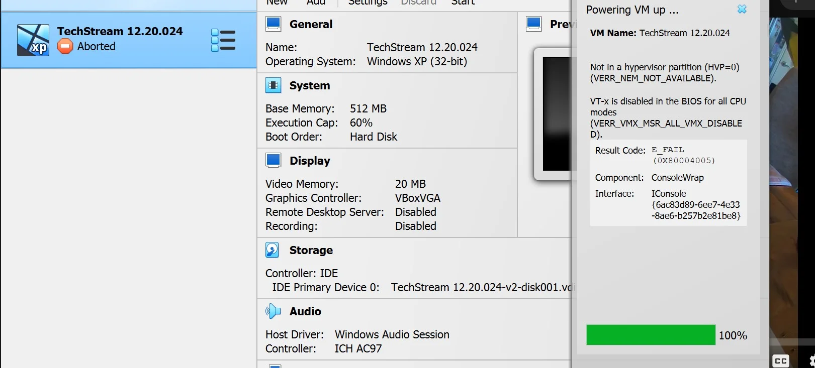

All day to only arrive this this point: I've downloaded VM and TS from page 1 on to my W10 laptop. When I hit start in the VM to open TS, I get the following error message on the right:
I've turned off audio settings in VM as I've seen mentioned here, but still haven't figured out the trick.
I've found this error mentioned a few times in the thread but haven't really seen an answer. I hate to just post up a blunt "what's the problem?" but I don't have the capacity to go through 70 pages of this beyond searches. So, anyone know what's my problem?
I also tried downloading an older (v6) version of VM, but that won't even import TS at all without an error.
