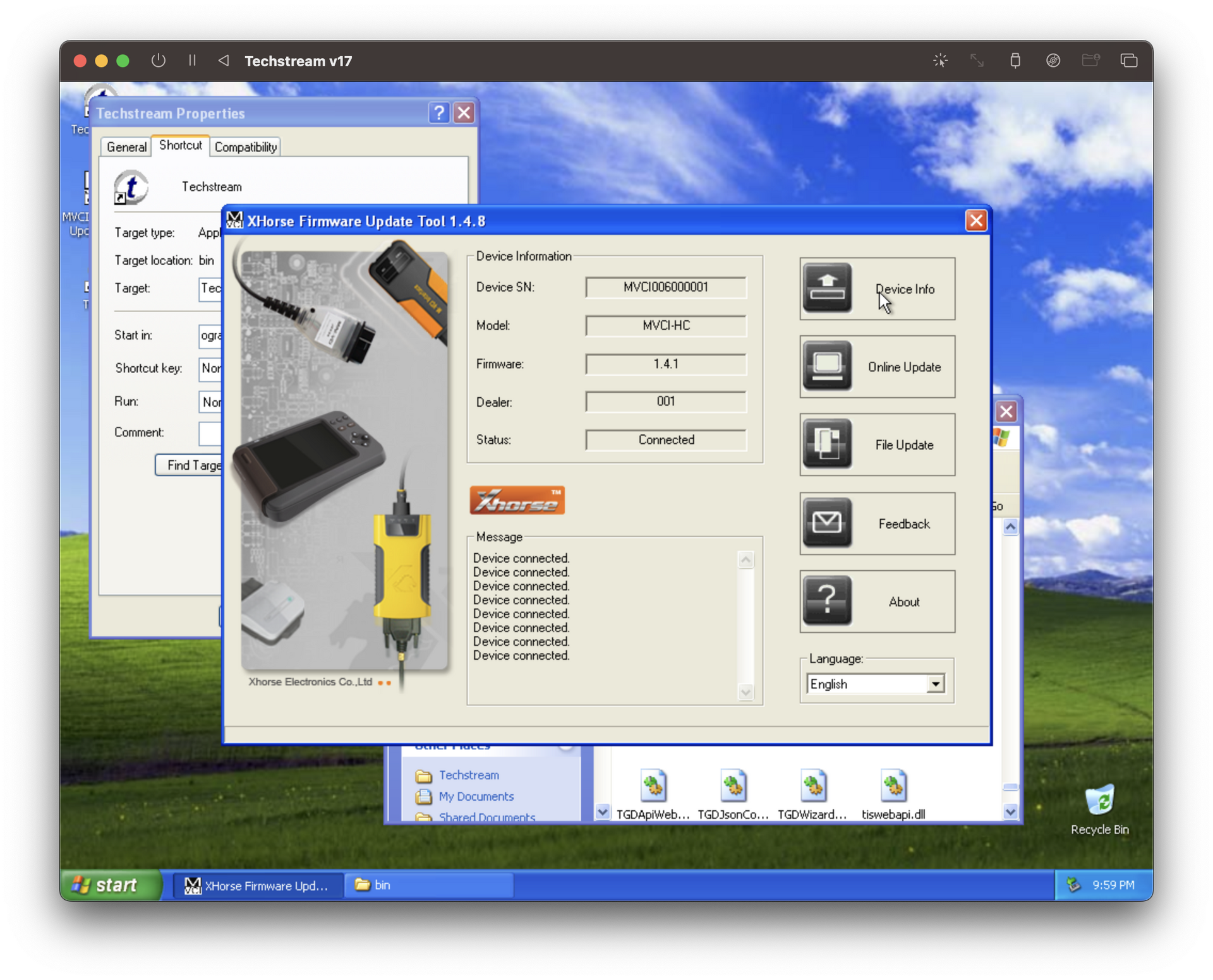

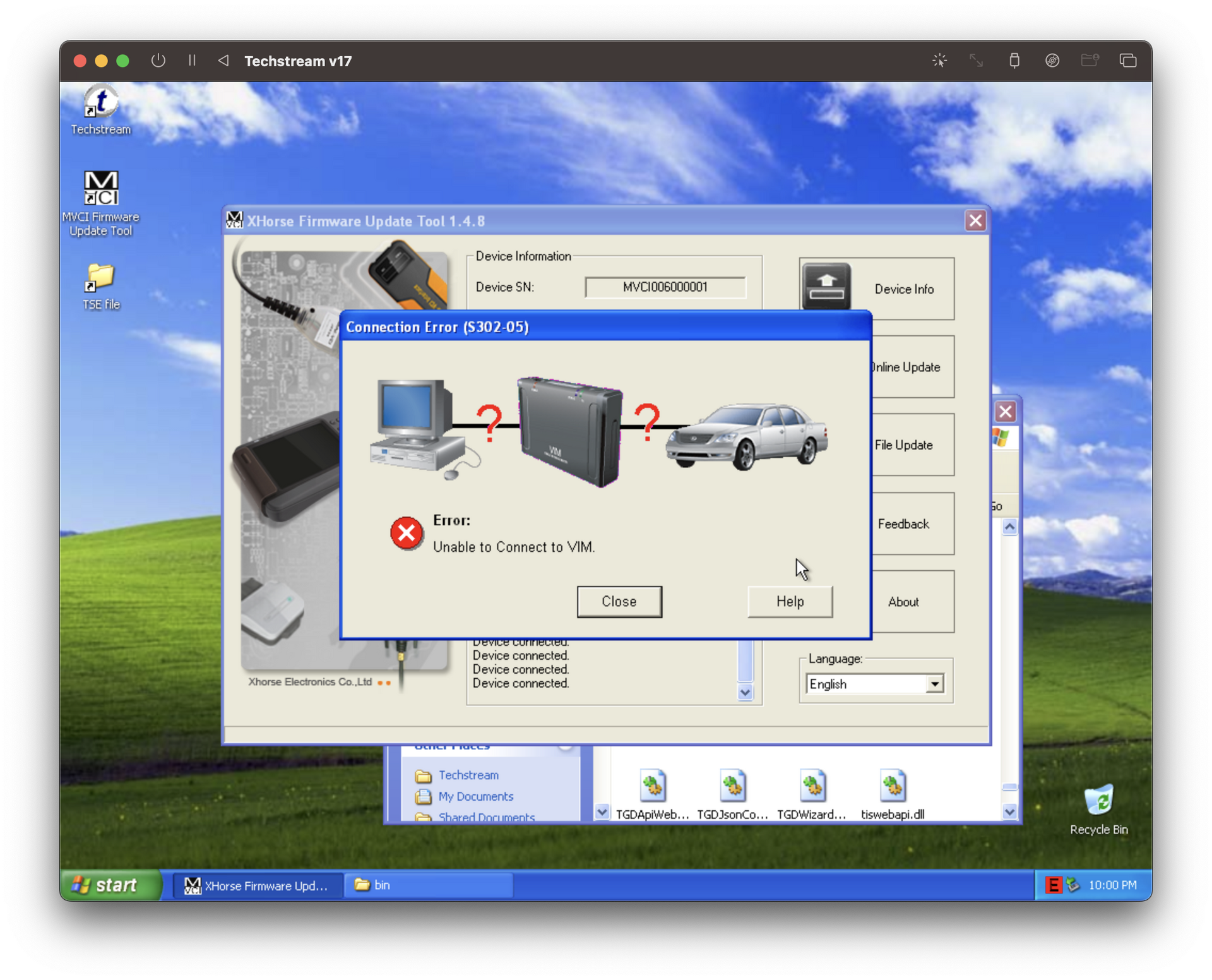

If anyone made a breakthrough on an M1 Mac using UIM and the imagine in the first (updated) post let me know. I can get the XHorse tool to recognize my USB cable (one I've previously used successfully with VirtualBox on an Intel Mac a couple of years ago) but it's giving me the Unable to Connect to VIM error message.

Not on a MAC but I remember I had to play around with the firmware tool. In techstream, change it to a different VIM setting, reinstall the firmware, change it back to right one. Possible run the firmware reinstall one more time. Good luck!!
I decided to stop trying to get the M1 Mac version to work and instead just purchased a cheap PC laptop and it works a charm!

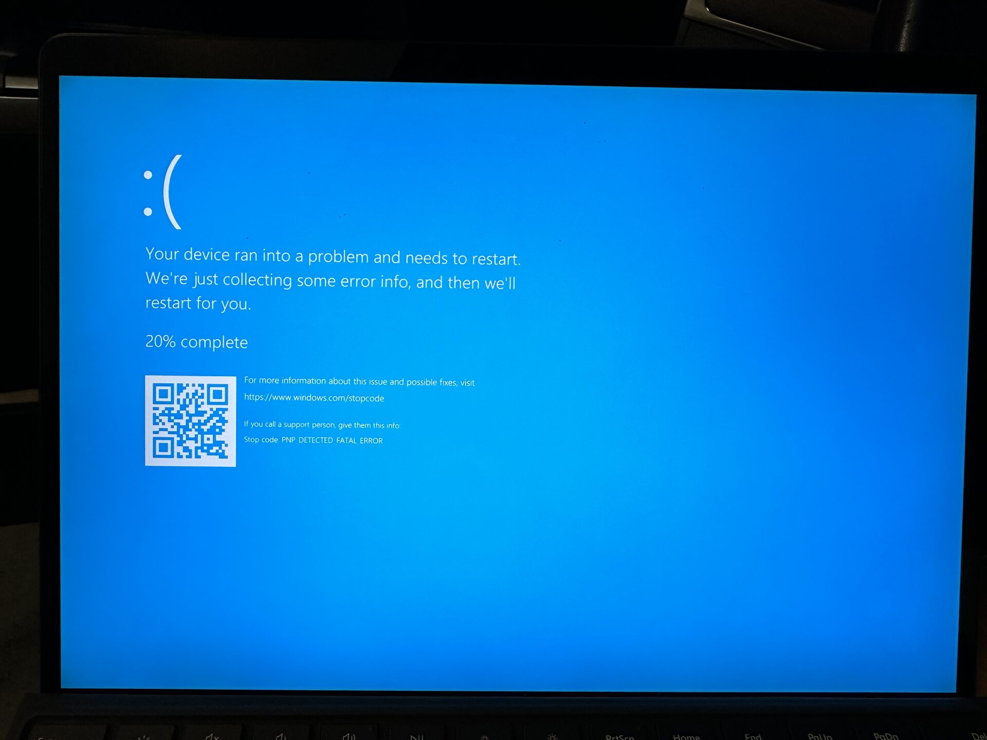

I got it all working after a week of bashing my head against a wall and now the usb ports on my computer wont pick up anything I plug in including the cable :(
