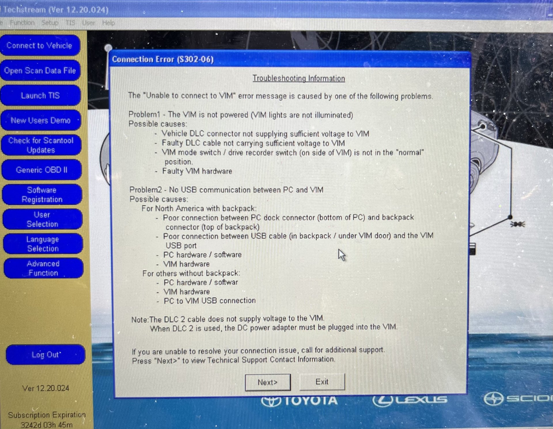

I opened up Techstream and selected “connect to vehicle” it says it’s unable to do so (I have attached picture of the issue)
The MacBook Air doesn’t come with a USB, just a micro USB so I have an adapter to accept the USB
I believe I have saw others using MacBook Air and had no issues? Is this correct?

I'm pulling out what little hair I have trying to get Techstream to launch. I keep getting stuck at "Unable to Connect to VIM". (Screenshot below)
UTM & VM install fine. I can connect to the USB. I can get Xhorese to recognize the cable but I just can't get techstream to start.
Absolutely nothing works.
  • I'm on a 2021 M1 Macbook Pro.
  • Using UTM Techstream v17.20.utm uploaded by @getco a couple of days ago
  • I also bought the cable from @getco
I'm sure I'm missing something simple. Any help or advice would be much appreciated.
