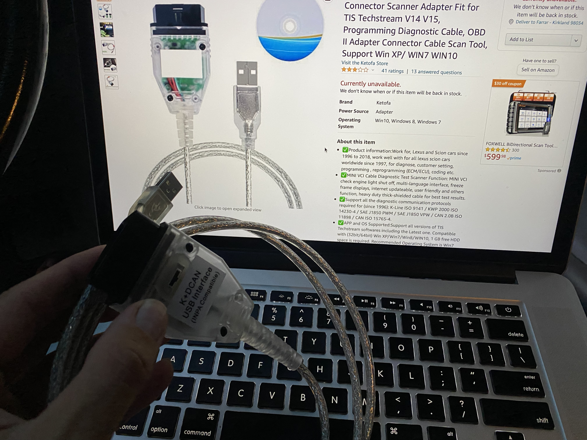

and boy, no matter what I tried it would just not work. I tried multiple laptops, multiple USB cables, nothing. Funnily enough it worked perfectly in my ES300h but not in my 100 series nor in my 120 series prado.
Having given up all hope on making it work, I then ordered this:
And it worked out of the box. First try!

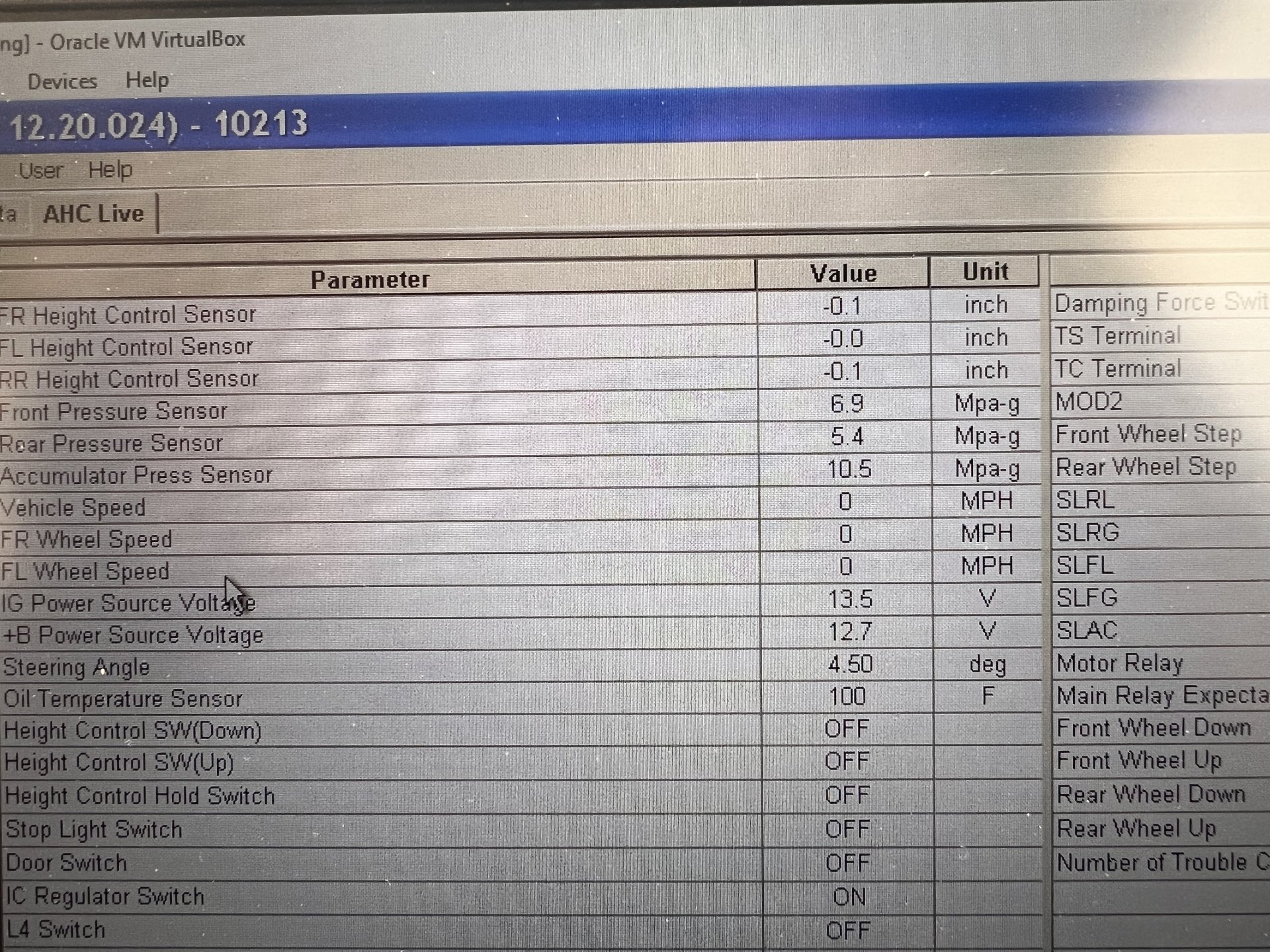

In case it helps out someone else, I have a 2004 JDM LC Cygnus and it worked when I selected the USA version of techstream and chose LX470 from the menu. It connected with no errors and I was able to get the AHC data :)

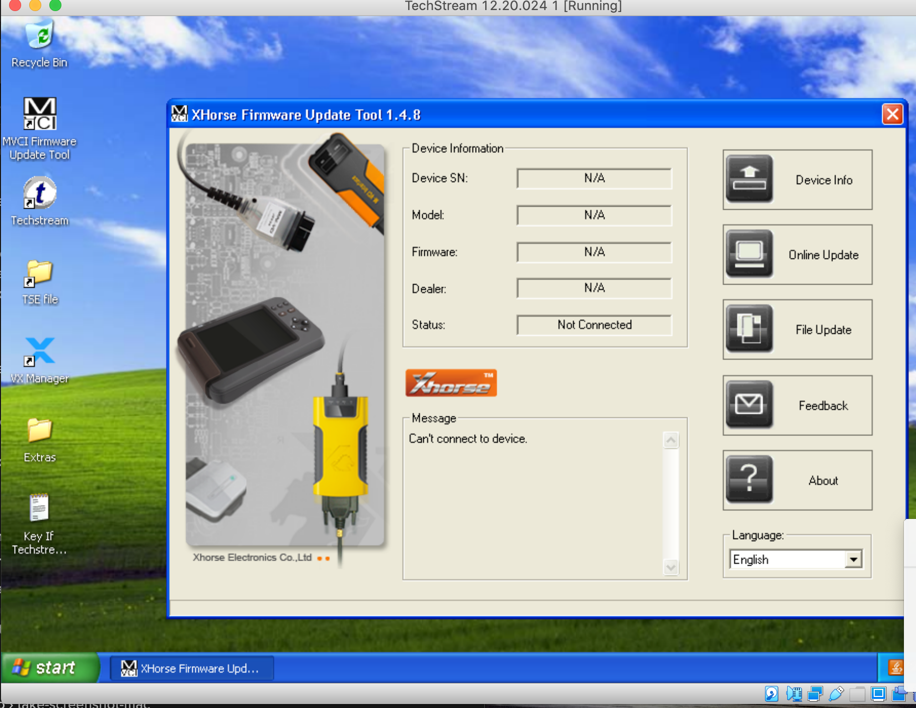

Every folder is super tiny, almost impossible to read. Anyone know how to make windows appear bigger in windows XP screen? I tried in the control panel display under DPI but it didn't work. Running off of Mac. Thanks
Check the settings for virtualbox for a retina mode or something similar. XP will try to render at the native resolution

Should just be a mini-vci J2534 cable. I just ran into an issue with VB not recognizing any USB I plugged in to it. Uninstalled and reinstalled, restarted, anything I could think of but none of it was working. Did you verify that VB was recognizing your USB cable?
What eventually worked for me was removing the TechStream plugin from VB, then uninstalling VB by using the uninstall tool included in the .dmg that was used for the initial install, restart, reinstall VB, reinstall TechStream plugin, restart, launch everything and it worked.
ETA: Don't fool around with a bluetooth or WiFi dongle, just get a corded Mini VCI to USB and plug that in once everything is updated and restarted. Should work fine.
