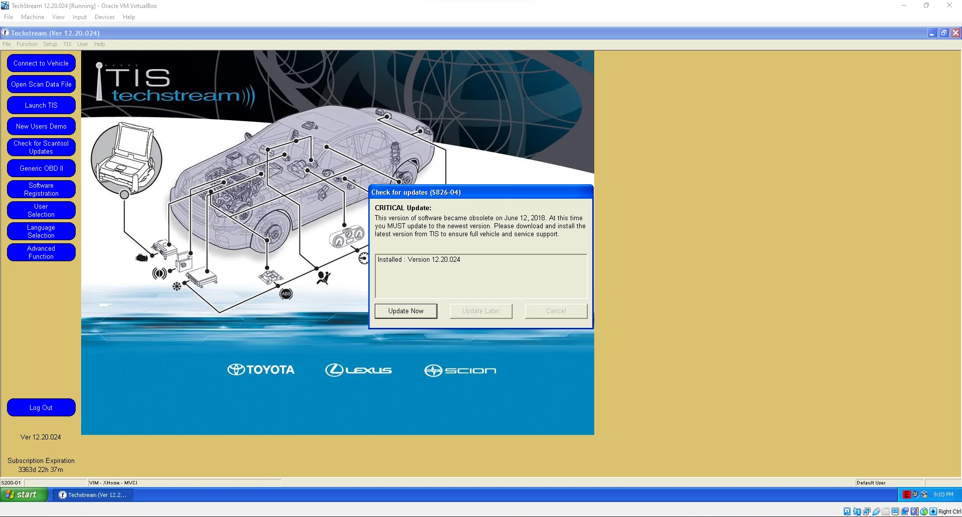

Does the update just include a newer version of virtualbox or Techstream itself. I tried to use on my 2020 Tundra and the newest model year available from the dropdown is 2018.
I assume this error is what is causing the problem. But I don't know if the newer version of the software will just break my installation.
