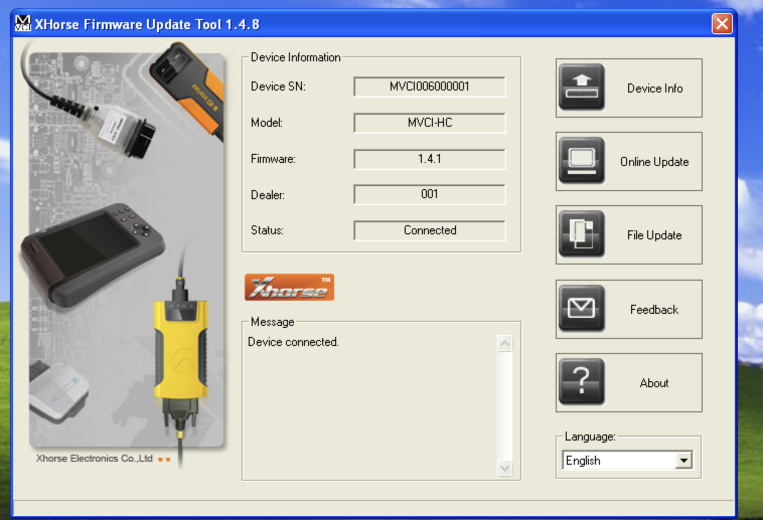

1. You need to make sure your cable can be seen by Windows. Make sure the USB device is mounted in VirtualBox settings: VirtualBox -> Devices -> USB -> Select your cable (mine had M-VCI or similar in the name - via USB-C adapter). Windows will beep you once it's found it.
2. Make sure that you selected the proper VMI in Techstream: Setup-> VIM Select -> XHorse MVCI.

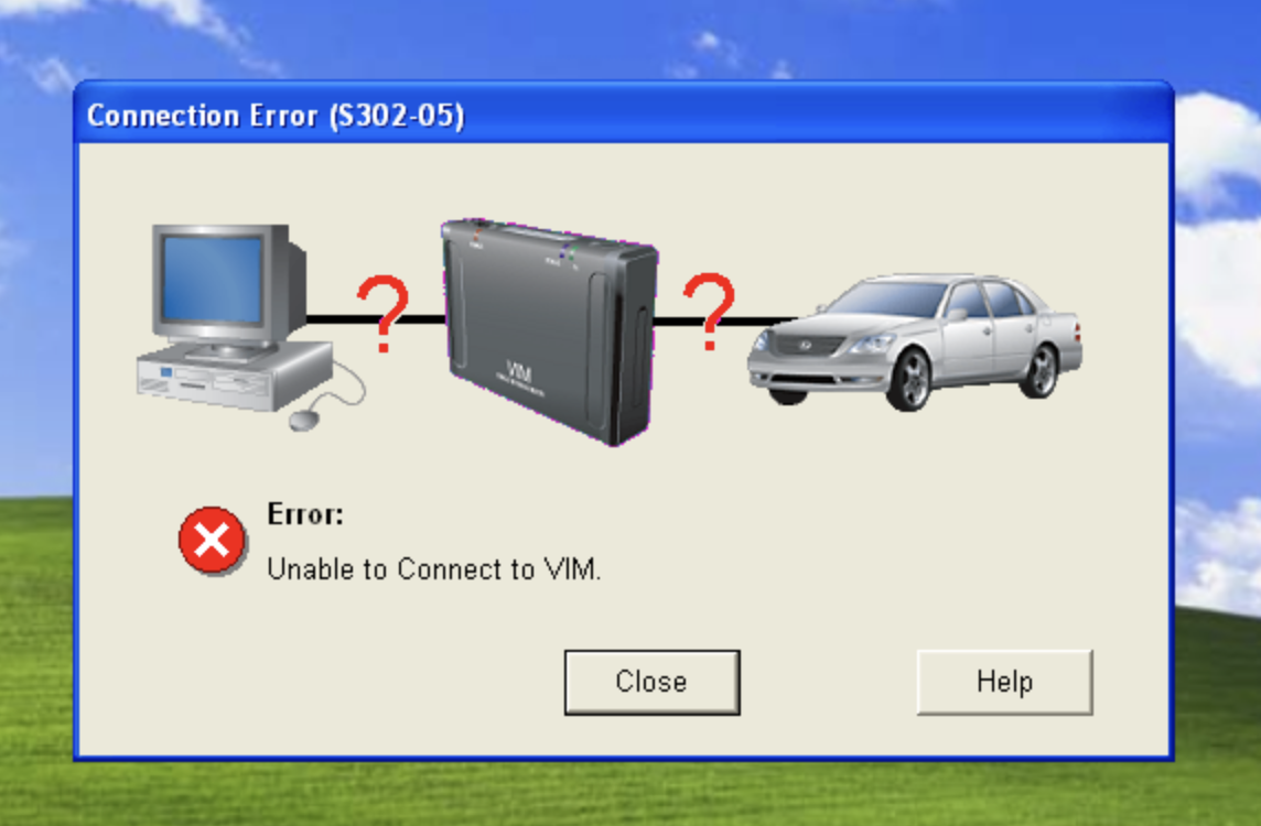

Same setup as you, did you get this to work? I'm still stuck at "unable to connect to vim".
check the posts around #615
I had a similar error message. For me, the VB needed to recognize the usb cable before trying to connect to TIS. this error screen happened to me when entering into techstream too quickly before hearing the audible usb connected ding - lower right hand side flashing usb device - or checking the connection with the MVCI Firmware Update tool.. make sure the usb connection is good before starting TIS in VB

Thanks! I ended up using a Windows laptop instead of my MacBook Pro and it now works fine.
(On my Mac I can see the USB with the Firmware tool, etc. I hear the chime, see it in my taskbar. I just couldn't get it to connect.)
