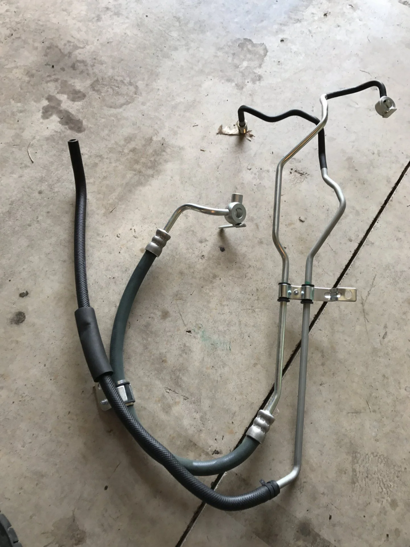

Update, I found the aftermarket hose from Sunsong on e-Bay, PN 3402991. It came yesterday and I put in this morning, pic of the new hose below. It seems to be of good workmanship and had all the right bends in all the right places and fit with no problems. Best of all, it cost me 35 bucks...hopefully it lasts a good long time. Here's a pic of it as received.
......replacement hoses from Rock Auto. I went with the Sunsong lines, others have used these on the forum. The lines showed up and were honestly good quality. Everything lined up and works great, I couldn't justify spending another $600 on new OEM lines.
full
The 03+ line won't fit in terms of length... its supposed to make a loop through an oil cooler first. I bought the Sunsong 1998-2002 version and it fits very nicely as a replacement... just installed it a few days ago. Steering feels new after an alignment... I was way out of spec.
