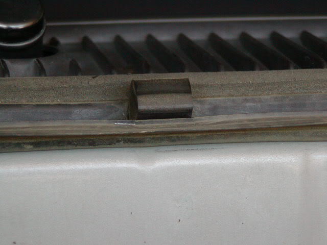

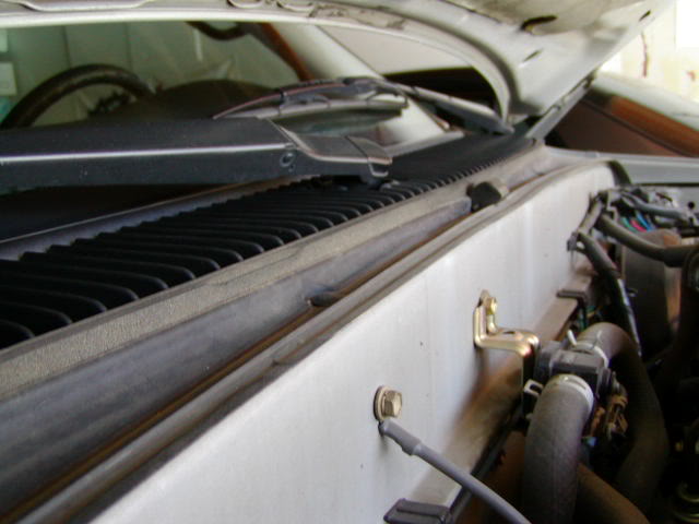

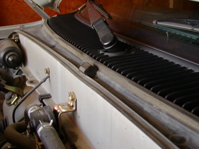

is slight flutter nearer the cowling at the windshield ?
I had issue with that on muh '00 xcab
their was a service dealer listed instruction regarding muh junk..
maybe effects your model as well
the fix has something to do with replacing the plastic cowl with a later year's model. As the later dated part would included a bumper stop inserted into the plastic cowling
I made my own fix... still holding fine
