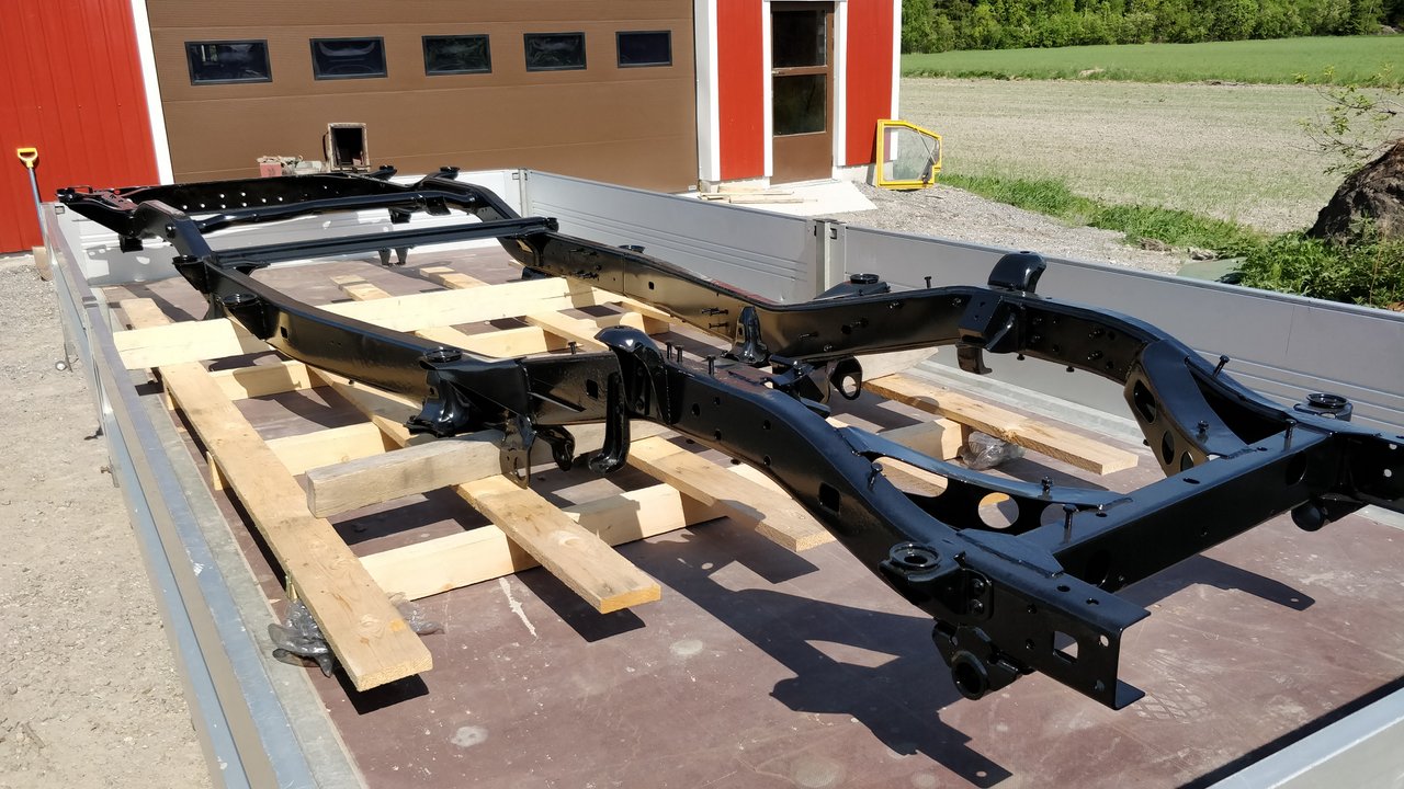

Well one waypoint achieved and I got the frame home from the painter. It looks brilliant.

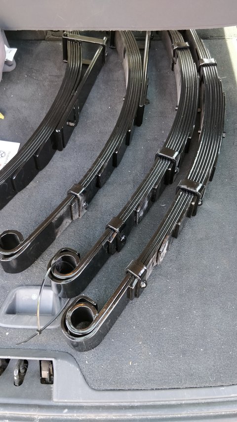

Also new leafs got paint on them.

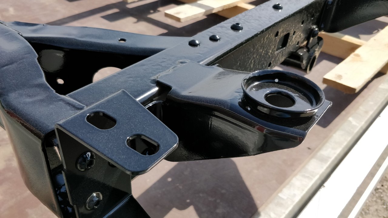

"Self made" bumper brackets fits and looks good. I really like the paintjob.

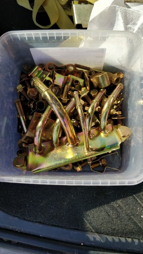

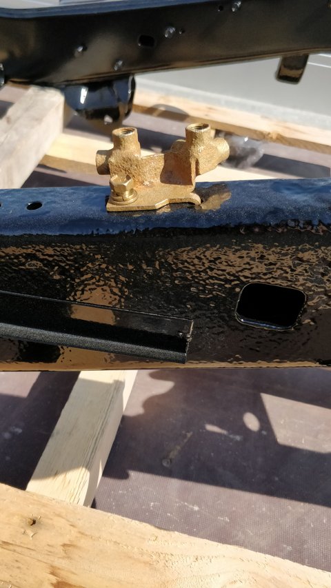

I also had some parts yellow zinc plated. They said rust is not a problem on parts, well everything did not come off in acid bath. But I think they will work under the car just fine.

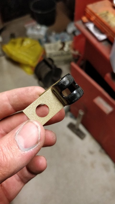

Some of the brakeline brackets came without coating on them. So I sprayed some paint on them. I used as topcoat some carburetor refurb spray that I thought would look like yellow zinc. Well it does not. But at least they have some paint on them.

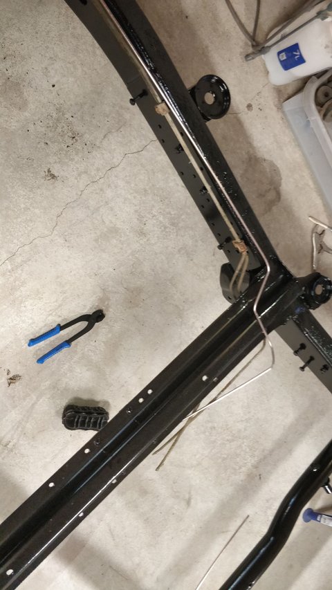

Allso tried to bend some brake lines. Needs a bit practise but at least the pipe straightening tool and bending pliers work like they should.

Also had some parts in zinc and yellow zinc. Some of the parts in last batch went on a second round. I could not live with the rust spots that were in them. This time I soaked the parts in citric acid over night and removed remaining rust spots with Dremel. So this time the parts were spot on. Also diy brackets were zinc coated.

Then it was time for the brake lines. I was a bit afraid how it will turn out. First try went bad on first bend. I had the pliers wrong way. Second attempt looked like this.
Then after couple more tries I managed to make a decent one.
Longer line was good at the first try.
