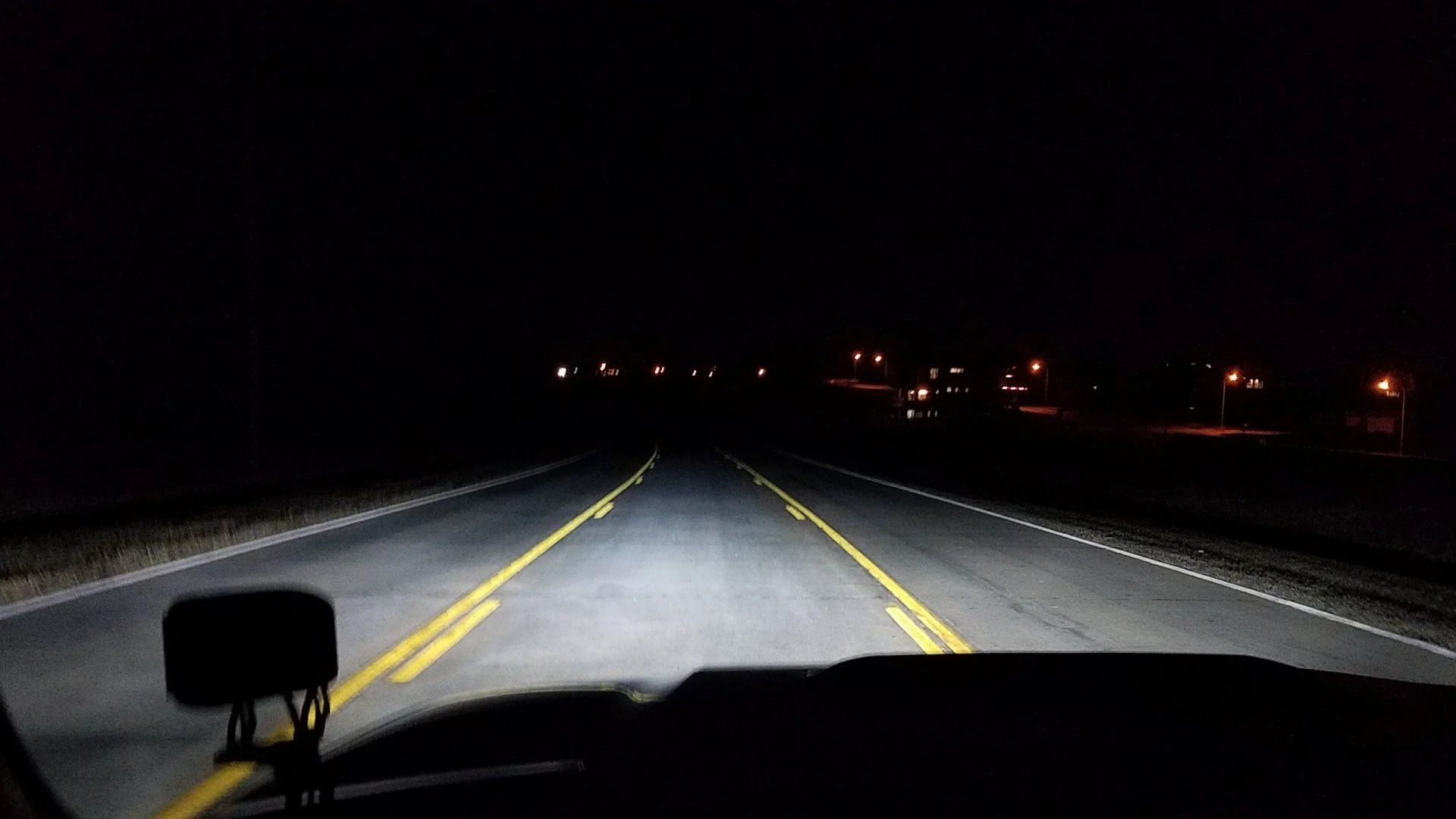

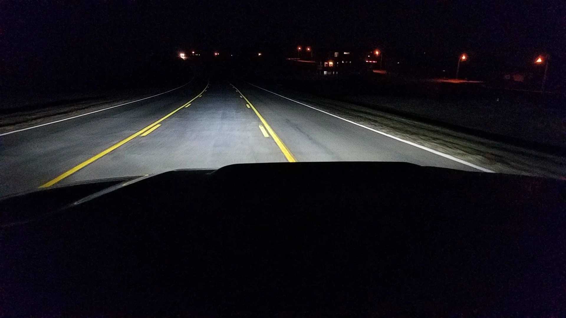

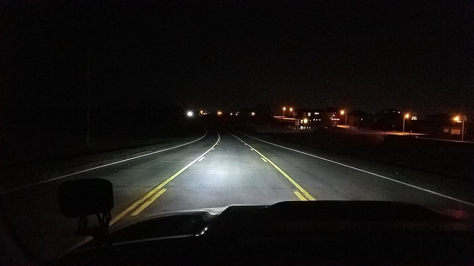

For my 4Runner I went with OPT7s for high beam and fog lamps, Xenon Depot formmy low beams. My fog mights alone light up the entire area. Low beams are meh...but I have plenty of Rigid lights around my truck to light up the area. Just food for thought...OPT7 for your fog lamps should help a lot bruv. 🤙 I will follow up with pics for FYSA.
Here's a few pics...first and third are with my fog lights on, second is without the fog lights. 🤙
