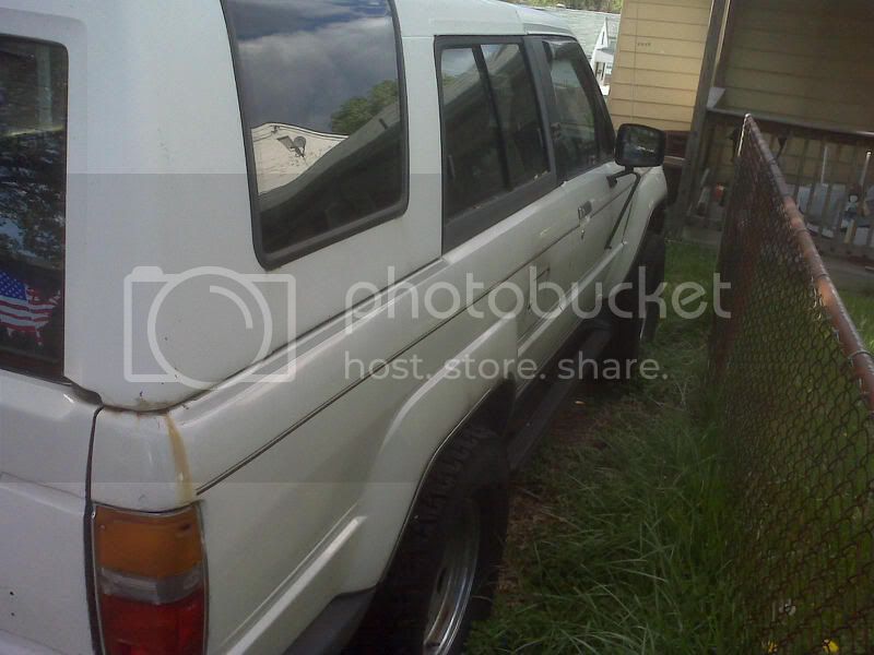

Hi hows everyone been awhile. Havent been wheeling much since i got rid of my fj62. My suburban to big for any real trails. So i finaly broke down and bought the 4runner my best friend been trying to sell me for the past 5 years.
its got new muffler tailpipe. rear brakes think it has new front brakes. new alt, has 32 inch 11/50 tires on it. 22re motor. acording to the tag underhood it has the a340h transmission. It has a issue with the trans. says it takes about 5 mins for it to warm up and then shifts fine. So im in process of trying to figure out whats the cheapest and easyest swap i can do for a trans. Should i swap to a manual? Swap to a difrent modle a340? Or should i go with a aw4 out of a jeep use the a340 bell houseing on it? I no i would need new or custom driveshafts but what else would be needed if i swaped to the jeep trans and transfercase? how difrent is the wireing? any things i should no any hel[p info tips be great thanks. O yeah its a 86 4runner
