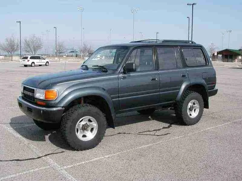

Hey Jody - Is this your old 80?
MoJ
Moderator
Oct 24, 2003
213
4,593
Had this pic around, believe it came from the mud for sale section awhile back. I was thinking it might be yours. If so - Do you remember what OME setup you were running? Tire size?
Gracias,
Jason
Yep, that's my old 80 that lives in Houston now-a-days.
OME 850/863 "heavy" kit w/ OME shocks and Mr. Gasket 1" rubber spacers on the front. Also installed the caster correction bushings.
The tires are Kelly-Springfield Safari MSR 285/75/16.
An excellent setup. Looked good, rode good and handled good steering-wise.
