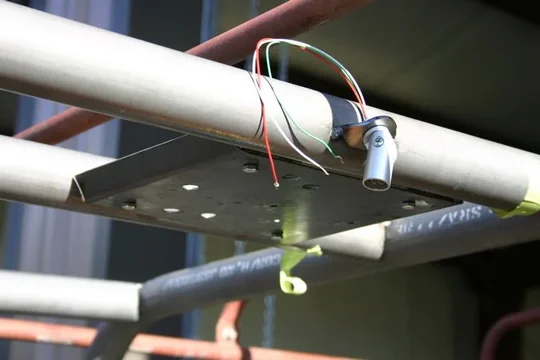

Here's the panel. I'll talk about the "switchology" in a second... It is removable, I just welded tabs onto the cabe spreader bars that it bolts into, for ease of maintenance.
And here's two pictures of the lights and switches installed in the panel. The center button is square, and turns the dome light on and off. The round switches are used to control the spot lights. I painted the buttons on two of the switches white, so to turn on the white spot light you press the white button, and to turn on the red spot you press the red button. You can have both on at the same time if you choose (don't know why, the white overpowers the red, but it's easier to wire this way anyway).

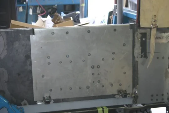

I fabbed up most of the tailgate door today. Pretty slick really.

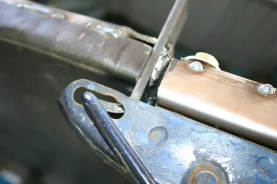

I had to cut up the gate I made earlier and make it just a little skinnier, and then I cut out a piece of 18GA to skin the gate. Then I got to making some hinges for the thing. Here's a few pics of that process...
And a closeup of the hinge I made. I made it out of 1/8" steel, so they should be PLENTY strong.

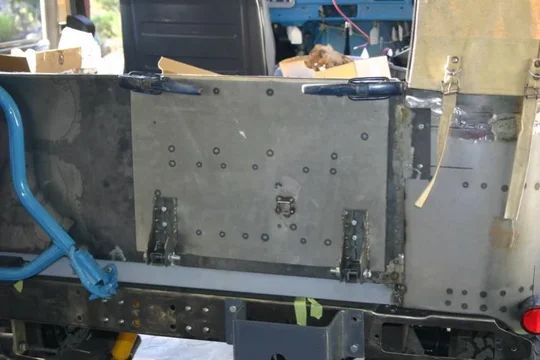

With the hinges done, I bolted the latches back onto the gate, and bent up some strip steel for the catches. I then cut slots in the fixed portion of the tailgate, and welded the catches into those slots for the latches to catch. (I think that makes sense). But the pictures should explain it pretty well...
With all that done, here's an overview of the tailgate. I still need to mount the license plate on this, but it's pretty much done.
You can see in the center of the gate is a small bit of steel, that's a fancy little piece that rests on the bumperette to support the gate if you put weight on it (instead of just letting it rest on the sheet metal. I will weld a cap on that notch, just so it's not two edges resting on the bumperette and scratching it up, but overall: I'm pretty happy with the tailgate. I'm kind of impressing myself with how tight it closes. It'll get a little weatherstripping when it's all said and done, but mostly to make sure it doesn't rattle than to keep water out.

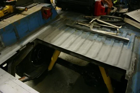

So, the last of the real bodywork it needed is the bed floor is rusty. I'm talking about pitted, cancerous rust that a PO apparently cleaned up, and then sprayed a TON of paint and bedliner on it, and sort of kept the water out--sort of.
Either way, I cut it up today.
Here's the before picture: the worst of the rust is on the left.
Oh look, a huge gaping hole.
And here you can see a section cut out of a donor 40 (thanks Paul!) that will be used to "terminate" the ribs so it won't look funny when I make a flat floor section for the lid of the tool box that's going to go into that huge hole...
