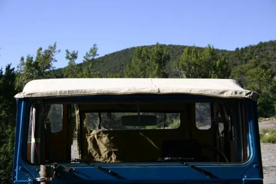

And the front.
Which leads me to a question: Is the windshield channel curved of straight? I'm sure that it attaches along the curve of the windshield, but does the soft top get a straight edge, or a slight curve to it?

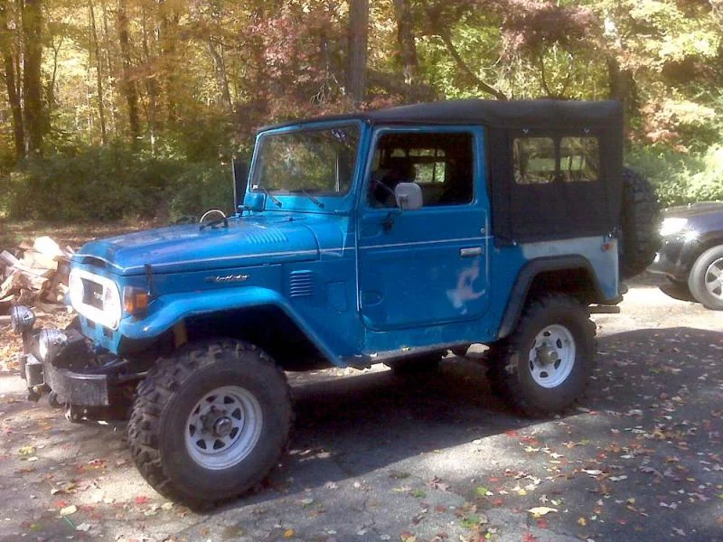

Answering my own question....
All pics stolen from https://forum.ih8mud.com/40-55-series-tech/247086-post-pics-your-oem-reproduction-top-fj4xs.html
attachment.php
And one more, but with the later model windshield (with the washer motor on the bottom)...
attachment.php
So, to put it simply: curved. I wish I wasn't so groggy last night to have not thought of searching first. ;)

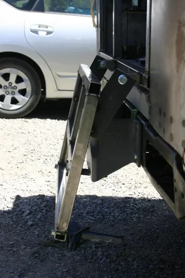

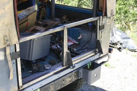

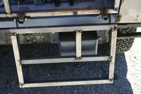

So, I did get a good bit done on that tailgate after all....
Here's a simple frame for it, with some temporary hinges welded onto the door to see if it works out (teaser alert: it does).
Then I kept adding more stuff to it. I need a bit more internal support, so I added some of that. I also drilled and bolted on the latches I intend to use (from an old Toyota Hilux pickup).
Two more pictures.
This is how it opens up. Note the angle (and the fact that it rests on the bumperette). Those two things will be key in the near future.
OK, that's all I have time to post today, but suffice it to say I'm liking how this tailgate is coming along. I think it will serve Dad's needs nicely...
Dan

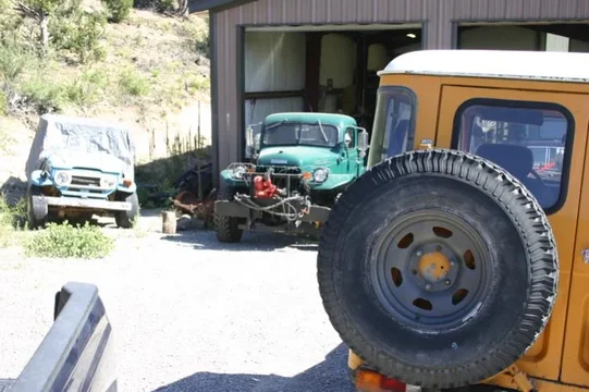

Before I get to the other pictures of some stuff that I fabbed, I thought I would simply inform you all that sometimes I simply win at all that is manly. Last week was like that. These are two separate days around the shop. In our shop is a friend (source3)'s 1973 FJ-40. It's getting the 2F that came out of Dad's 40. Look carefully, you can see it in the shadows of the shop. It's green (and VERY clean and rust free). The yellow one outside belongs to Bad Mojo, who was up helping with the work on the green 40, as well as checking out Dad's 40. The Dodge was just in the way. ;) It had to go outside so I could replace the timing belt and other PM on the faux lux.
