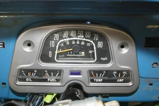

But, with the truck's harness completely tied into the battery, I was able to test a lot more things....
The stock gauges work perfectly (at least the oil pressure and water temp). See how those needles aren't parked? It's the little things...

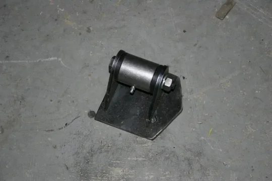

And here's how this will tie into the frame:
These will be welded onto the frame, and then a bar will run from the plates under the body down to these bushing/bolt combinations. That way vibrations from the frame are isolated from the body, and the arms are removeable.

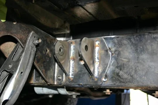

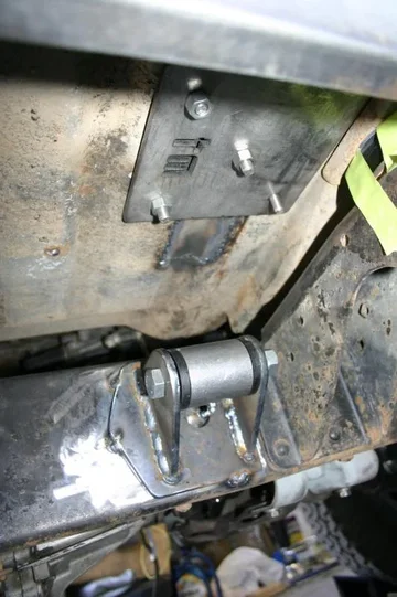

First off, I ground the frame clean and tacked on the frame mount bushings for the cage. Tomorrow I'll actually tie these mounts into the plate you can see in the second picture (which itself is bolted to the actual cage.

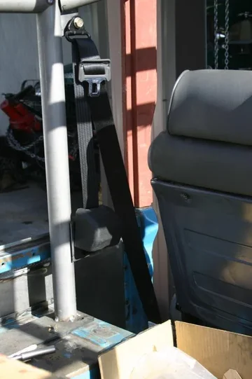

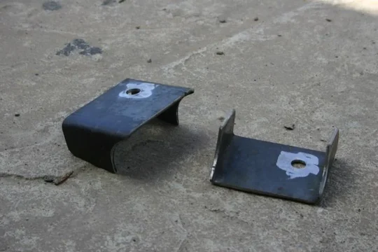

Then I got around to refitting that head-knocking bar. I like the new location a lot better (it's only about 2 inches closer to the B pillar, but it's really hard to hit my head on it now). So with that done, it was time to start mounting the seatbelts...
Starting with the brackets for the inertial reels on the bottom...
Here's the backside of the lower bracket (and the bracket tacked into place).
And then a shot of both upper and lower mounts tacked into place. The upper bracket also doubles as a small gussett for the bar I moved earlier...
And here's the seatbelt installed. Works great. It should, it's in the same place as it was on the OEM roll bar.
