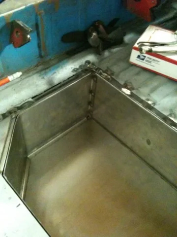

Here's the sides all done, and the floor set in place. Amazing how just that floor makes it look so much more "finished."

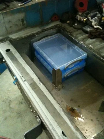

And the left side again. I bought these plastic boxes from the office supply store. They are roughly 10"x13"x2 1/2." These two should be able to hold a small socket set, a set of gear-wrenches, pliers, and the other essential tools. I'm all about efficiency of space here, and keeping things from rattling around is always a good idea, IMHO. The tools will be shadowed with foam inside those boxes too.
