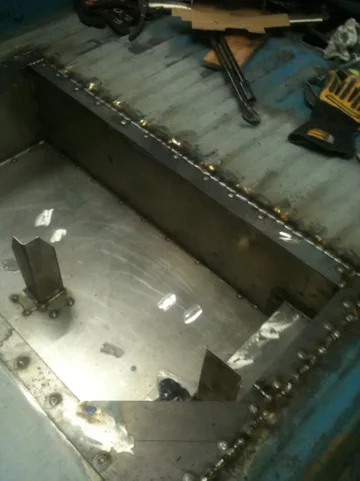

Today I finished cutting the lip I just talked about, which also will finish the floor of the bed. I just got it thoroughly tacked before I ran out of time today, but that's all right. It's almost all virgin 16GA metal, so welding and smoothing the seams should go pretty quickly next time I get to work on it.

Still finishing up the toolbox, but I finished the welds putting it into the floor, so all that's left is to grind these down smooth...

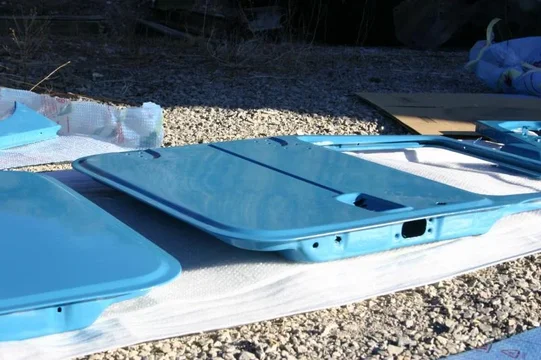

So, everything except the tub itself, and the soft top tailgate is back from paint. Dear Lord it's beautiful!
The camera batteries died before I could get much more than these pics, but suffice it to say we've got glass in doors and it's sliding and everything! Very, very cool.

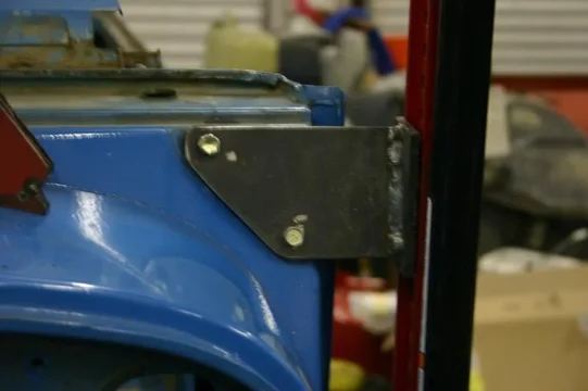

The hi-lift mount. Simple, strong, cheap. ;)
I also made new CB and HAM antenna brackets. Now the windshield should be able to fold down and not hit the antennas. They also match, the left and right sides.

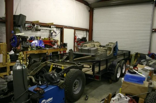

That's right, the tub is on the trailer, ready to head into town for blasting and paint. :bounce::bounce::bounce:
