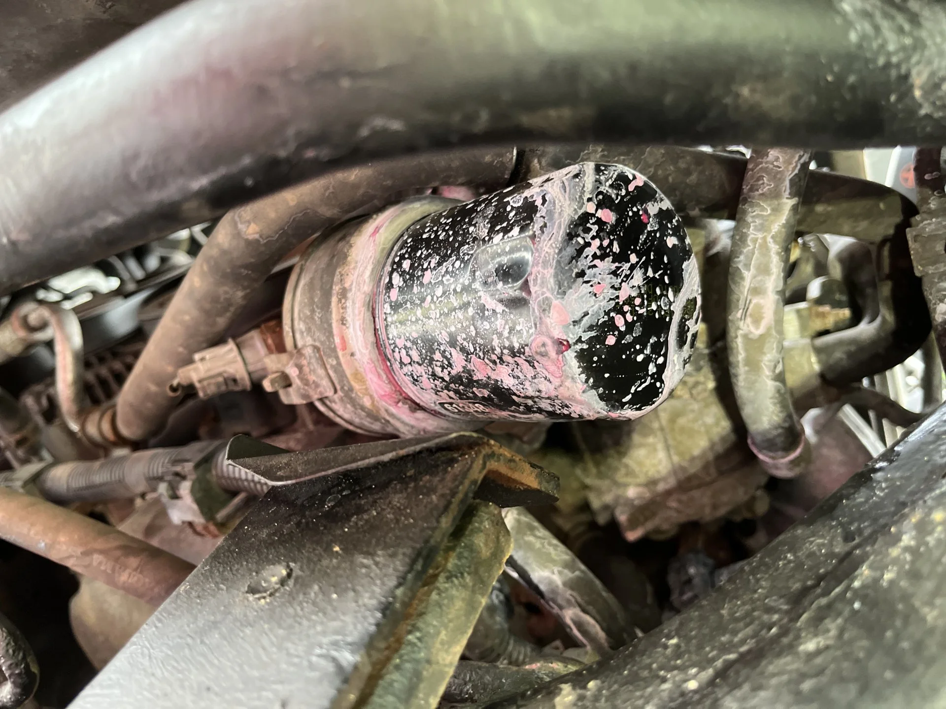

I just popped the hood on my GX and there appears to be two coolant hoses in that area, one from the thermostat area that leads to a metal tube towards the oil cooler (which the filter screws in to), then another from the metal tube too the oil cooler. There must be a return line somewhere too, unless coolant is routed directly back into the block at the oil cooler.
Those hoses are pretty straight; I'd just use some heater hose for them (1 ft should do both, which costs ~$4-5). I would also double-check that the radiator is not leaking and spraying coolant on to your oil filter area, and that the oil cooler itself is not cracked.

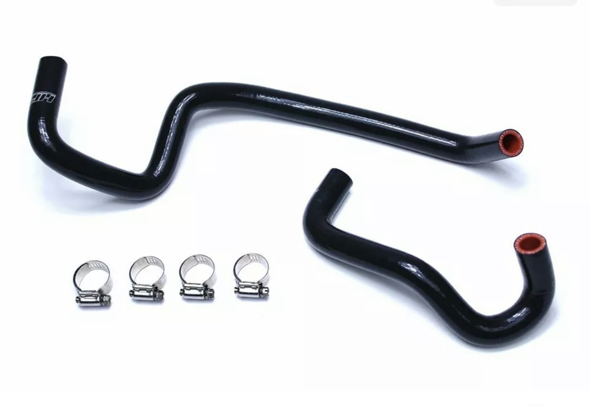

Yes, they are right above the coolant lines. I couldn’t get in for a decent photo. Theirs a company that makes them in silicone. I posted the picture below. I’m thinking I may have to connect more than one hose for the longer one.
Those ones are the upper heater hoses that go from the engine (intake area IIRC) to the heater core and probably aren't the cause of this leak (but would be good to replace if you are doing the hoses anyway).
The little hoses leading to the oil cooler area are just 2-3" long. I'm doubting anyone other than Toyota/Lexus sells them, but you can easily cut them out of a length of hose from an auto parts store. The bends are pretty flat on both of them.
