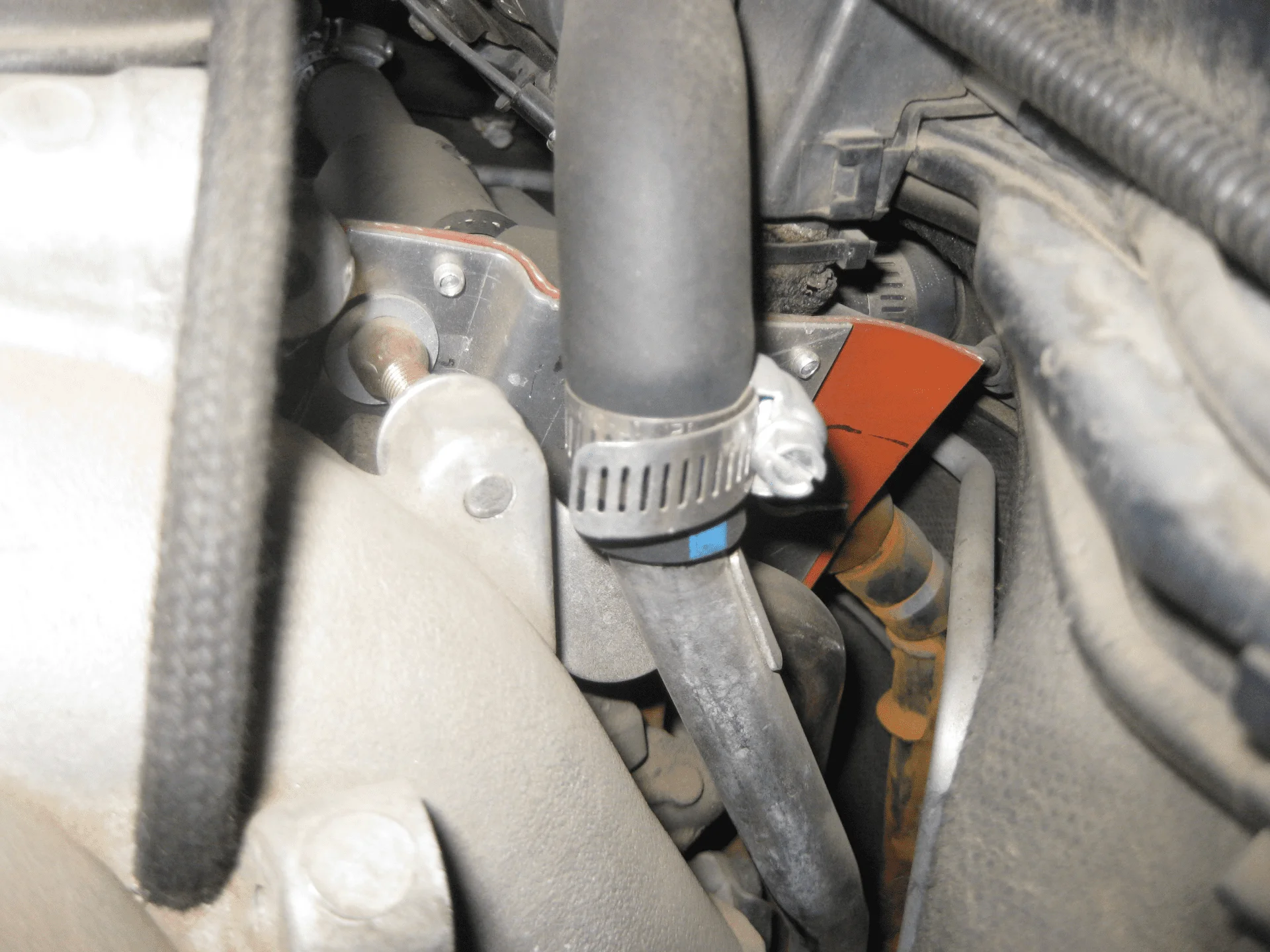

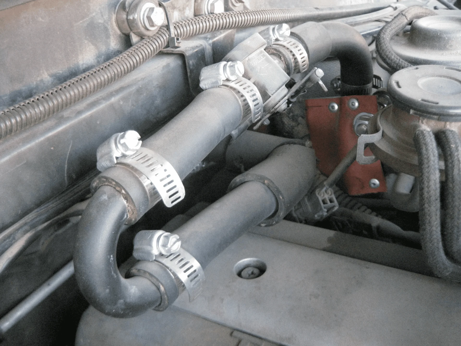

As George posted above they are indeed breeze clamps.

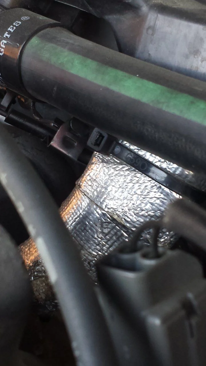

Plastic zip tie still doing its job, 3 years and 45k miles later.
I switched to Gates Power Grip clamps, they are one time use but you can't over or under torque them. I carry the breeze clamps in my truck along with some spare 5/8 hose when I wheel just in case.

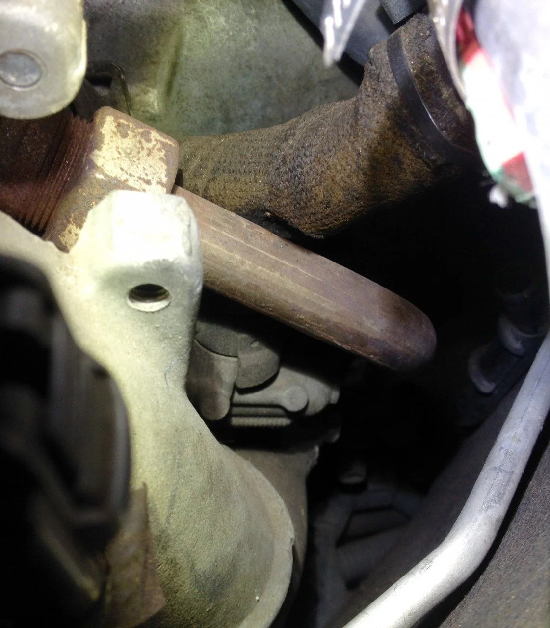

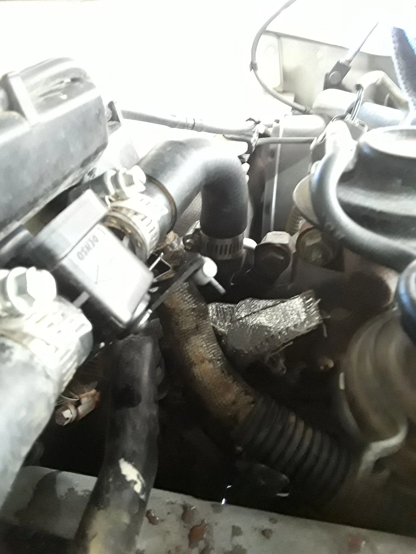

Just noticed this last night:
How are you guys able to get back there and wrap it? I saw the post with the guy laying across the shovel on top of the engine to reach back there, but it seems like so little space to be able to wrap insulating tape around the wiring harness. Are you removing things to be able to wrap that area of the harness by the EGR pipe?
With a pair of wire cutters you can cut the zip ties and carefully remove the old crusty wrapping. I removed the EGR modulator and its mounting bracket for better access. Once the zip ties are removed the harness is easier to manipulate.
Once you confirm all of the wires are ok then cover it up with electrical tape followed by wire loom. Be sure and zip tie the wire bundle so it can't touch the hot egr pipe.
Like others I disabled the EGR with the resistor method and looped the vacuum lines back into themselves. No more code 71, no more hot EGR pipe and no more misfire from burned wires.
The area is hard to reach no doubt. I recall kneeling on the valve cover with a towel folded up under my knee, my feet were over by the air cleaner. Don't put any weight on the radiator.
Not really vid worthy. You literally look at the large bundle of wires running down the firewall just behind the driverside's side of the head. You will see where the wires cross the EGR tube (about 1/2" metal tube) you just take your choice of insulating wrap. I like the DEI stuff and wrap it around the wires so they are insulated from the EGR tube.

Ha, took pix exactly like this a few days back.

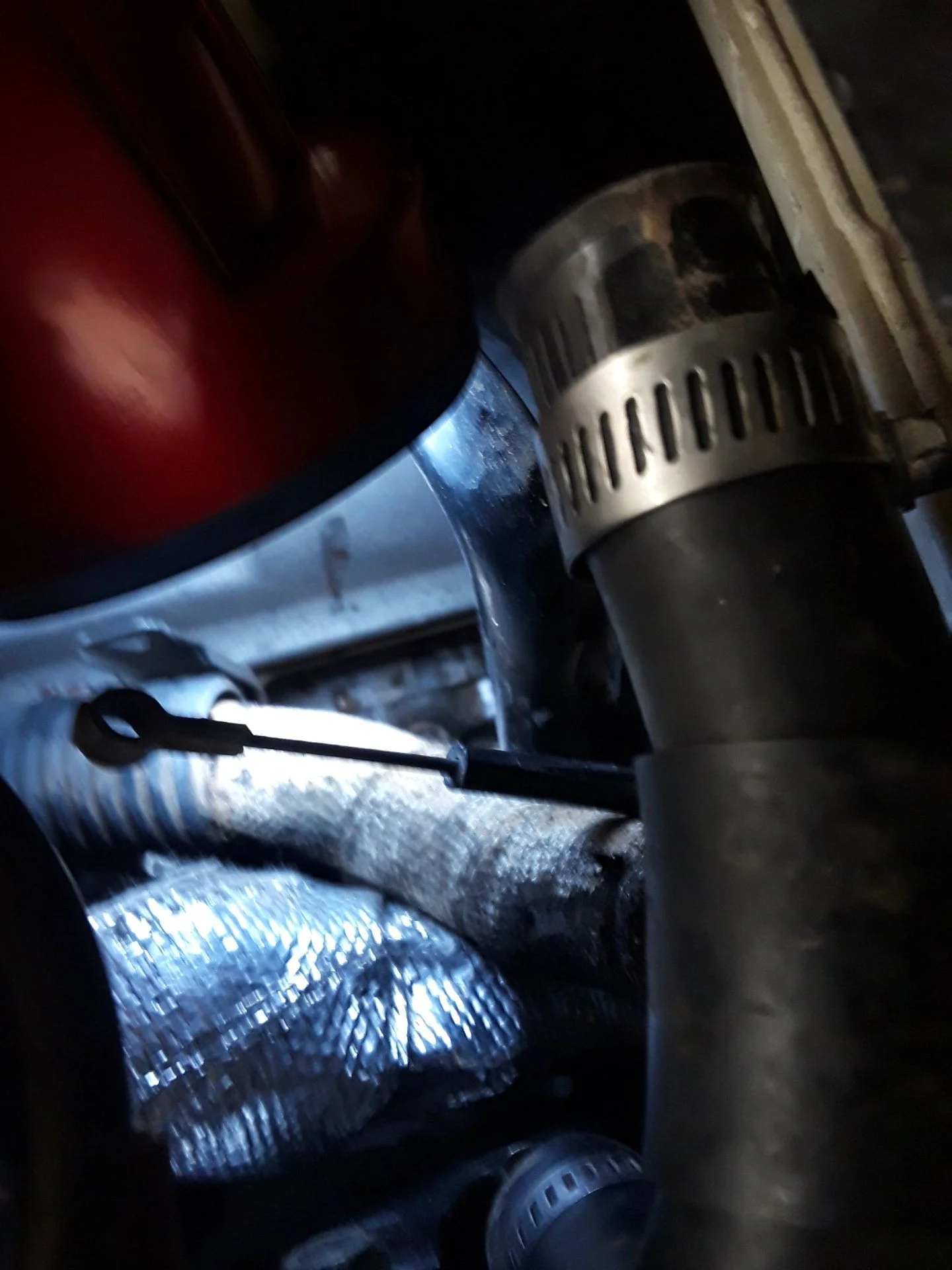

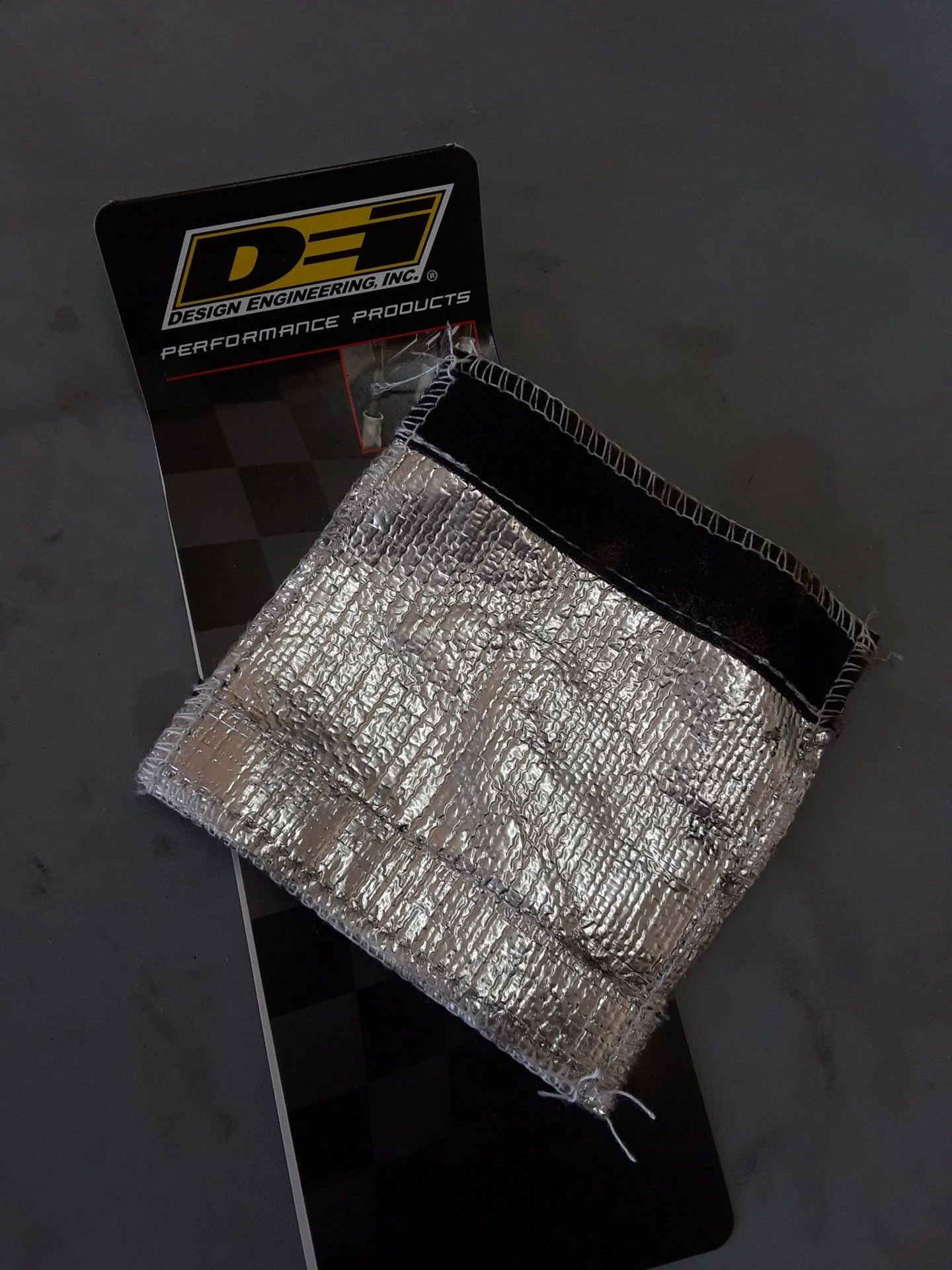

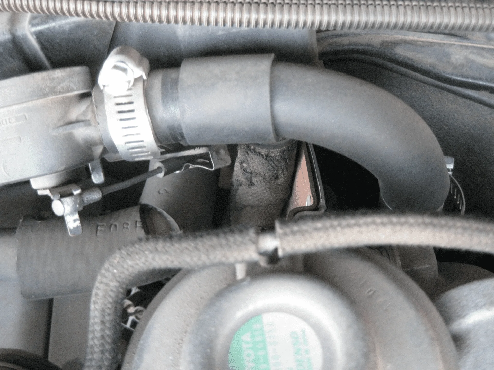

I bought one of these to try. Fits the EGR pipe well. Small size is the one I went with, could probably use the next size up too. It should help buffer some of the direct heat.
I did the install at the same time I was replacing the heater valve to have more room back there to work.
