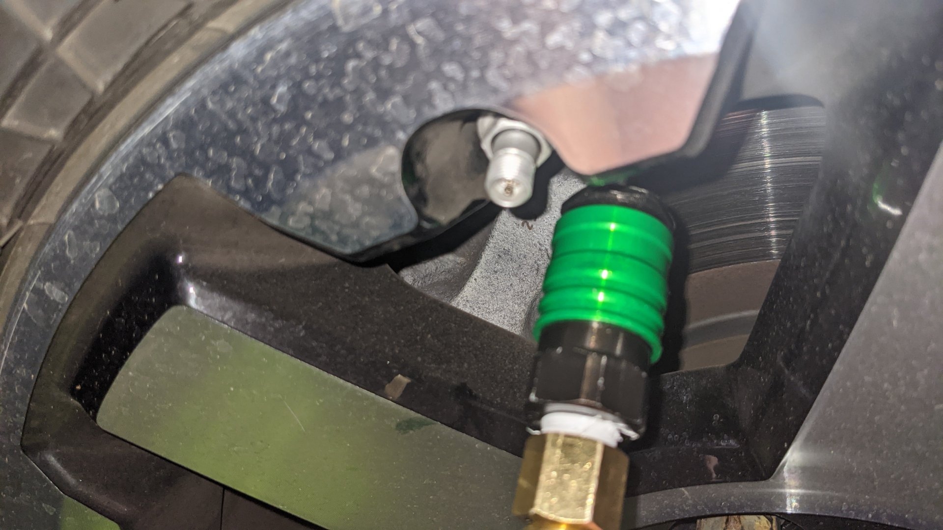

I got one and tried using it a couple weeks ago but it did not seem to work with my wheel. The valve stem seem to be too short with the combination of my rim (from a 4R TRD Off Road) for the air chuck to lock on. I tried buying some valve extenders too but that did not work. I also went to discount tire to see if they can swap out longer stems but they told me that those are the only ones for the tpms. I reached out to Moreflate and hopefully they can suggest a solution.
Hey. Any resolution for this one? I’m running into the same trouble with my setup. The chucks won’t stay locked in and get loose. Thx

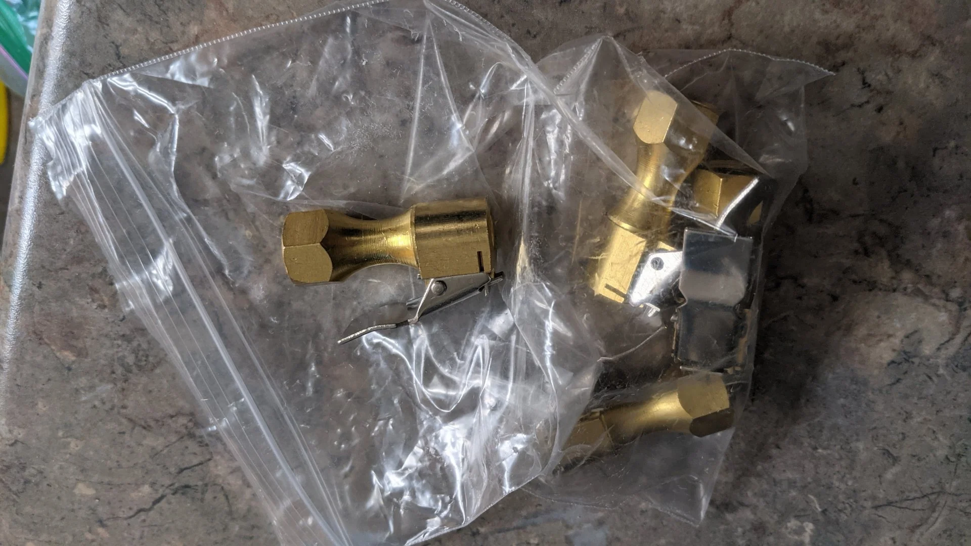

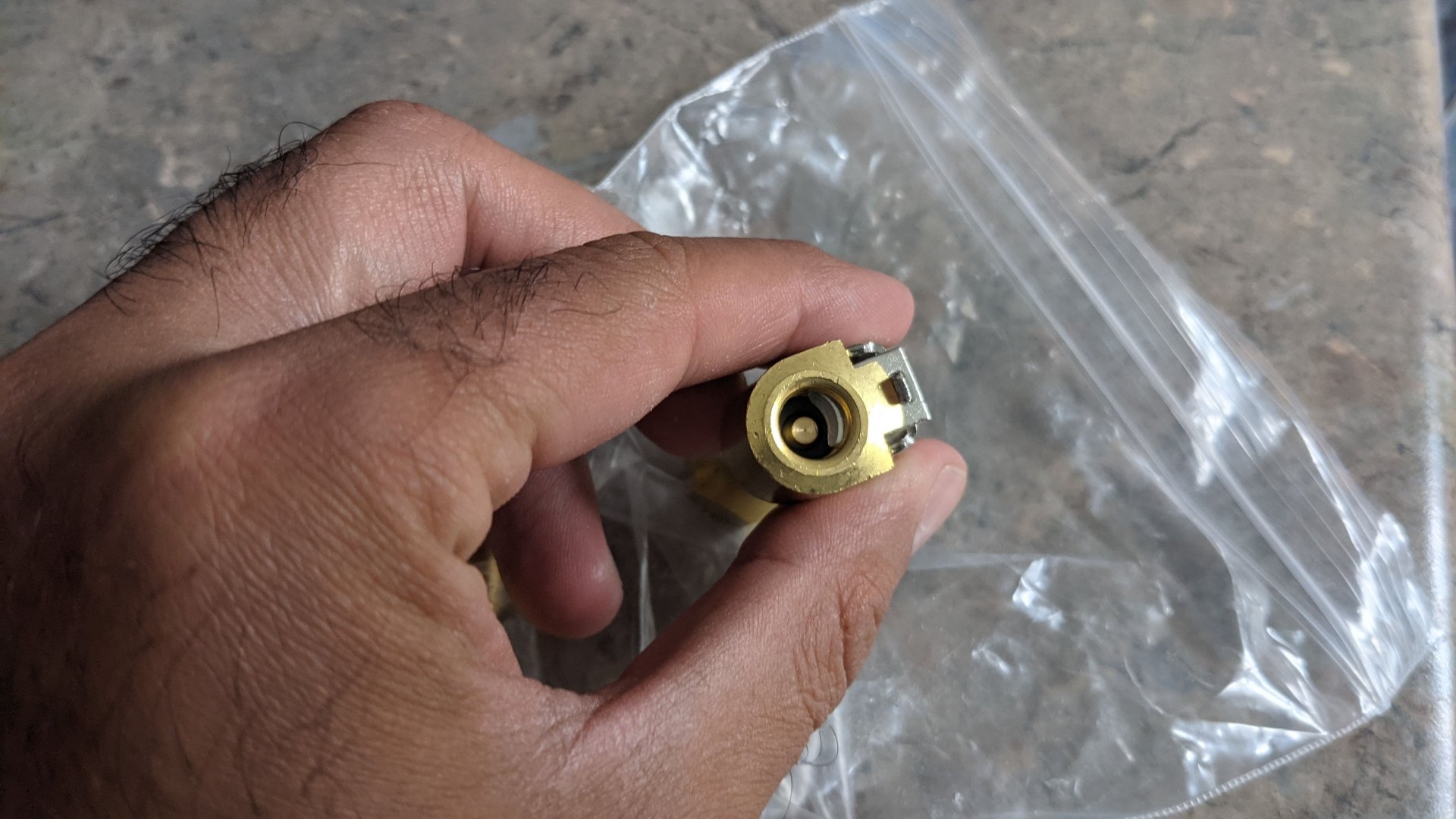

I contacted them and they sent me these below. I have not installed them yet but they should work. I connected one directly and it snapped on and let air out. Since it was going to be a few days until I got these and I need something right away, I bought a bunch of adapters from Amazon and one of them worked but it is an added step. I will PM the info if interested

We've been using the home-built version of this for a while now with good success on three vehicles. The wheel chucks make a difference - @richardlillard1 pointed us to those from NAPA (IIRC it's these: https://www.napaonline.com/en/p/NTH90455 , ours are brass, though). These have two opposing spring-loaded tangs that grip the valve stem, and that provides better grip & seal compared to most others that use only one.
