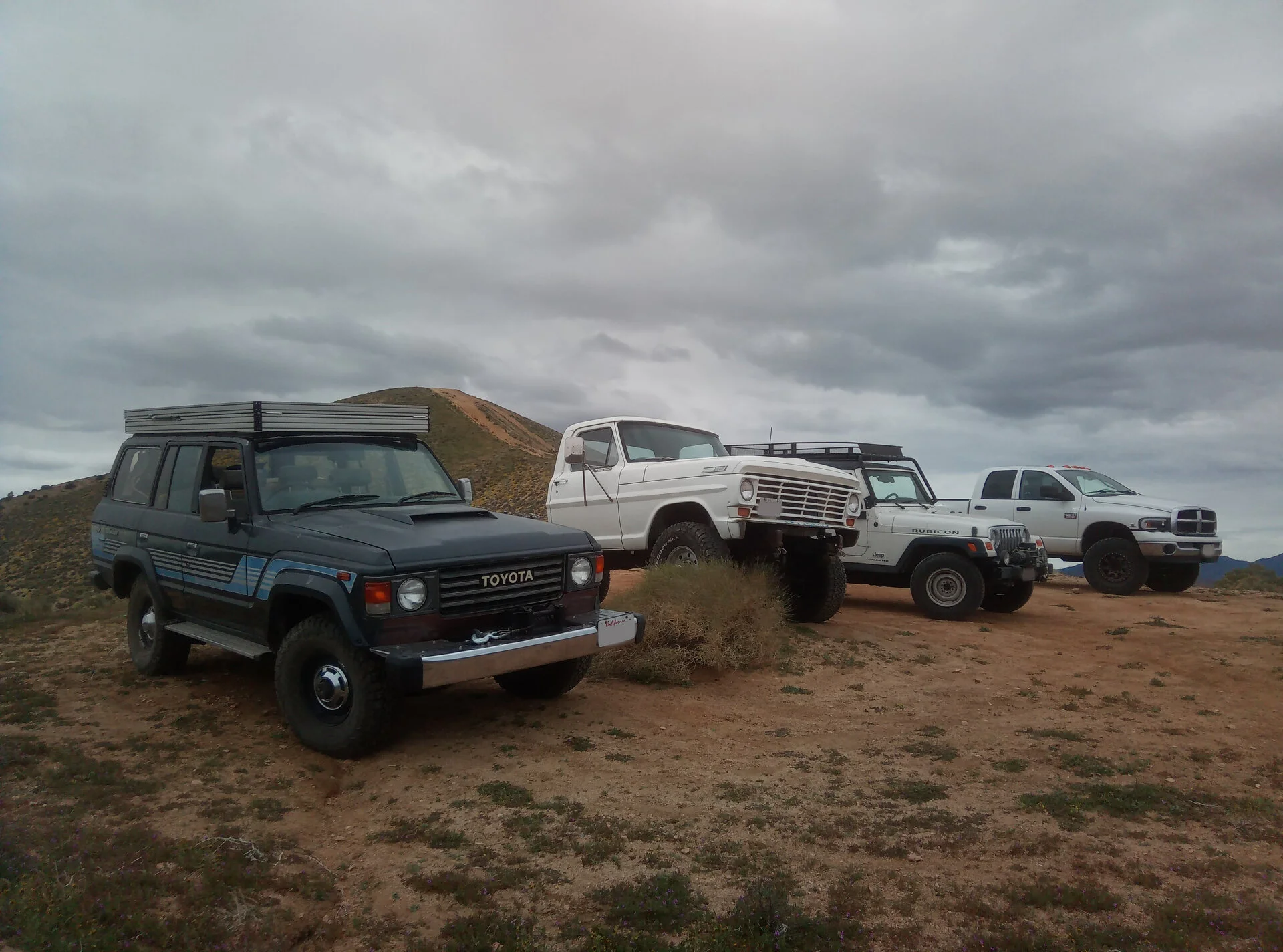

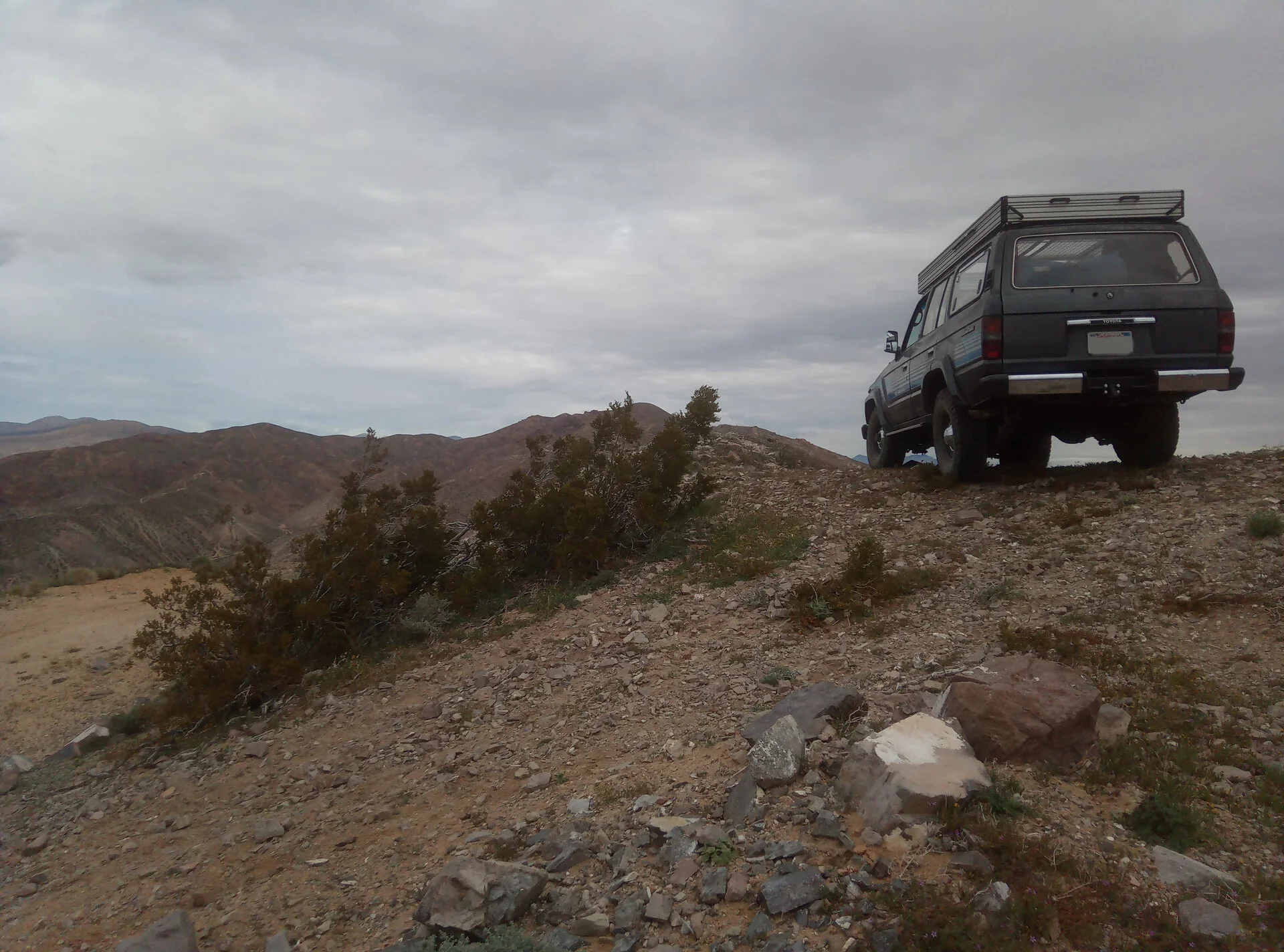

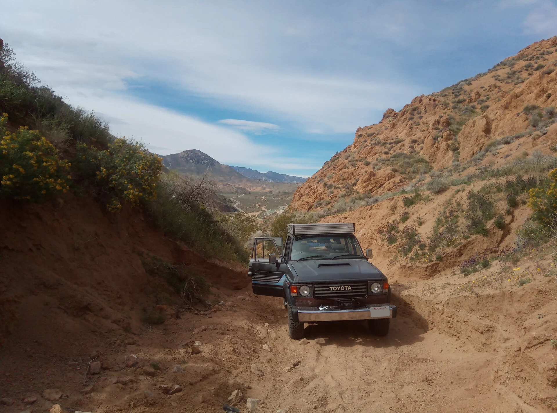

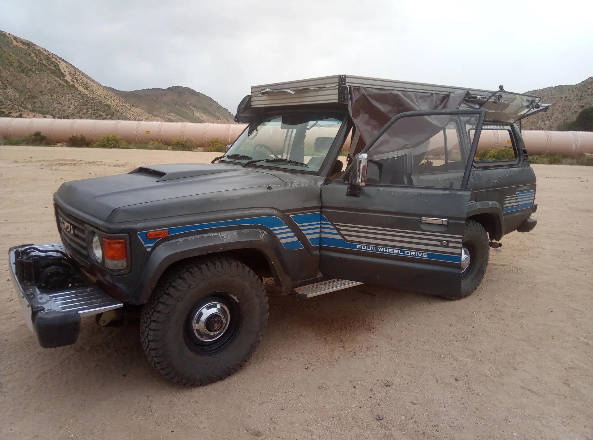

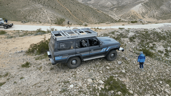

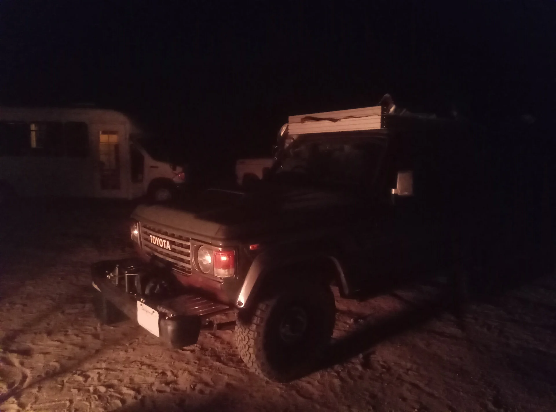

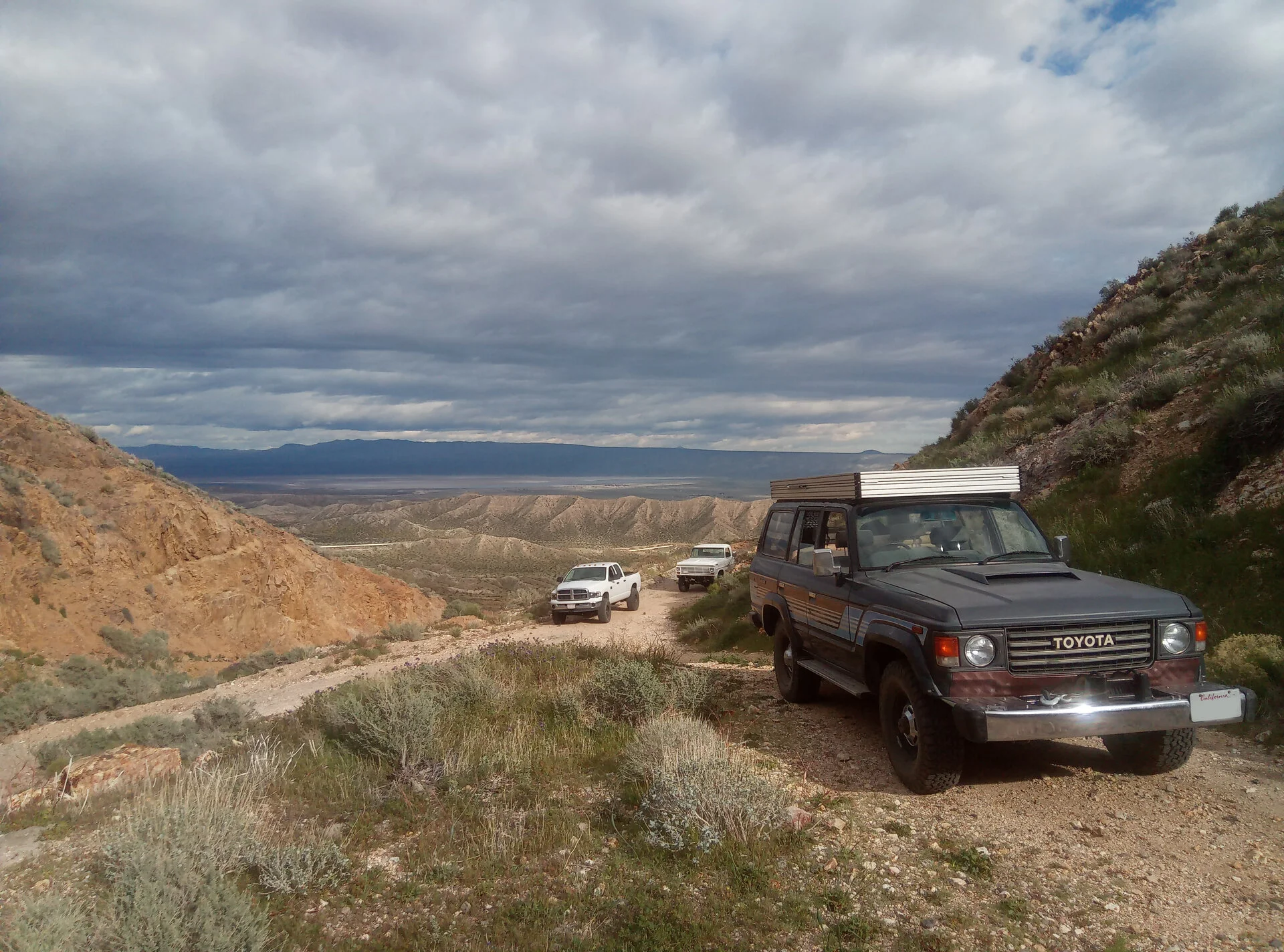

I went on a weekend adventure camping in Jawbone Canyon. I put the cruiser through its paces with numerous hill climbs, washes, and a few rocks and ruts.
We had some light showers on the way up and some sprinkles overnight so I made due with a tarp for a roof while I slept.
Quite the eclectic convoy:

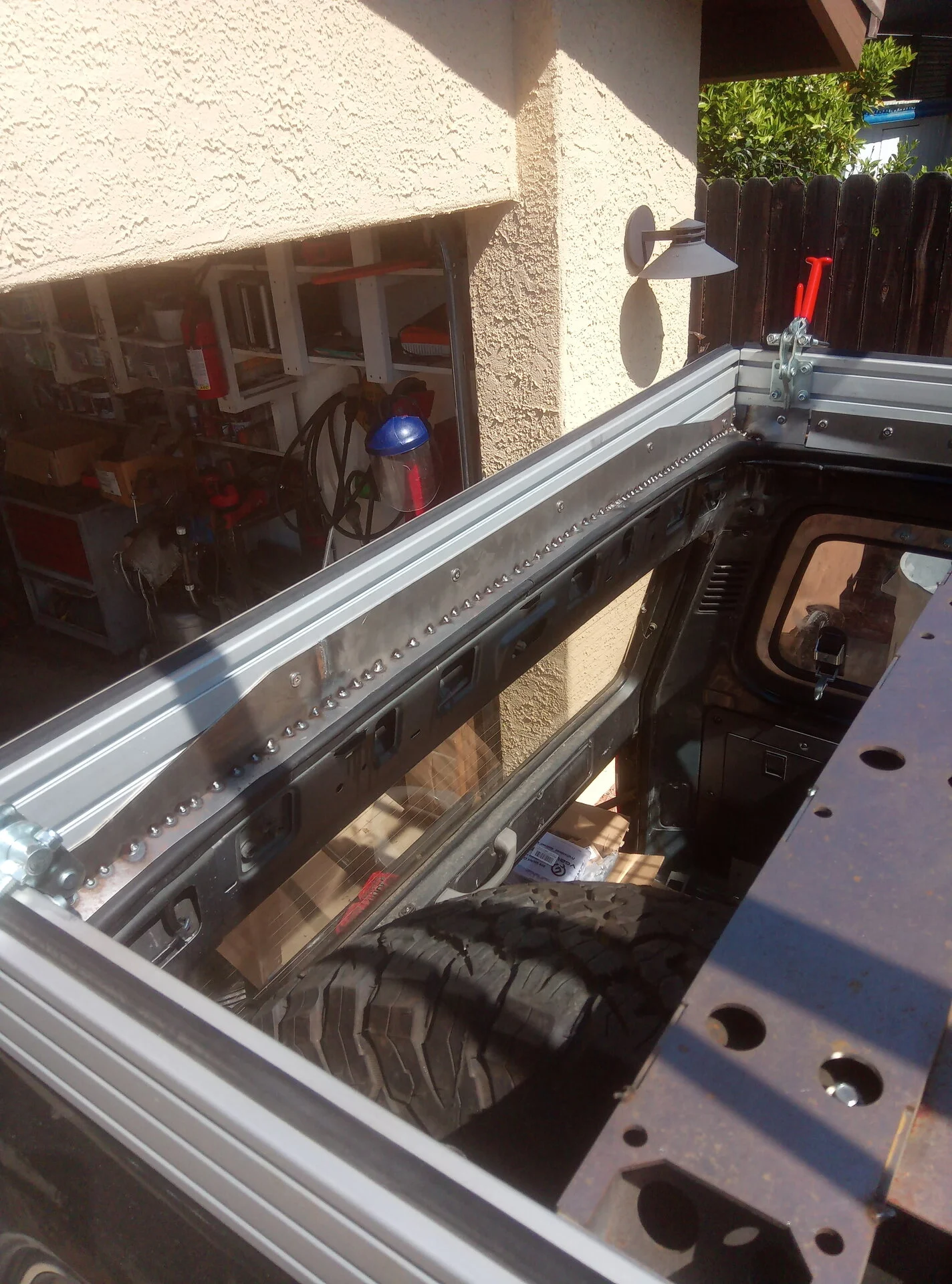

The plan very much evolved over time. When I first bought the cruiser, my initial thought was to repair the highroof, remove and fill in the sunroof, and get a roof rack that could mount a rooftop tent. I also toyed with the idea of a campteq, but the fact that I would need to repair the roof anyway steered me away from that.
As I poked, prodded, and dug into the rust, it became apparent that I would need a complete donor roof to at the very least pull drip rails and patch panels from, if not chop and weld in whole. Oof. If I was going to put the time and money into a new roof, I didn't want the same moisture trapping rust prone mess.
I considered making a fiberglass mold for an extra tall high roof, but i am not a body guy. I do, however, live and breath Solidworks. Much of my design experience is sheet metal panels and brackets for machine tools. I was also aware of aluminum extrusions as they are used frequently for machine and robot cells at my work. Aha! I then found the previously mentioned Tacoma DIY build. The challenge was mating the straight edge of the extrusions to the curvature of the cruiser roof while being bolt on. I had a general design idea, but many of the details have been design as I go, as it often is with prototyping. I didn't write much initially because it was still nebulous.
I wanted it to be easy to assemble and modify, to minimize modifications to the body apart from removal of the drip rails and roof skin, and to fit through a standard 7' garage door. So far so good!
One could take the basic mounting structure idea I designed and make a super duper high roof, a soft top, or even a cabover camper.

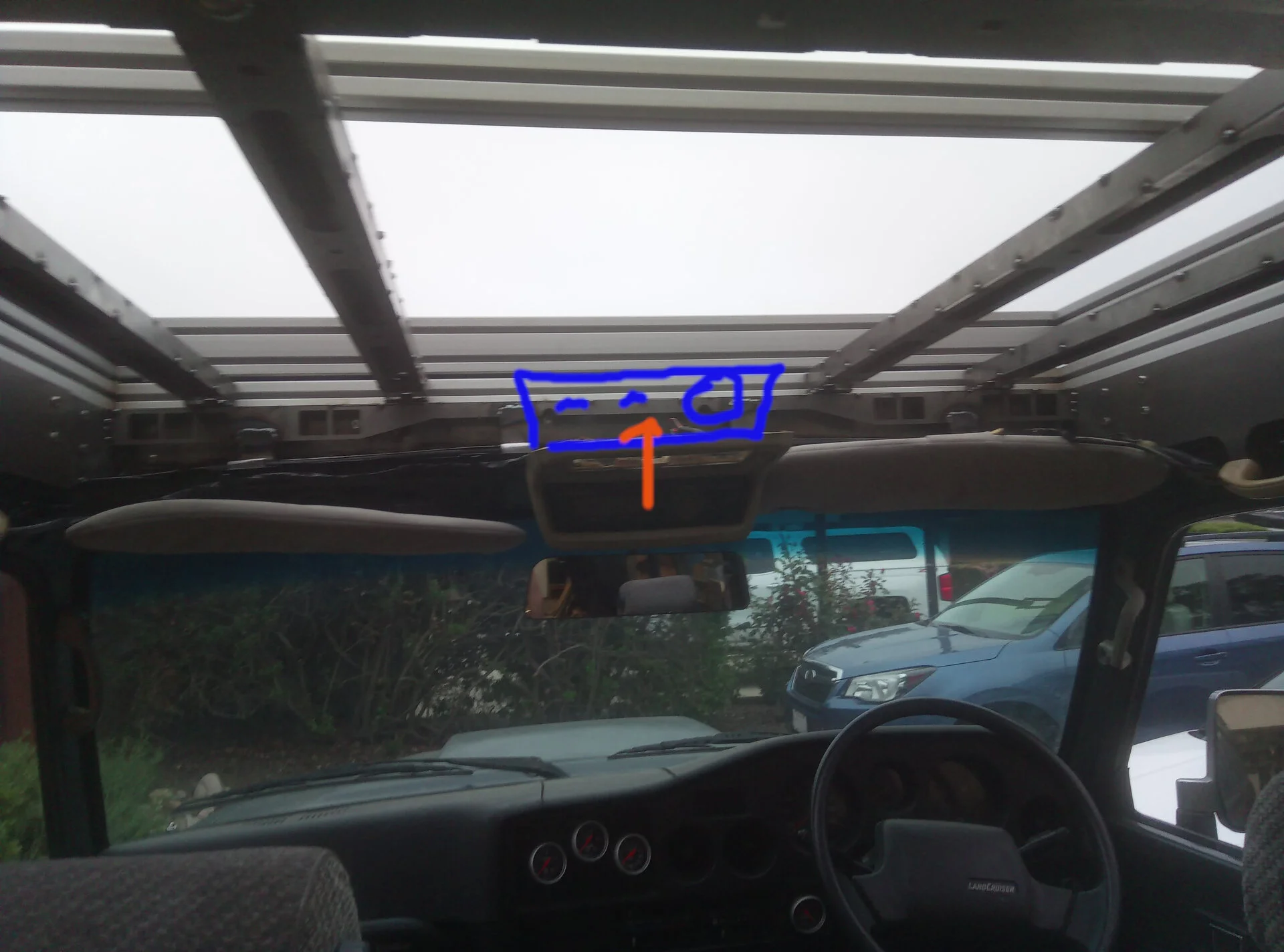

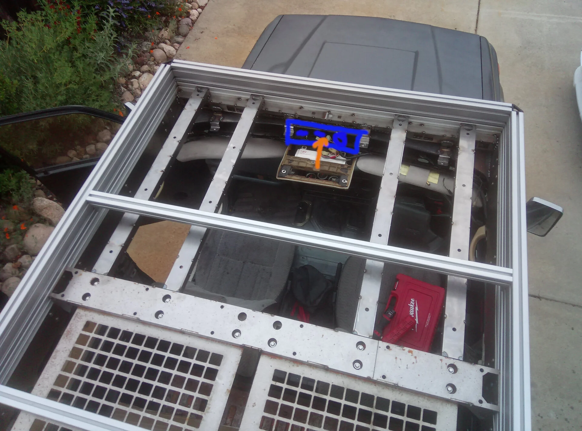

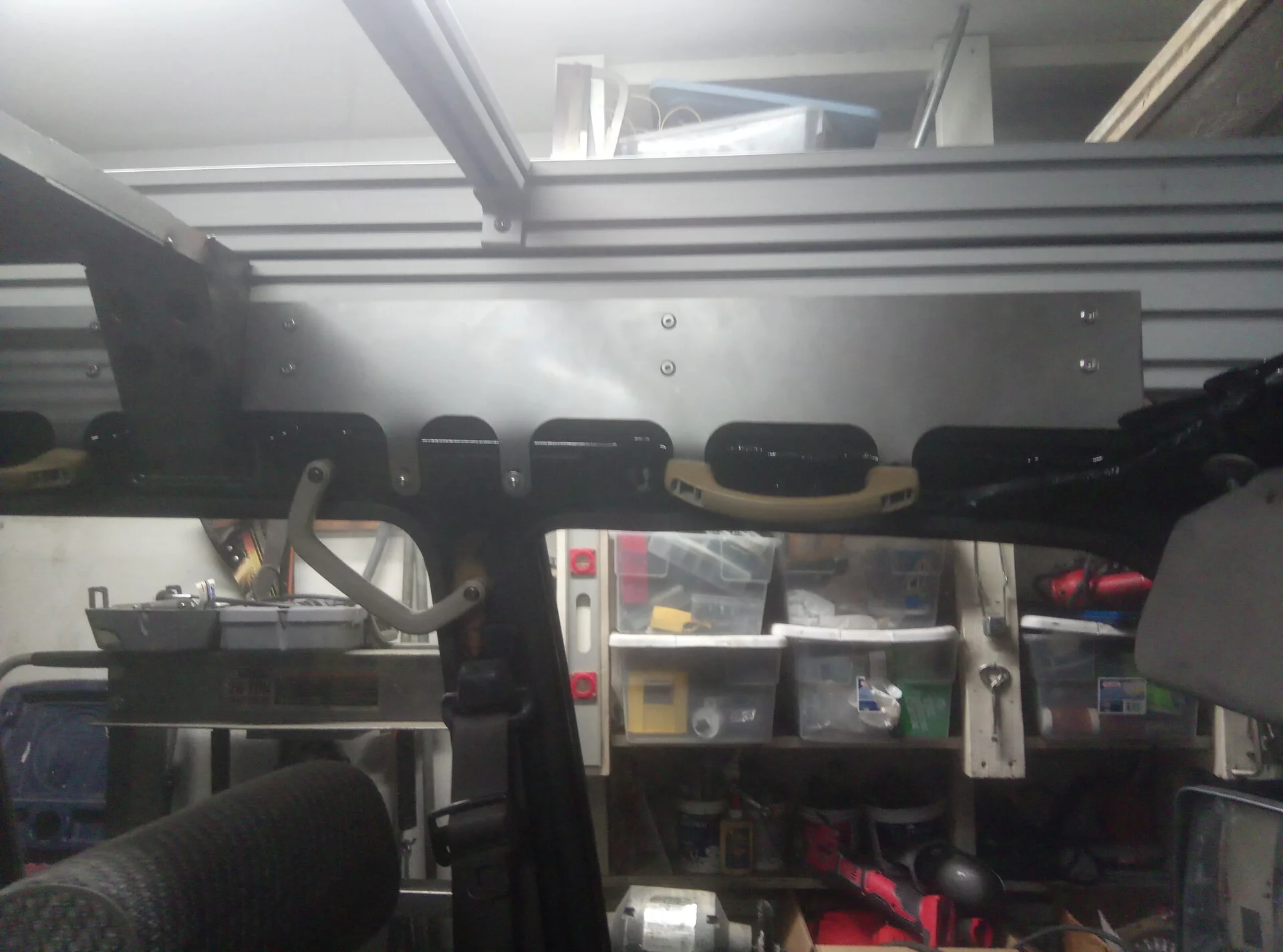

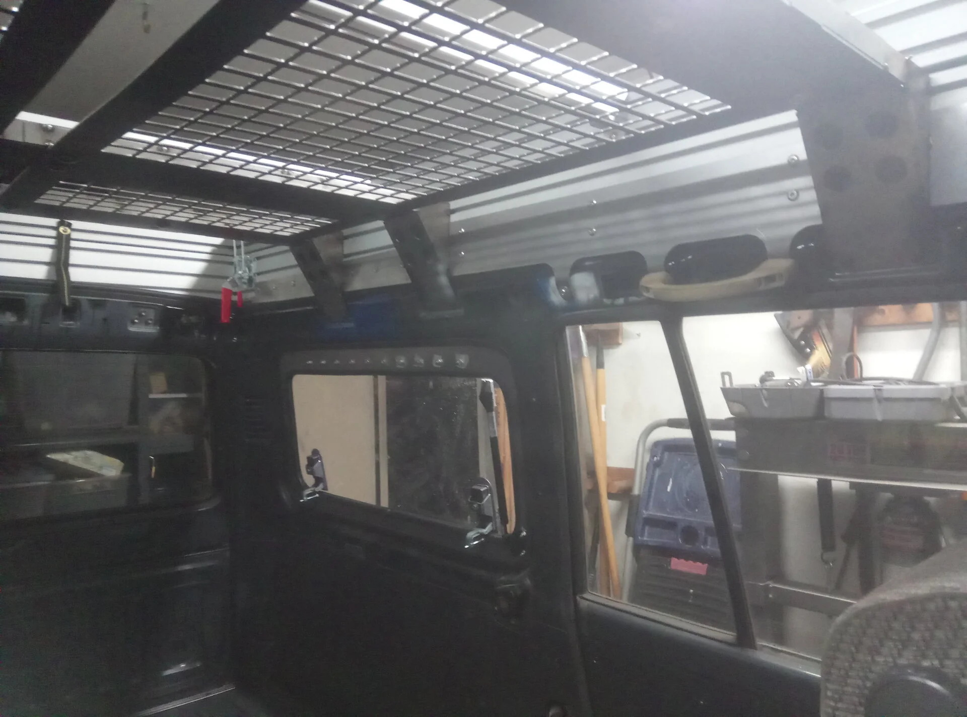

Forward sleeping platform supports tacked together and installed. I'm planning on having a hatch in the middle to crawl up from the front seat onto the platform. It's a bit tight but I'm still trim and somewhat flexible, for now...
The thermometer/altimeter sticks out into the space where the hatch would be, so I will need to make a new box for it to move it out of the way:
