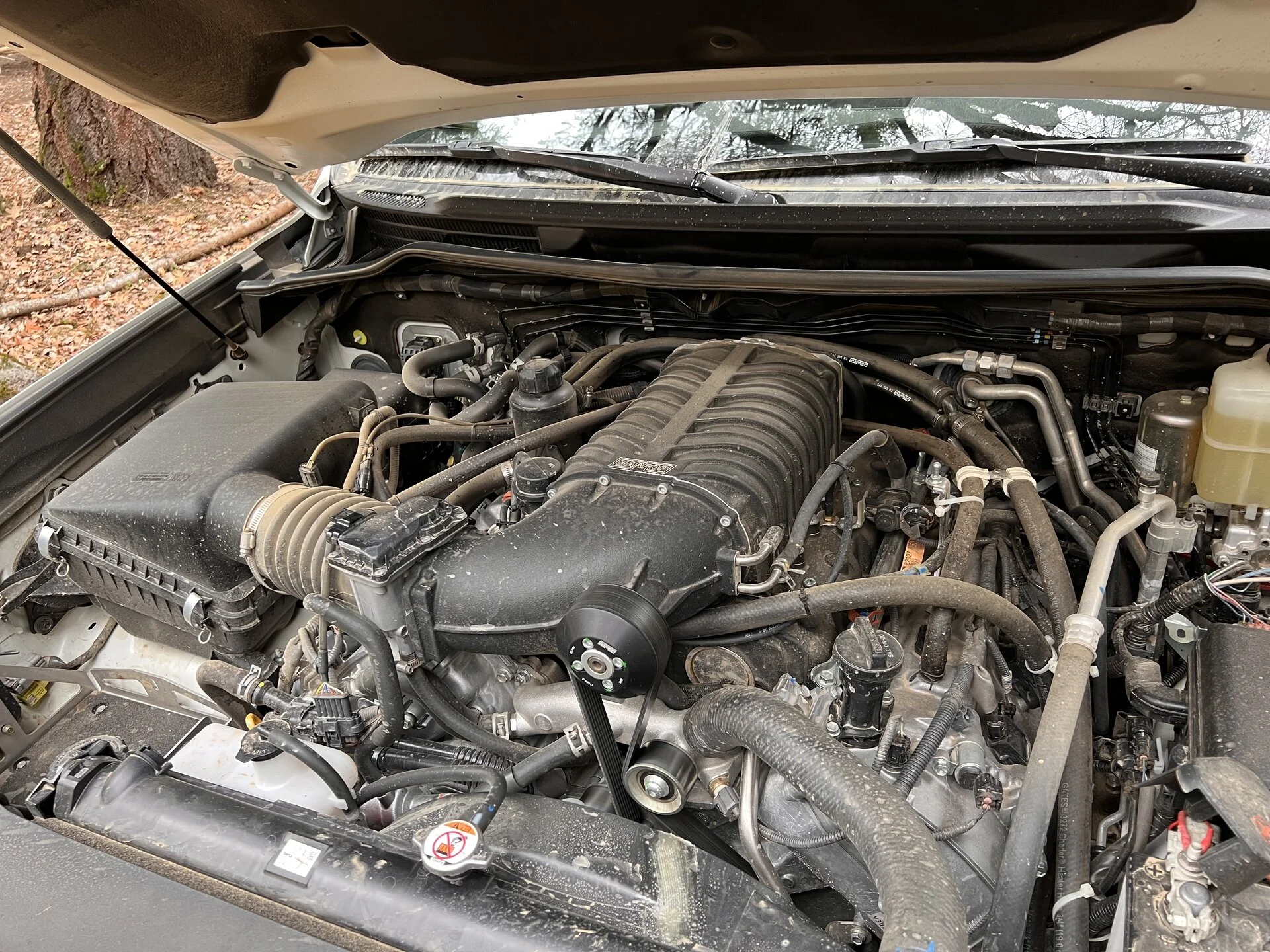

I have installed the Harrop kit in my ‘21 Heritage (and previously a Magnusson in an FJ). Ask away!
Edit- if you are in the SF Bay Area or close by I’m happy to help out!

The only really difficult parts:
- You have to drop the tank to replace the fuel pump. It’s much easier if you run the truck down to where the fuel light comes on (<4 USG). I had two faulty pumps from Harrop so had to drop tank 3 times ffs.
- Lifting the charger into place is a two person job. I did it single handed and cracked my fan shroud with my arse (you can see repair above).
- Loosening the ac compressor bolts (or was it the alternator) through the wheel well.
Other than that, easier than the Magnusson install on the FJ, and better because it uses a single belt setup.
