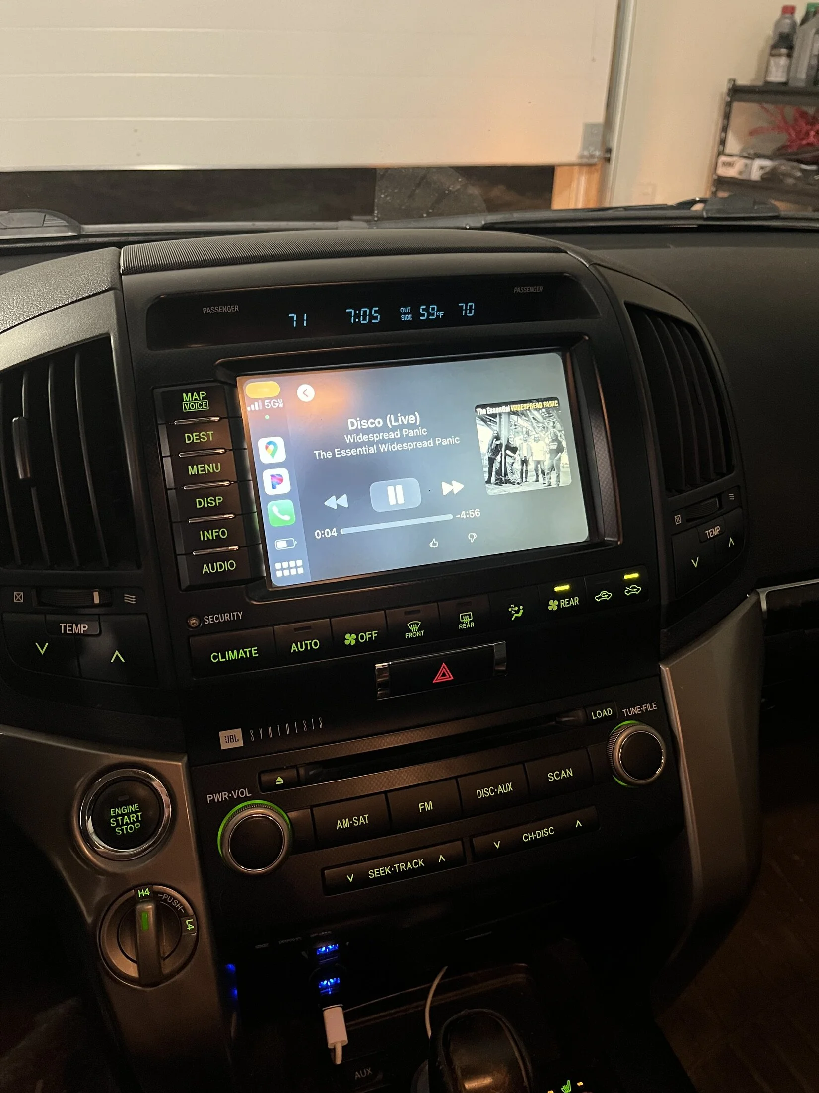

Installed the unit. It’s pretty straightforward. It seems to install like the grom units that I’ve watched videos on. Says made in China. Although the wire harness is really well made.
But for some reason I have no sound while using CarPlay. All other functions with my stock unit work. Climate Controls. Satellite Radio AM/FM all work and play sound. CarPlay pulls up messages, Sirius app, and Waze fine. Just no sound. I’ve disconnected BT from the LC. Switch to A/V on the audio modes. I’ve tried everything. Even going wired vs wireless.
Another gripe. There’s no instructions on switching between CarPlay and stock screen. After trying everything. You hold down the phone hang up button on the steering wheel to go from stock to CarPlay. Drove me crazy trying to get information on that. The link on their website takes you to a generic Lexus video on YouTube, which works nothing like my 14.
I’ve sent an email. I’m going to leave it installed for the time being. Hoping it’s something in the settings somewhere.
Will post an update either way.

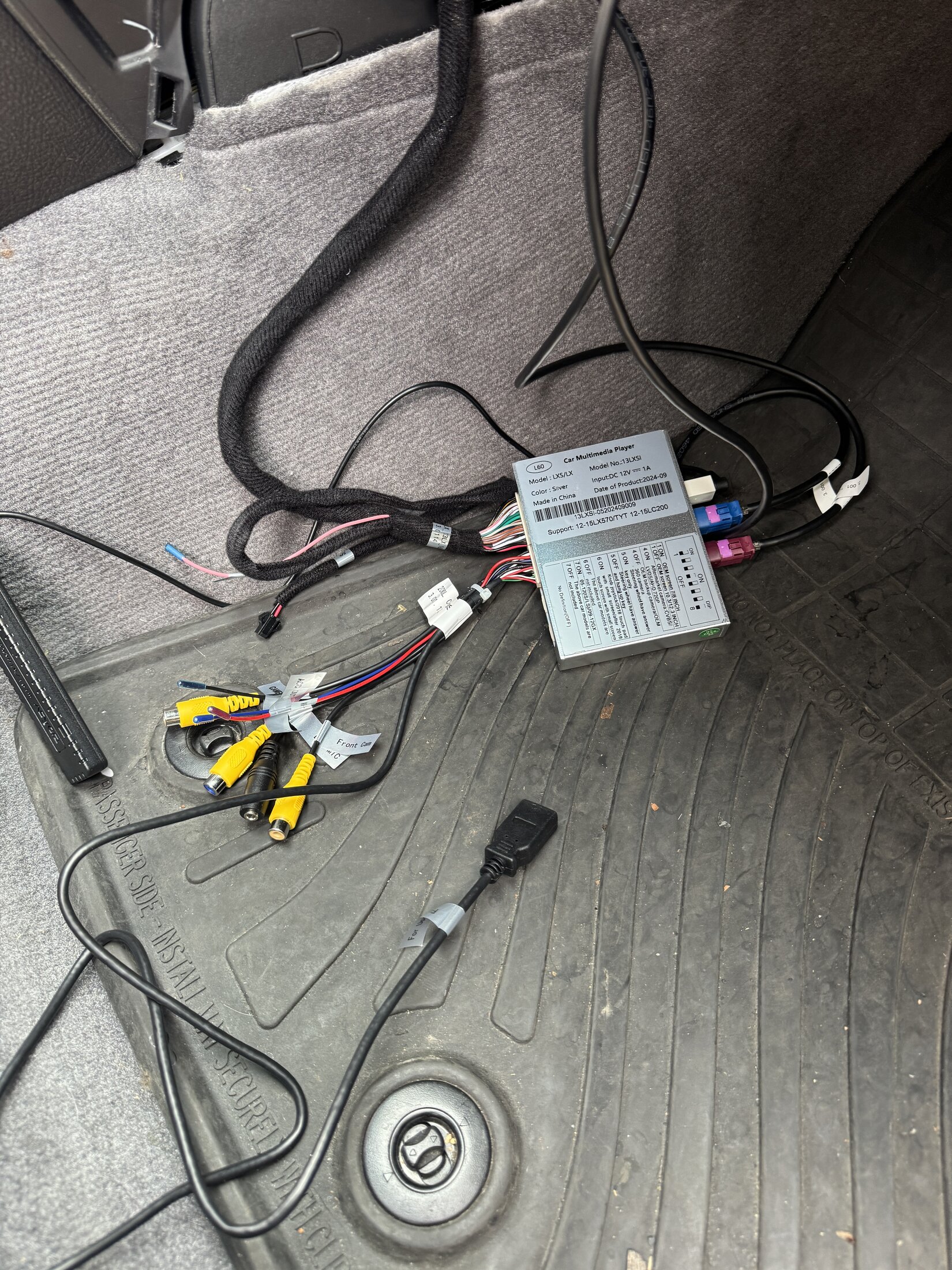

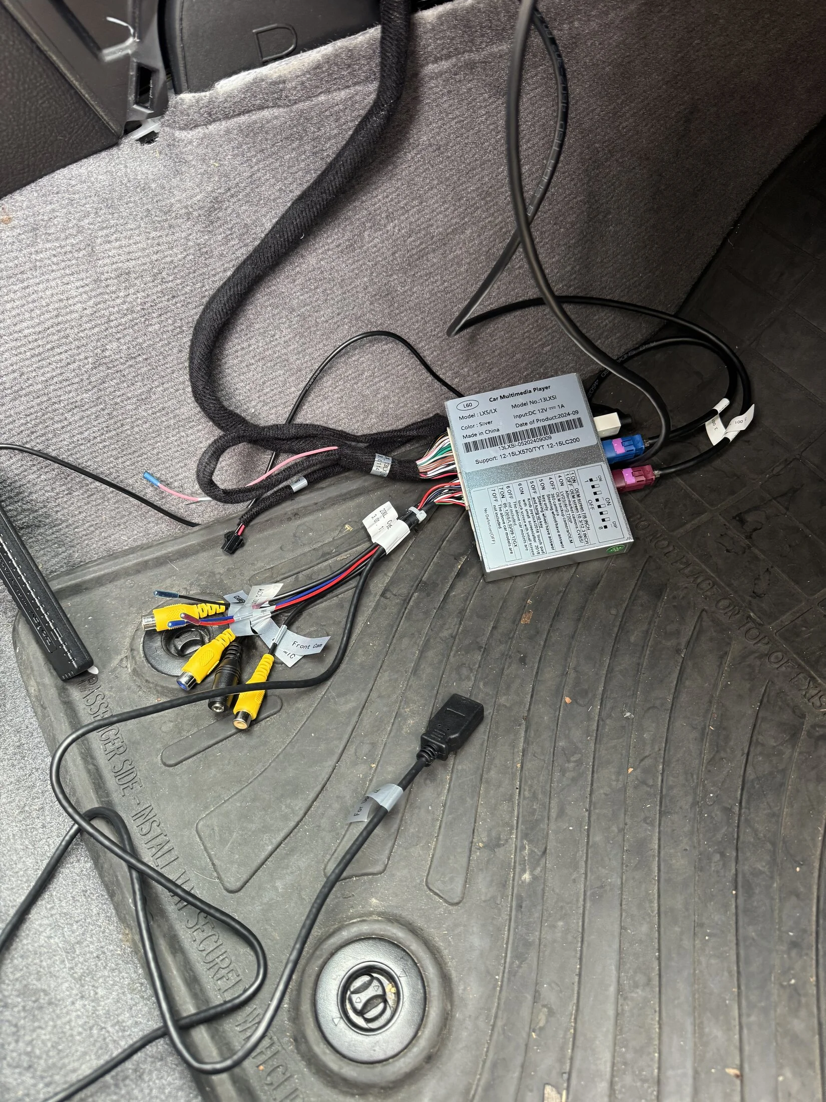

I installed this today but I have an extra part.
Could someone please tell me where this part goes or what it connects to?

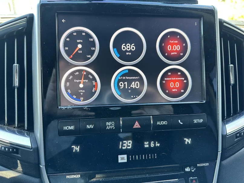

I have not had much luck getting this to work with my SONIM xp8800 phone or with my iPhone 14 pro. Only a few apps show.
HOWEVER I did figure out a work-around which is working great.
I can get into the unit settings and attach the unit wifi to my phone hot-spot.
Then I can down load the apps on to the unit, such a gaia, onx-offroad, music apps, google maps, ARB Fridge, Starlink & the UBCii vehicle code reader.
The apps then show up in the blue apps box and work.
I do have the same problem where the mic doesn't work with the phone apps.
It's like it can't hear the mic. which I use to adding things to my daily calendar.
With phone calls the mic is working.
Now this is NOT like my other vehicles where you just get in and go & everything works.
It takes a few minutes to get everything working then you can go.

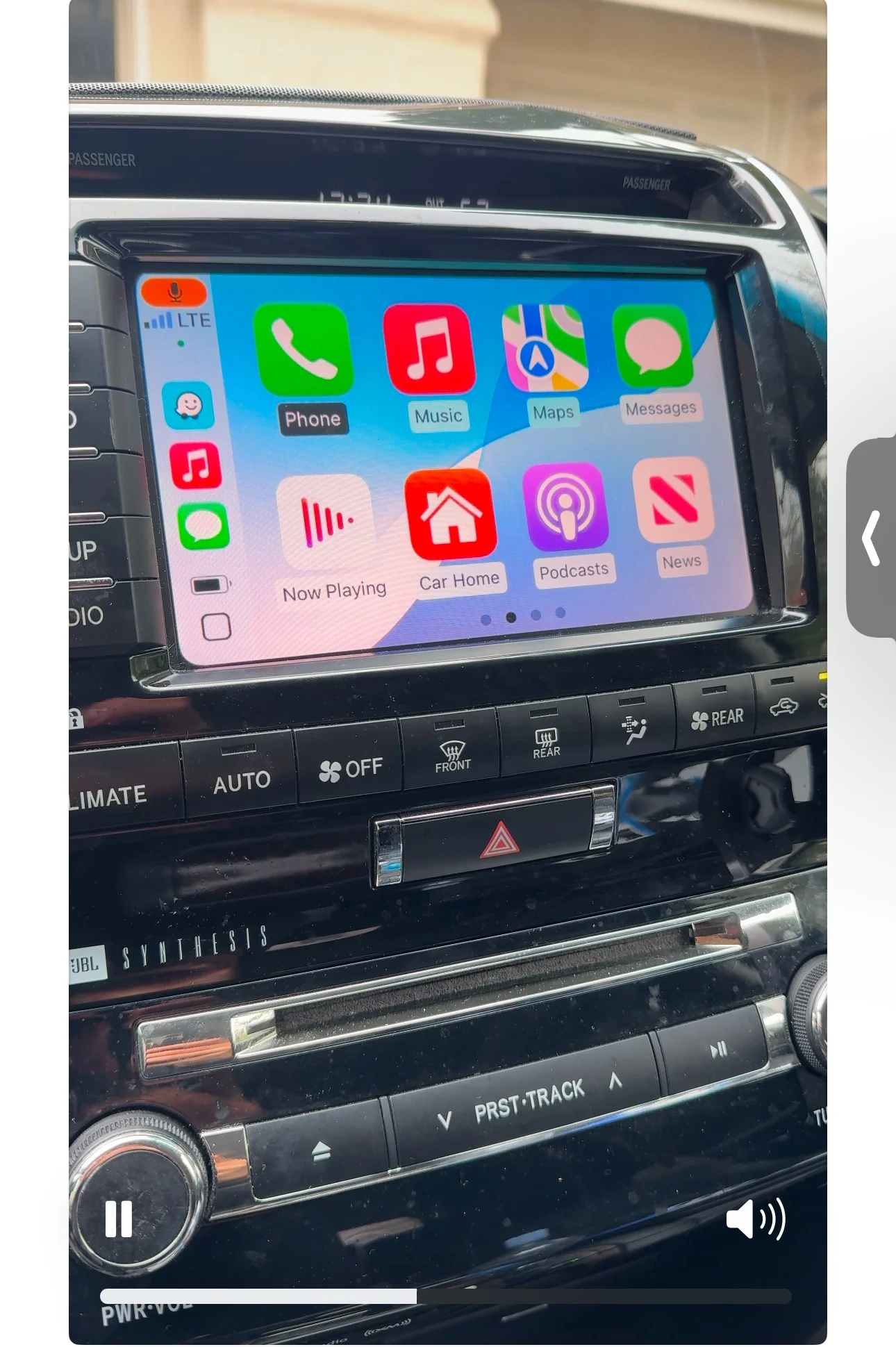

Unfortunately we cannot control which apps will show up on CarPlay. Not every app had a CarPlay version. For example Apple Music, Spotify, Pandora, and Sound Cloud all have CarPlay apps but Netflix does not. Not every iPhone app developer has made a CarPlay version.
You can Google if an app has a CarPlay version if particular apps are super important to you (like Starlink). If you also call our tech support we can check it for you before purchasing. We have full Overview videos of CarPlay in the LC200 (16-21) on our YouTube channel also.
