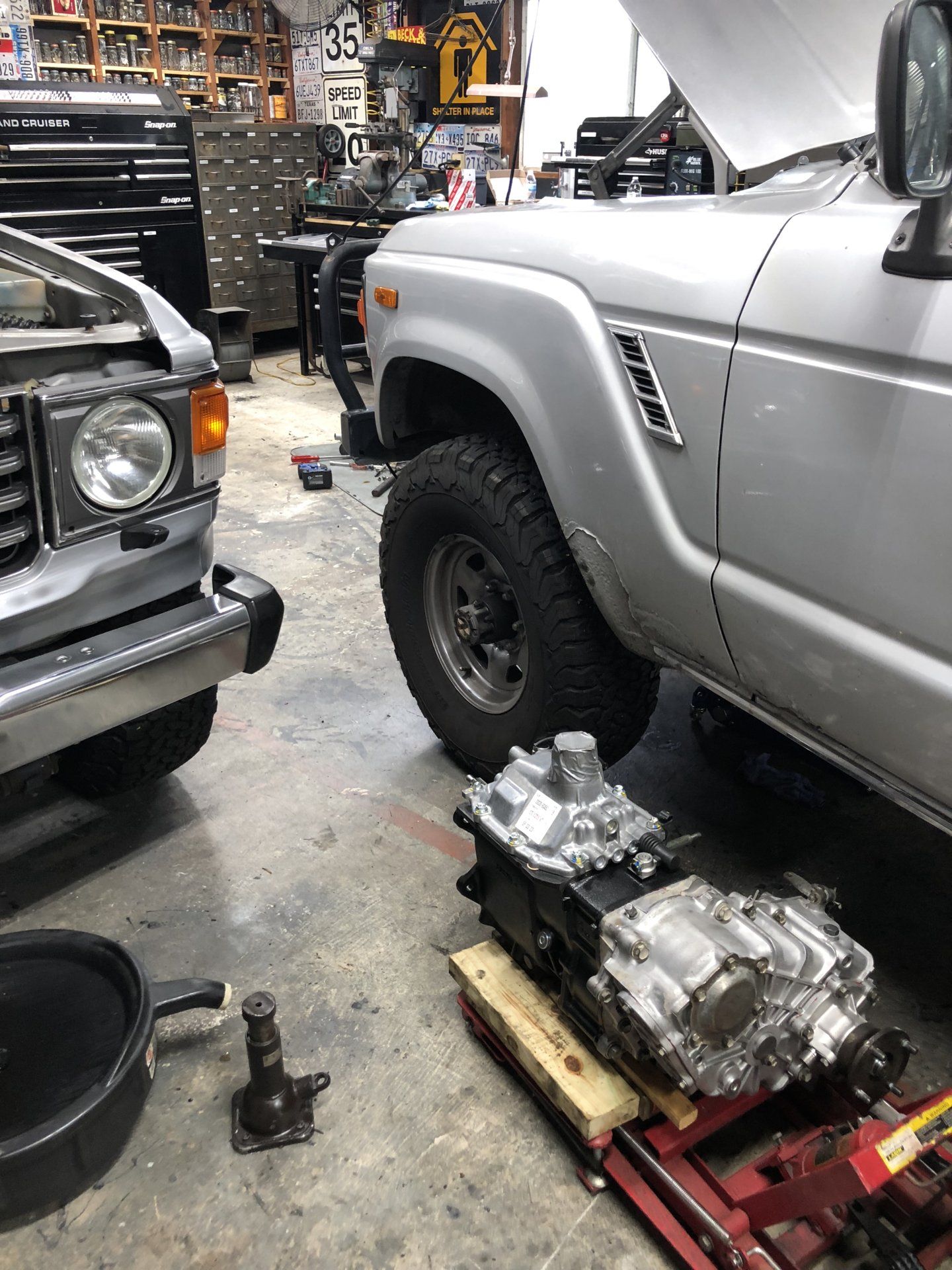

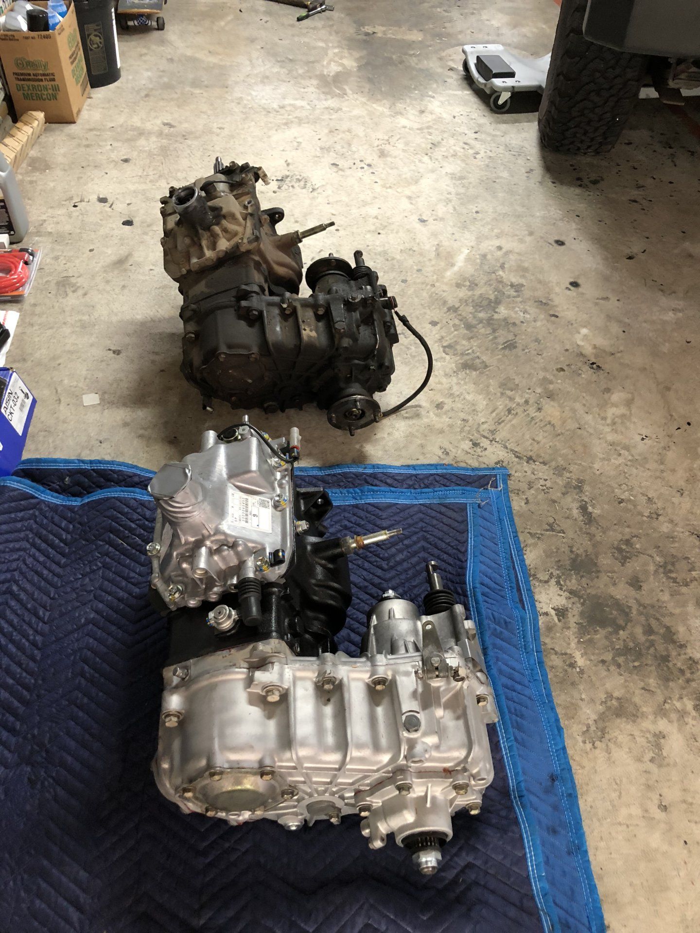

I'll state the obvious: good transmission jack, alignment dowels, and I assume Georg modified the transfer front plate with a plug and 5th gear snap in oiler.
Georg is the man. Been mating H55’s for years. Top quality work.
My swap went well. I’ve almost got 500 miles on it and I’m ready for the first fluid change.
A huge thanks to all that helped!

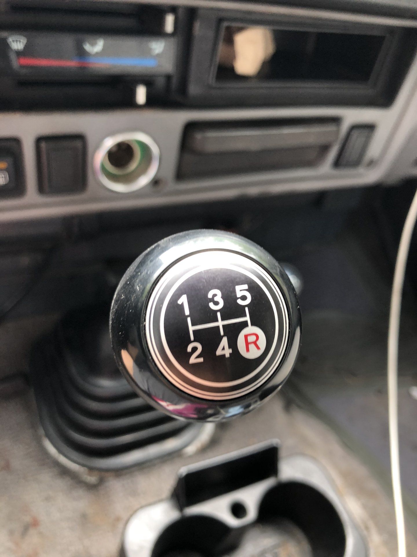

"These are OEM shift knobs fitted with an aftermarket 5 speed cap. "
That aftermarket cap looks fantastic and from what I remember on my BJ42, damn close to exact match.
