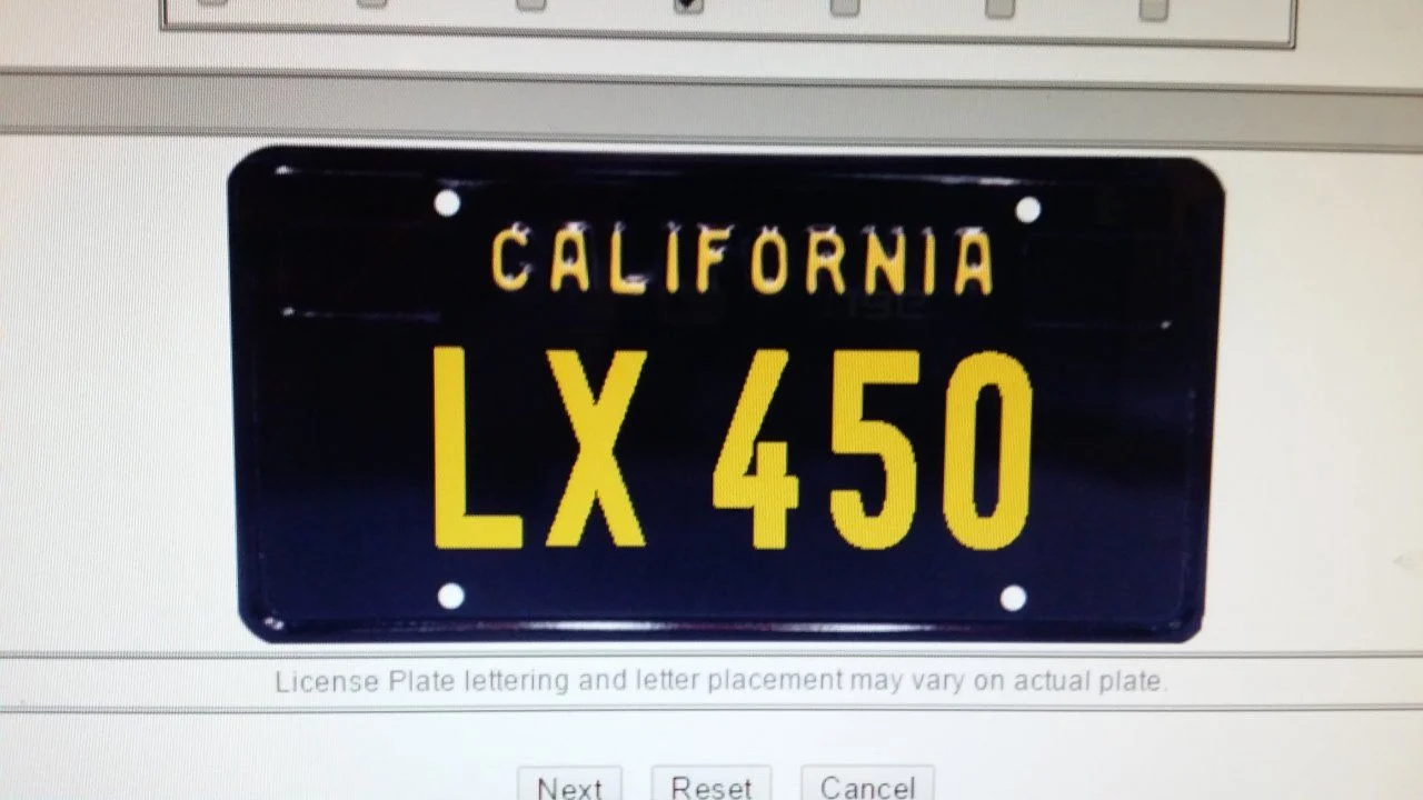

It was just a whim... I typed in LX 450... I could not believe that was available so I went for it. They say 8 to 12 weeks, but what is the reality time frame on how long till it comes in? @jcardona1
Thanks for the input.
Well in my case the wait was almost 2 years. I signed up when I posted this thread Dec'13 Vintage license plates available for any year vehicle!
At that time the program hadn't been kicked off yet. They were taking pre-orders. Whichever designed reached 7500 orders first would go into production. I finally received my plates Sep'15.

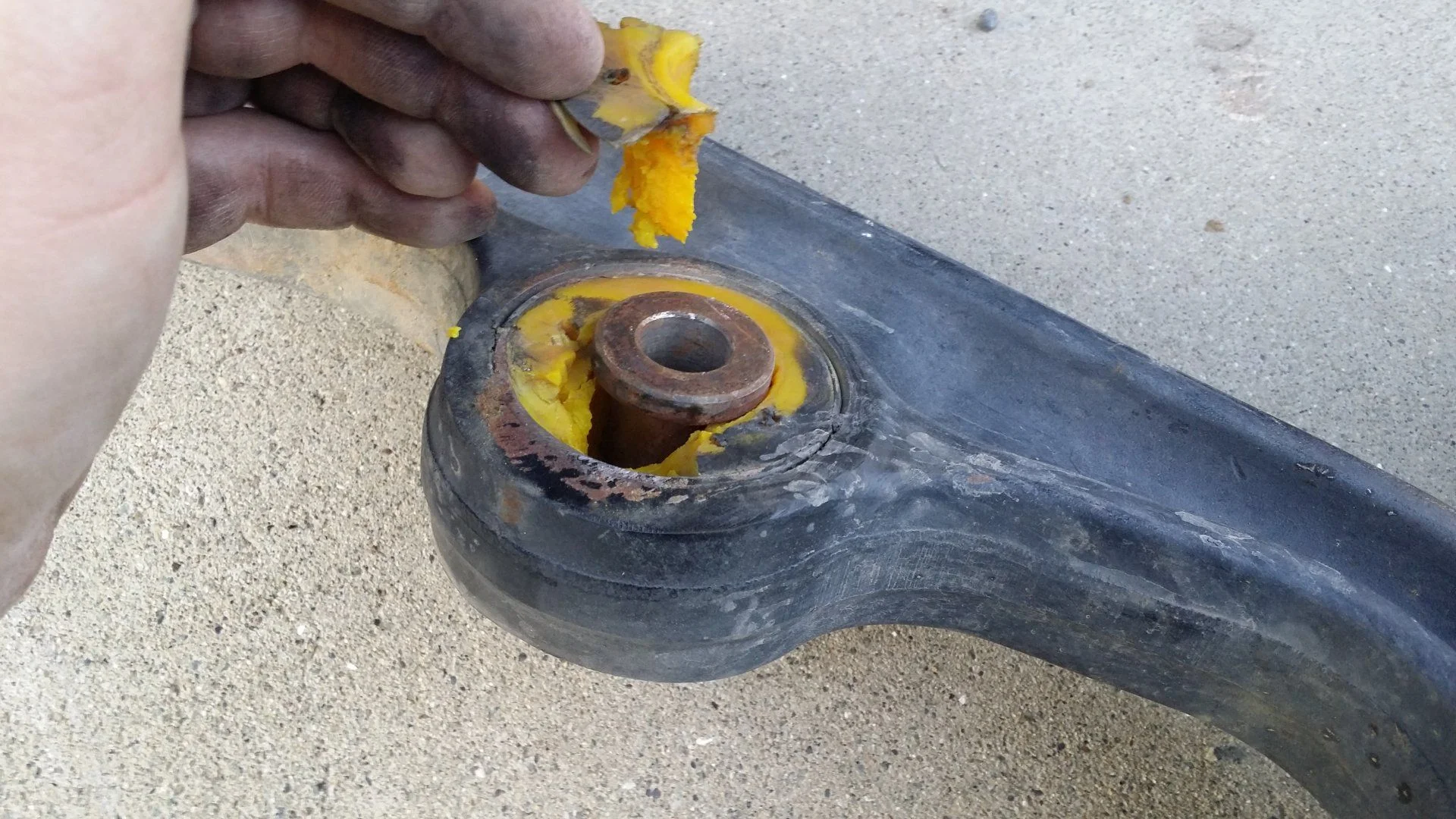

I'm finally getting back into stock bushings.
For free... such a great deal.

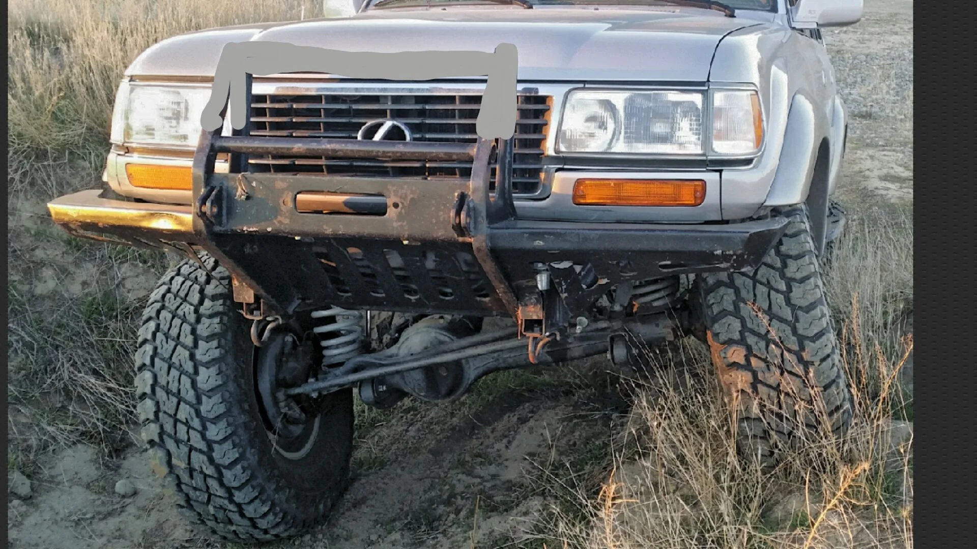

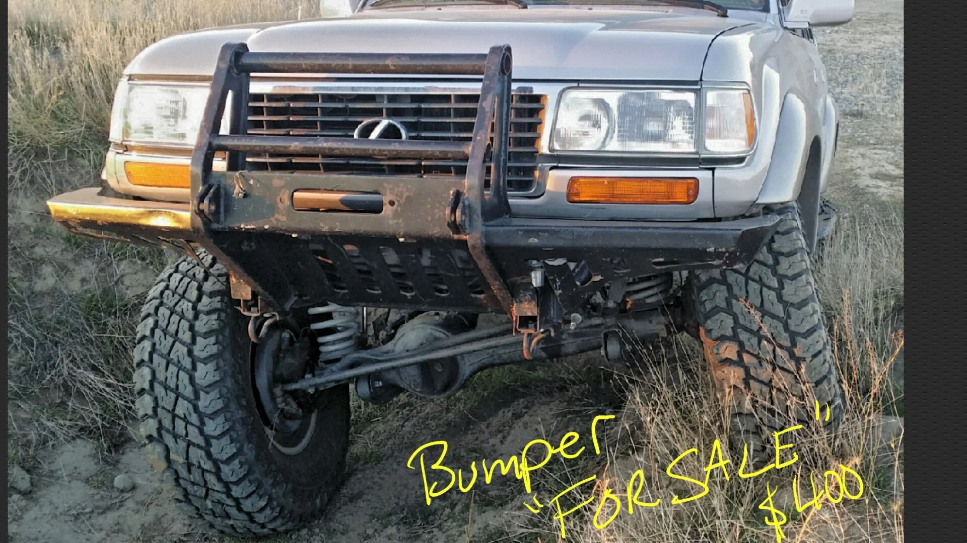

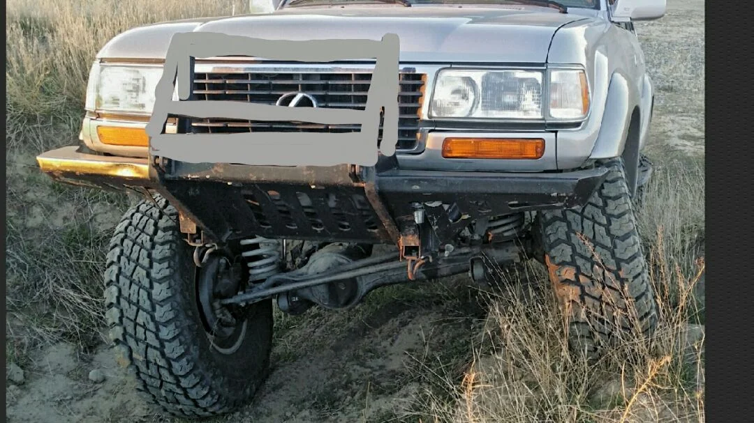

I'm putting up a FOR SALE feeler out there for my front bumper before I decide to start cutting the bull guard off. It's not the look I want for my rig. $400
How much?
