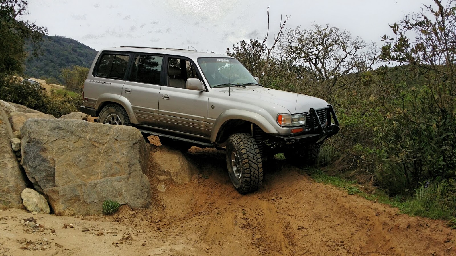

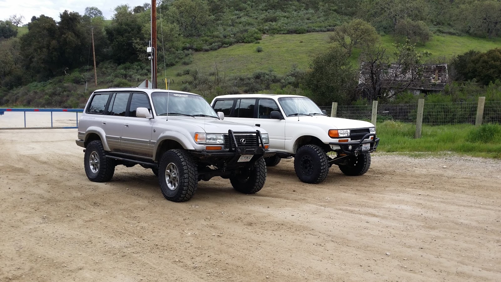

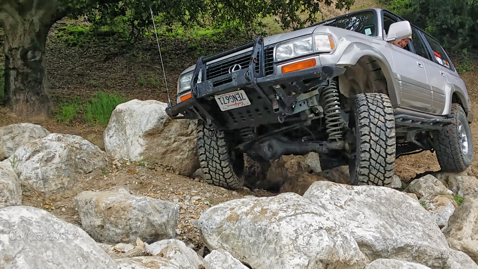

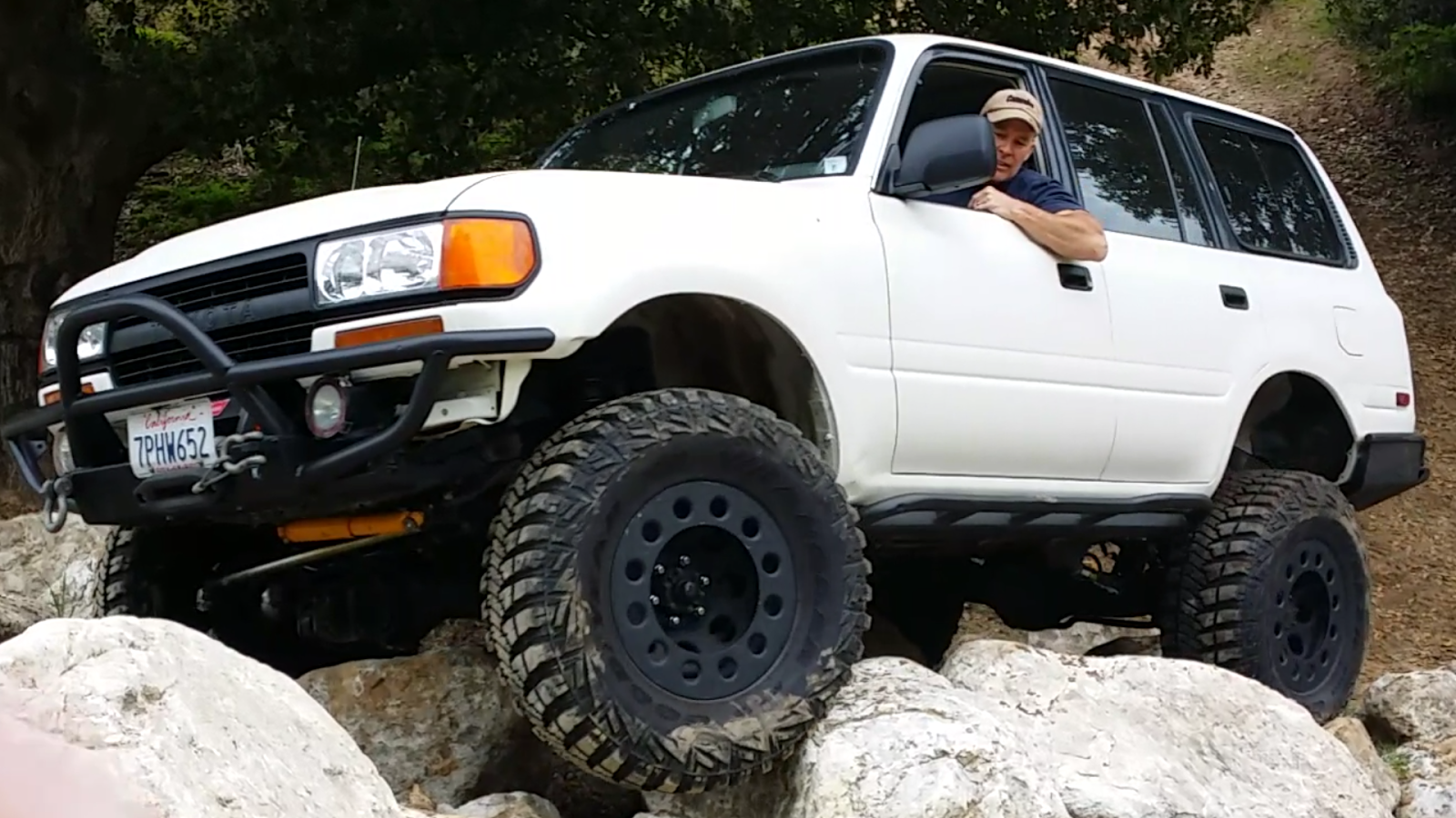

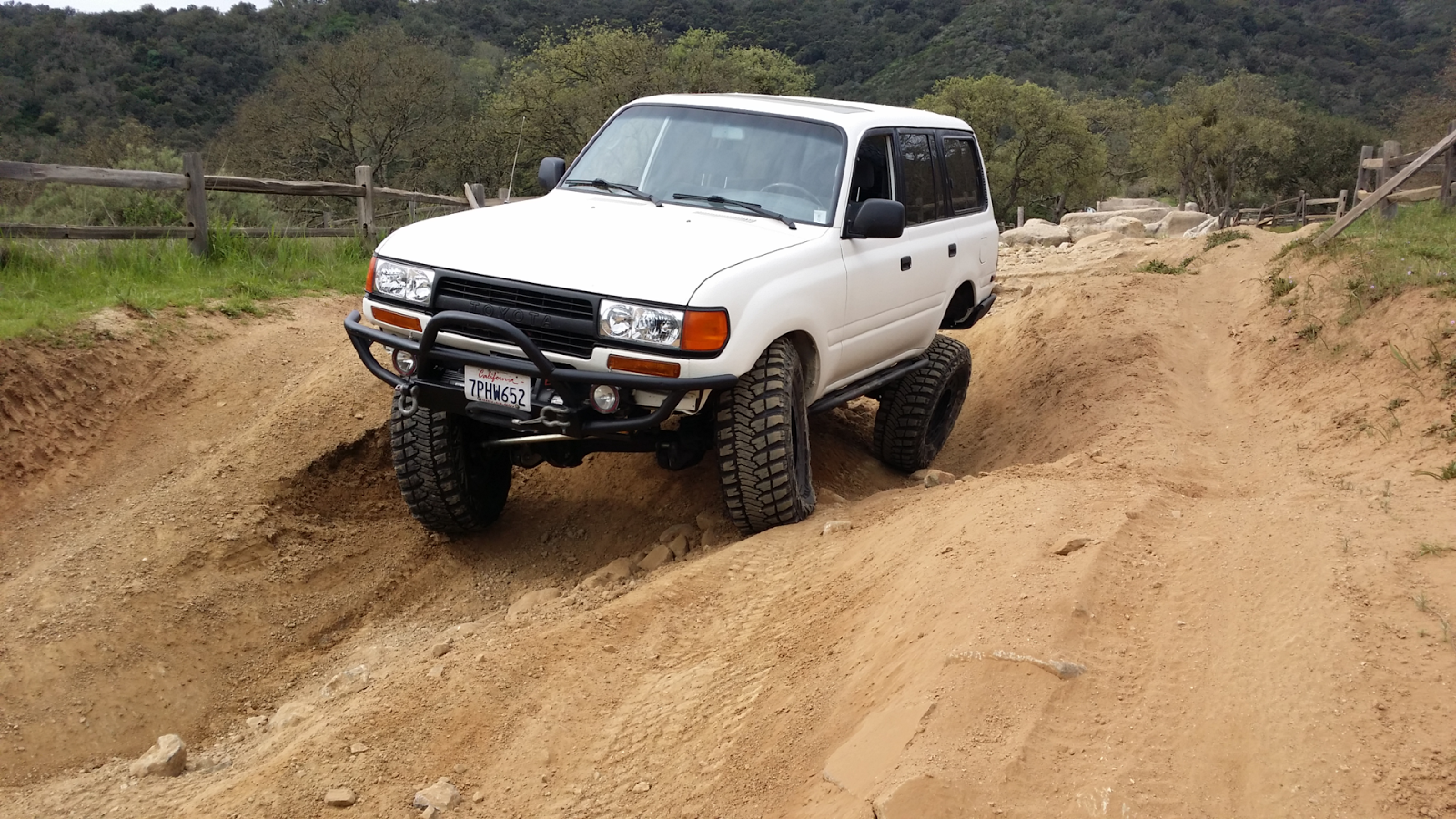

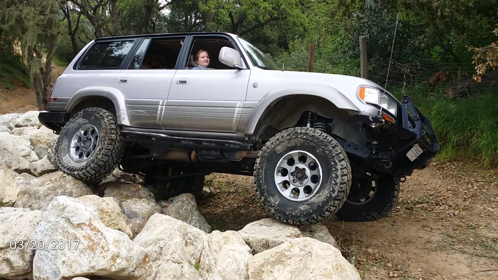

Last few winter trips
This winter we made a couple snow day runs, a couple beach day runs also.... simply my Lx450 has been a wonderful family rig. Here is a few pics at random.
Hollister Hills SVRA Day Run
I convinced a fellow 80 series friend @baldilocks from up North to meet me at the Hollister Hills SVRA Park for a few hours on a Monday. The park was all ours for the short time we were there....... I learned a lot about what these 80 series rigs can & can't do. These rigs are definitely not ROCK DONKEY's, but rather very capable trail rigs. In fact this was a 250 mile round trip to get there & back. I'm very happy I came across this Lx450, it's a great off-road family wagon.
