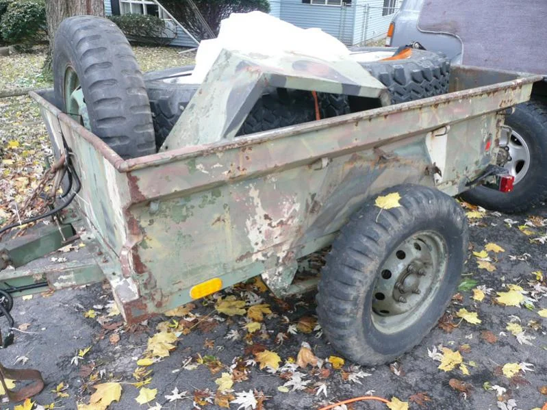

I bought this out of a field in TN. all parts work and roll great. I re-packed the bearrings. and wd40-ed the cable to the brake. other than that its pretty straight. no holes. no deep cancer.
I want to get it prepped and painted before the salt is upon us here in NJ.
i will use this to haul my swampers to the trail with some assorted camping gear from time to time.

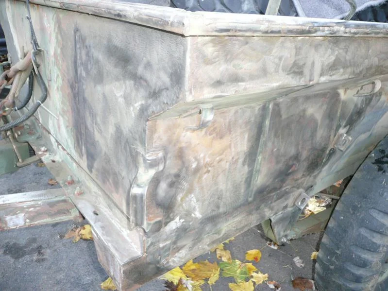

Part 1. I used a wire brush wheel and a craftsman professional grade grinder for 3 hours saturday. It ate the brush wheel so i switched to a grinding stone. it still took a minute to get through the 6 layers of army paint. wow. 180 minutes to be exact.
before and after photos attached. i think I'm 1/10 th of the way there.
question-- can i just knock off the rust areas and flaky paint and use a rust bullet or a rust encapsulating paint? any suggestions? does anyone have any advice. due to my wife observing my "honey lets buy it its only a 400.00 trailer build" i don't think i will be able to pay someone to blast it or have 30 hours to put into the paint of this trailer.
what do you guys suggest? if sand blasting it is not an option. what do you think?
thank you for the advice
