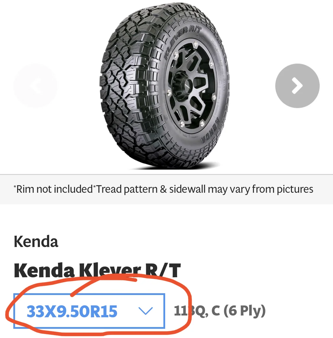

I wish they made the ko2 in a 33x9.5x15 The 10.5 bulges ever so slightly and I can feel a bit of side “squish” because they’re not really suppose to go on the OE rims. I’ve been looking at 16” rims for the future. I think the narrow tire will perform better than what I have now.

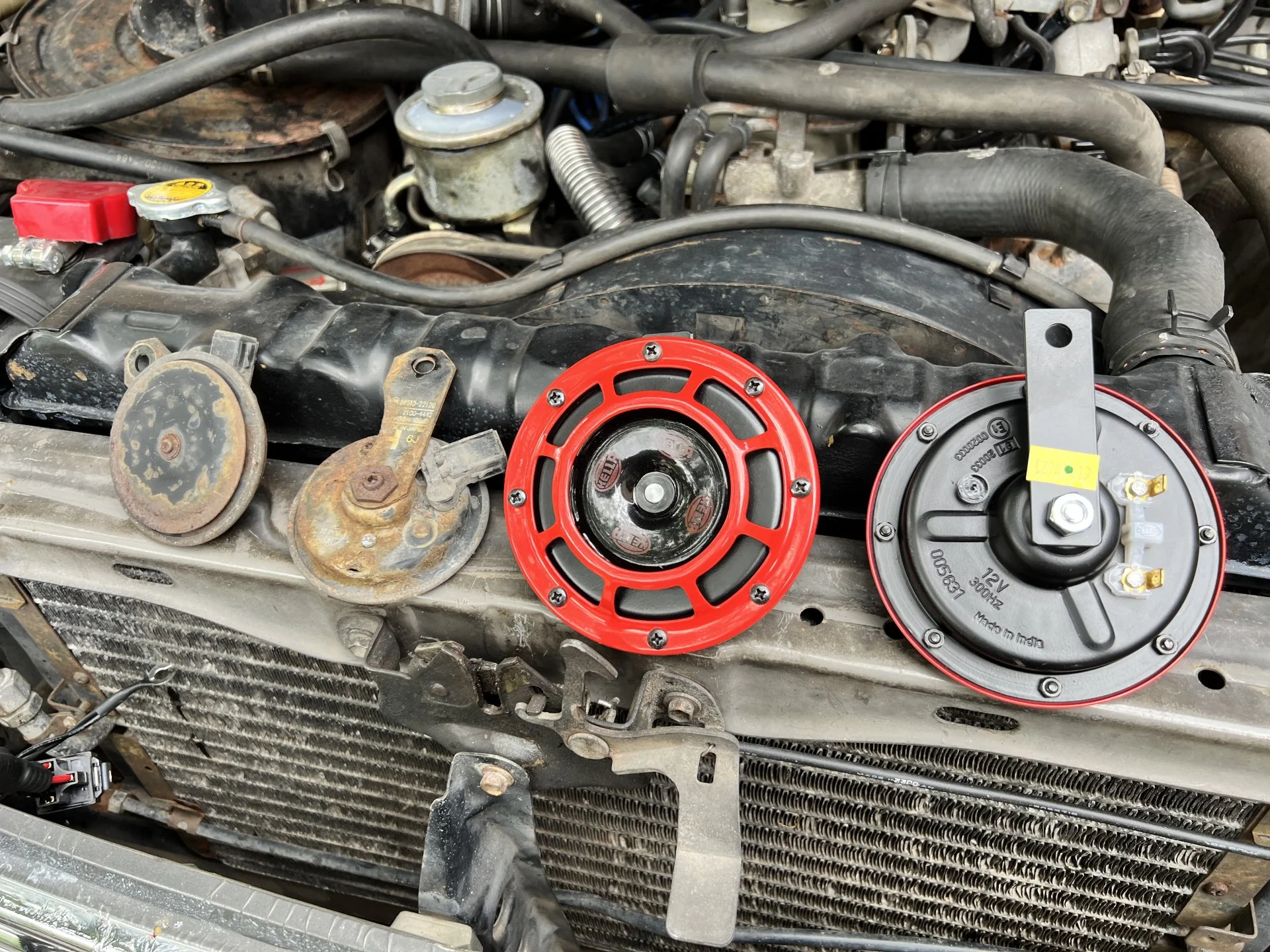

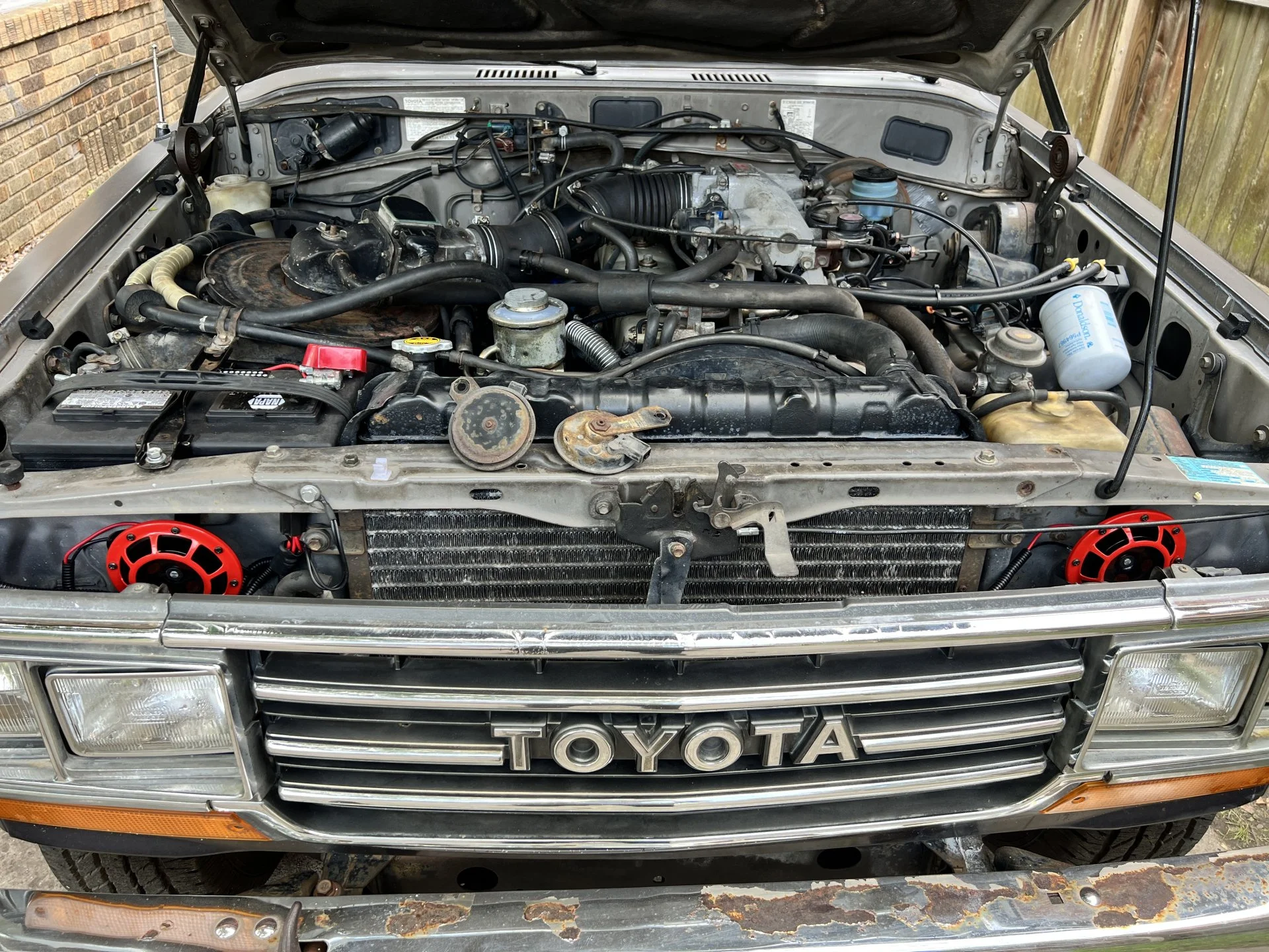

Small victory. Installed Hella horns to replace the originals. Way better. I used a relay harness.
Oh yeaaaah…. These trucks have a horn. Mine has been broken since I bought it. Need to replace the contact pin. But I also need to refresh my whole steering column.

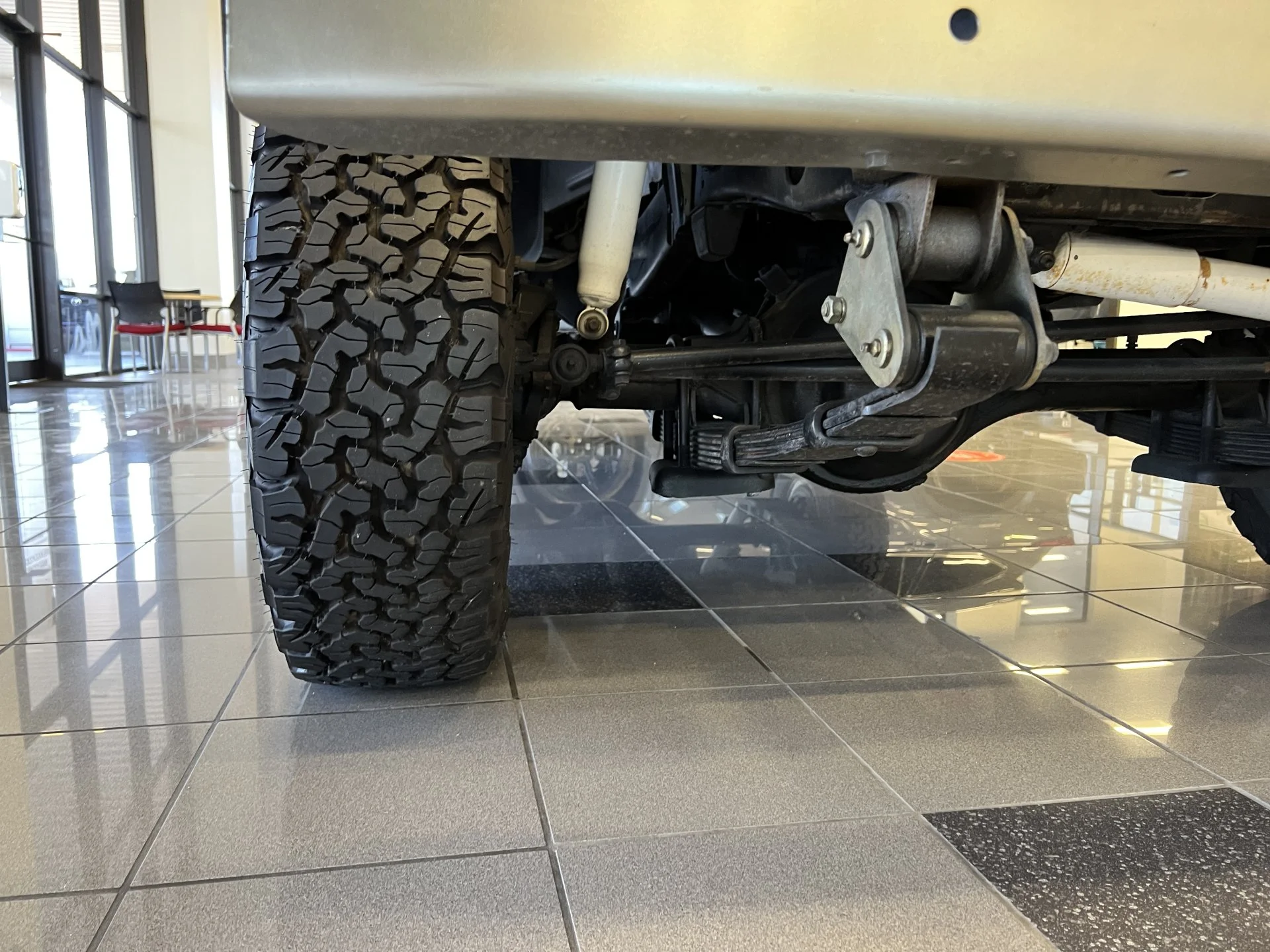

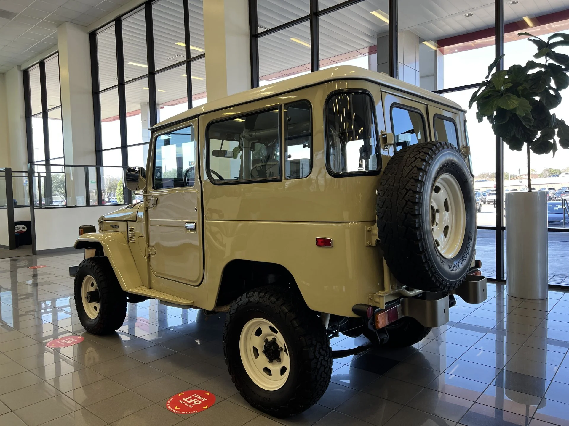

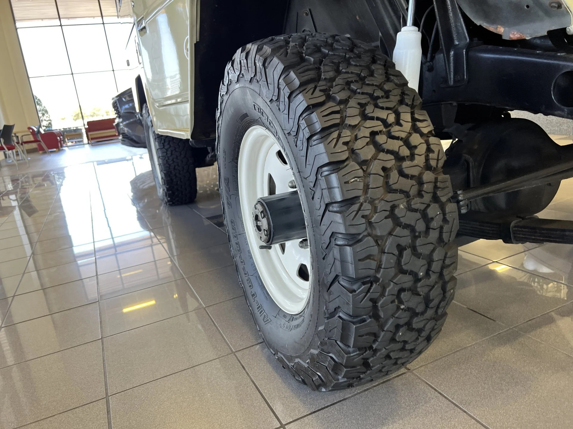

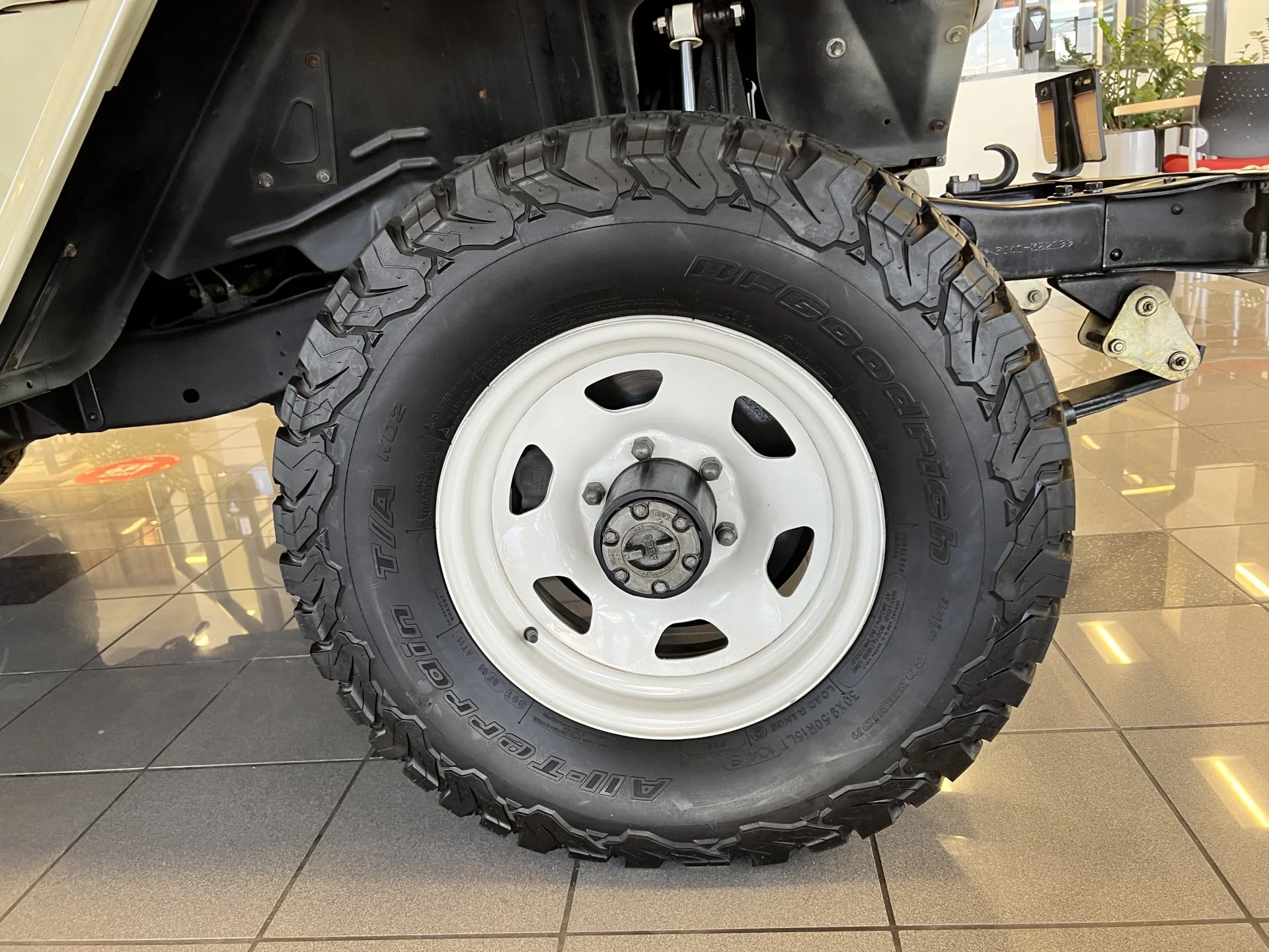

I really think 30x9.5 is the way. I saw it on this 40 at a dealer and it looks clean and not bulged.
That’s what @4Cruisers runs on his 40 and it looks great.
@HemiAlex see below for what we talked about …. Not that you want 33s on the 62, it being a pavement princess and all.

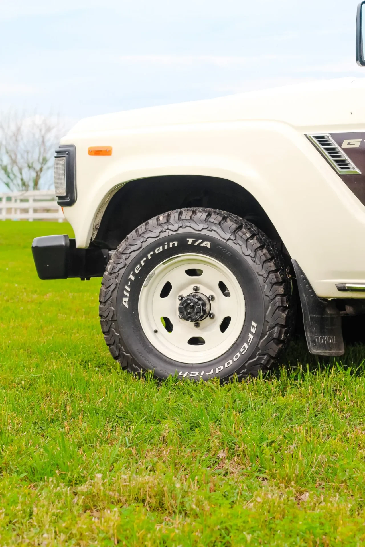

This is at Priority Tire, I’m sure they’re available elsewhere too.
I like that. I’ll likely end up going with those on the 40.
